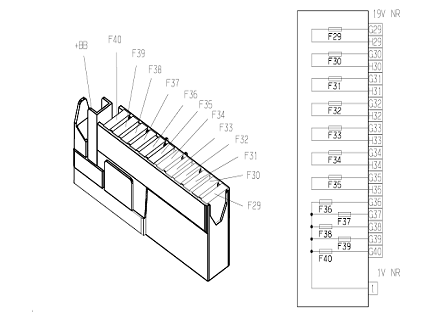

Ok, so first thing is to check out the fuse to the equaliser amplifier. I would check it with a multimeter and not just a visual check as these can burn out at the edges being hard to see.
It is in the passenger compartment fuse box (BH12) and is a 25 Amp fuse, F32 as per the diagram - should be fourth one up.

I'm just putting together a schematic for you...
- Posts: 37639
- x 5786
Re: C6 Radio no sound
So as you can see, the Amp power is via F32 as per my last post and this in turn is supplied my Maxi Fise 3 (MF3) in the engine fuse box.
But MF3 also supplies power to the Cabin Fusebox supply (BH12) - as we know, the front RH heated seat, the radio amplifier (F32), the Hydraulic Suspension ECU and the AM6 automatic gearbox. So if there was a problem with the supply, it would also affect these other systems.
So if you have no sound via the Head unit volume button and no sound via the audio remote on the steering wheel, then either the amp is faulty or the Head Unit - so you really need to get Lexia on it and do some tests / fault code readings.
8480 is the RT3 Head Unit
8408 is the Equaliser Amplifier
