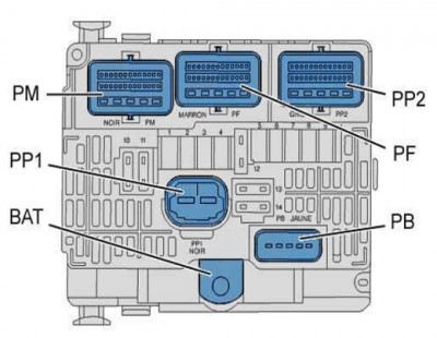

Ok, so the fault you have F993 is Front lights shutter control fault: Not characterised
This is basically the message relayed from the engine fuse box. It is saying there is a fault in the front Xenon lights that controls the shutters - The shutter inside the Xenon projector lens raises or lowers to allow the full beam of the light through for Main Beam, or for Dipped Beam.
The engine fusebox Module 2 supplies the power to these systems and communicates with the BSI. In the table below, you will see Connector PF that shows the pins which carry the signals to the components in the large table:
Click to Zoom
Connector PF Table Pin DesignationsPF Connector
So I would check the pin connections for 7 for the electrical earth, 9 & 10 for the Concealer/ shutter function, then 25-28 for the Main / Dipped operation. Always disconnect the battery first and also be aware that Xenons can retain capacitive current after the battery is disconnected. Follow the BSI procedure when reconnecting the battery.
Check the pins are not loose, are making good contact and use a little electrical cleaner (not WD 40). Make sure the connector is securely replaced afterwards and see if that makes any difference after you have performed the BSI reset. If not, you may need to replace the engine fusebox as they can't be repaired unfortunately.
