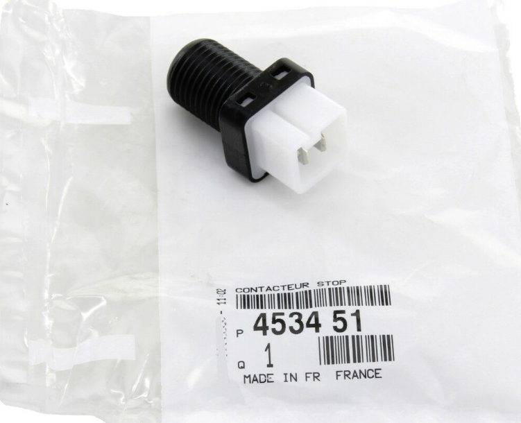

Do you have an image of the switch?
The one on my car looks like the following:
It would appear to be a single switch too (https://www.buycarparts.co.uk/hella/937169) if these are the correct part numbers:
CITROËN, PEUGEOT (4534.11)
CITROËN, PEUGEOT (4534.51)

That's looks like the correct one for your car. I've already checked using your VIN. It's why we do to avoid guesses and comparisons to cars that are completely different.
Part 453451: 2 pins as I said earlier. £15.53 from Citroen

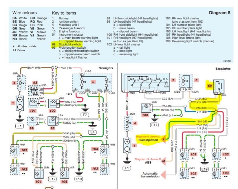

Faffing around on Google I've found a pdf for Xsara Wiring Diagram and it shows as follows:
Note how the output from the 'stoplight' switch routes to both the fuel injection (L) and the rear cluster and that it is a single switch serving both functions: See here that the stop light switch feeds into 207 (ECU).
EDIT: Just noticed clutch switch (225) on this diagram - and the inertia switch (212) which is the red fuel cut off switch located in the engine bay.
I am aware that this may not be the offical wiring diagram for my specific vehicle - the PDF has no official stamps or identifying text, but in the absence of official diagrams it does provide a level of validation that the brake switch does feed into fueling even for cars without Cruise Control.

You have to bear in mind that the Xsara II went through several major mods including the electrical architecture - after your RPO. So that will not necessarily be relevant to your vehicle because it was an earlier build. Your Xsara doesn't have 'drive by wire' accelerator pedal, it's a mechanically operated accelerator, so works differently than later systems as one example.
Your RPO is 08802.
As for the diagrams - they are Haynes ones - say no more.
Example the second diagram section you highlighted is showing 1383, which is the Vehicle speed sensor power supply - nothing to do with the stop lamp switch. And also note the title of the diagram 'Typical HDi Diesel Engine Management System' - There's nothing typical about it at all.
I wish I had the official one to show you now
Your RPO is 08802.
