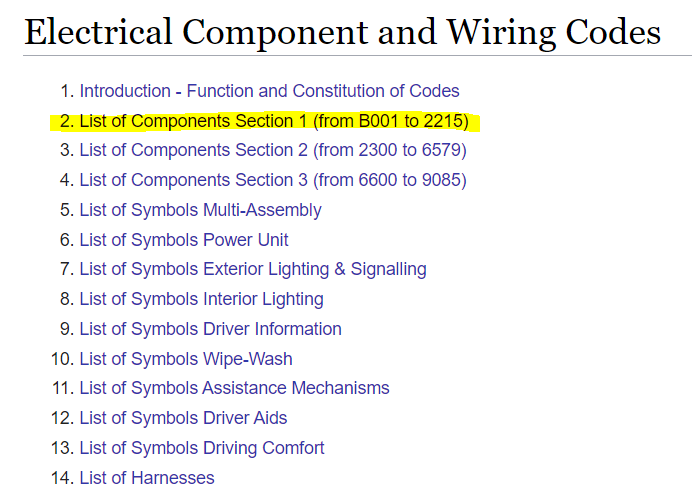

This is where you can use the Wiki:
Open this link in a separate browser window:
https://frenchcarforum.co.uk/wiki/Elect ... ring_Codes
This is the main content section for most of the electrical codes. As you can see there are several sections containing codes in ascending numerical order. I have highlighted the section that contains most of the Injection circuit codes. Just use your browser back button to go back to this menu if you need to go into a different section.

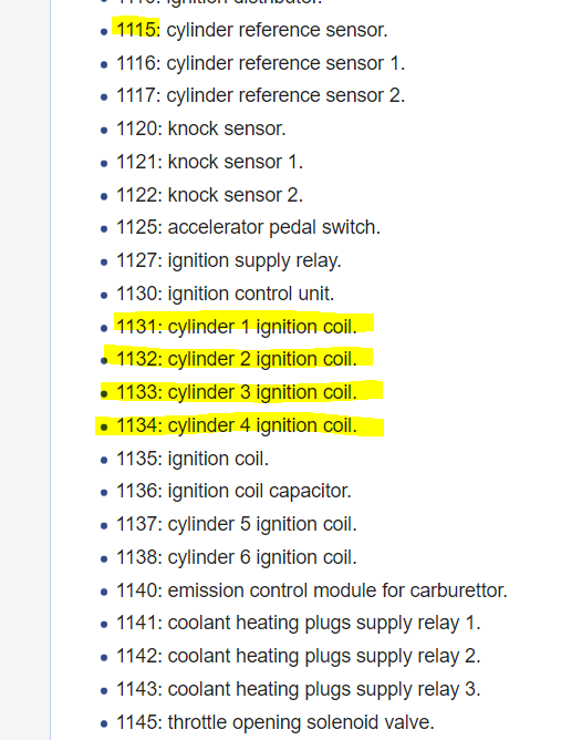

So if you wanted to find out what 1131 is, that would be in section (B001 to 2215).
Clicking on the highlighted section shown above takes you to the component list - in the example below, scrolling down you can see the injector codes matching those at the bottom of the electrical diagram.
