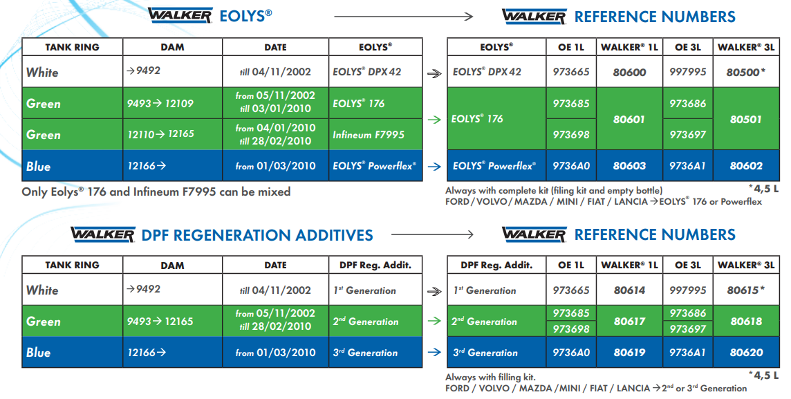

Ok, so your system, being first generation, uses Eolys DPX42 and should have a white click fit union on the additive tank.
Your additive is specific and so you cannot use Eolys 176, Infineum F7995 or Eolys Powerflex you must use Eolys DPX42.
Walker provide both the original Eolys DPX42 or their own cheaper equivalent brand.
So here are the Walker product numbers for both Eolys DPX42 and their equivalent Walker Alternative for each quantity.
Eolys DPX42 | Eolys DPX42 | Walker Alternative | Walker Alternative |
1 litre | 4,5 litres | 1 litre | 4,5 litres |
80600 | 80500 | 80614 | 80615 |

Your Build Number is 11118. So you need Eolys 176.
Walker do an equivalent 1 litre kit (Part 80601), or a 3Lt kit (80501)
You don't need to do any regeneration at a garage - your car regenerates the particle filter as necessary as you are driving without you doing anything. A forced regeneration is not recommended unless really necessary due to the toll it places on system components and the extreme heat generated from the engine.
Click Image to Zoom
- As for how long you have.... the additive quantity in the additive tank is not physically measured. It is estimated based on when it was filled against the amount it has injected into the tank over time based on fuel added and some other factors. The older system may just flag up when it thinks it needs topping up - the newer systems work out the next service interval due against the amount of additive it thinks is in the tank and if it thinks there will not be enough before the next service is due it will flag up the low fluid warning. You'll only get a limited amount of time 500-1000 miles maybe before it will drop the engine into backup reduced power mode.
- We can't ascertain when or if the DPF has been replaced.
- The Engine ECU will have to be reset when the fluid is topped up. You will need a Lexia or somebody with a Lexia kit to do this.
Click Fit Colour | RPO | Date | EOLYS |
White | To 9492 | To 04/11/2002 | EOLYS DPX42 |
GREEN | 9493 to 12109 | 05/11/2002 to 03/01/2010 | EOLYS 176 |
GREEN | 12110 to 12165 | 04/01/2010 to 28/02/2010 | Infineum F7995 |
BLUE | 12166 on | 01/03/2010 on | EOLYS Powerflex |
