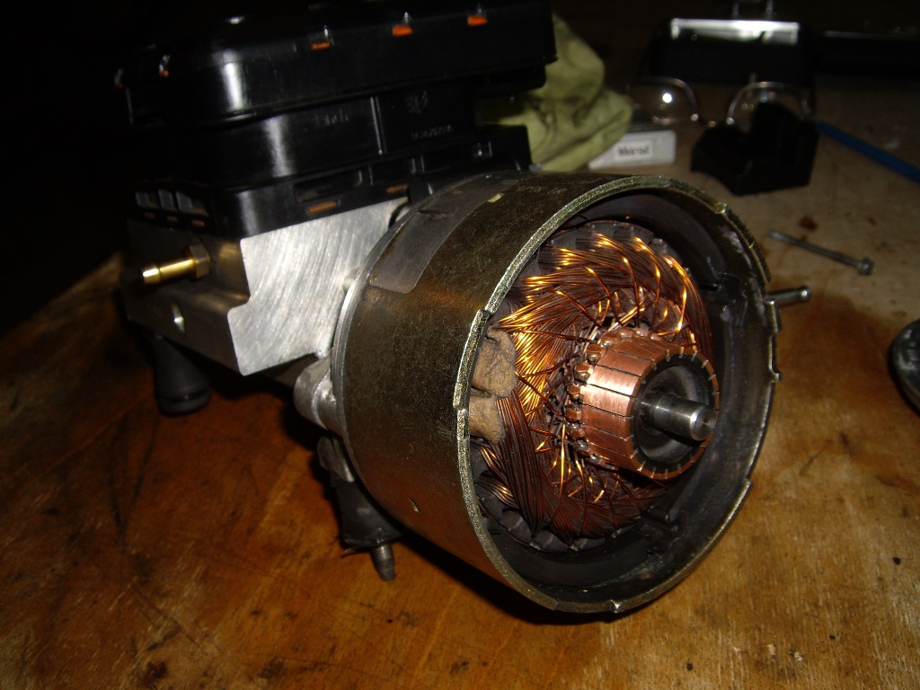

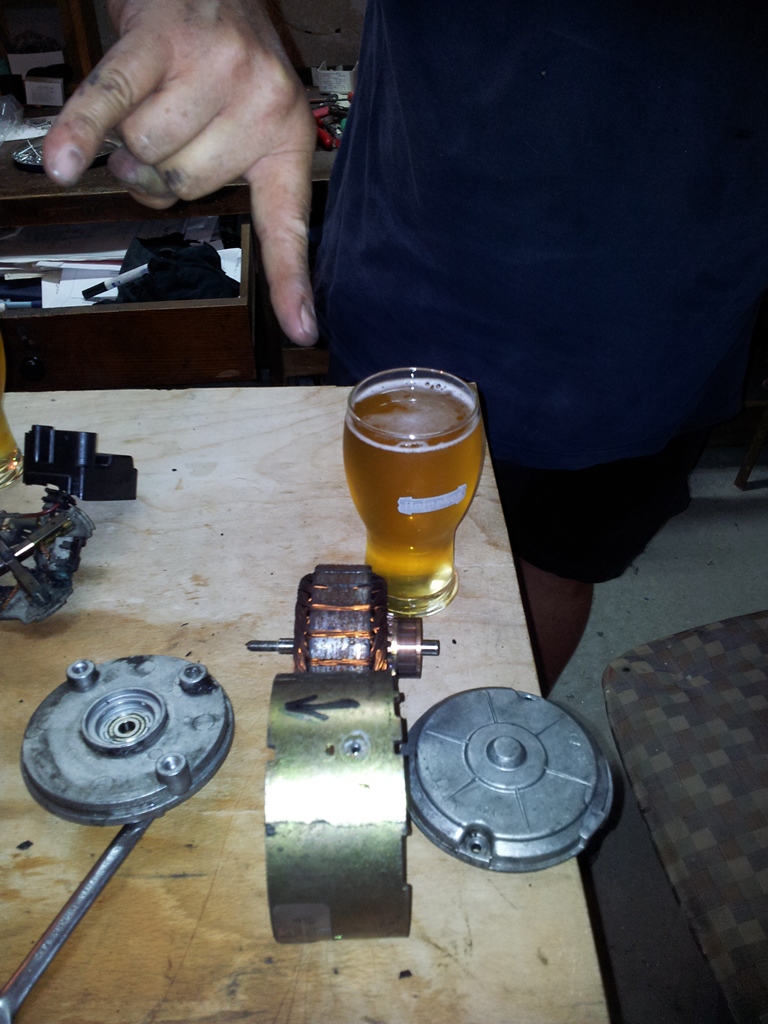

C5 suspension pump dissasembly.

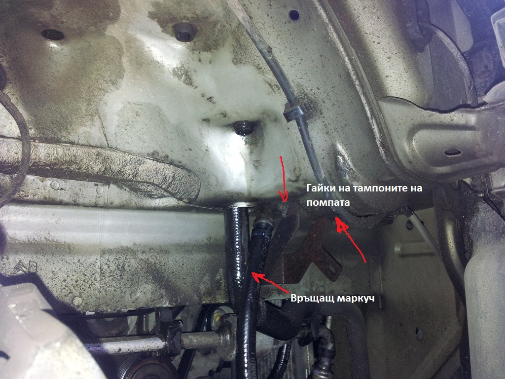

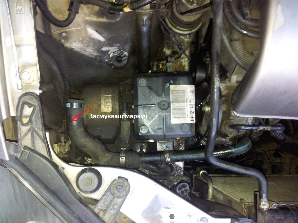

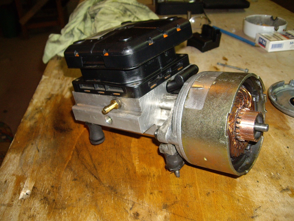

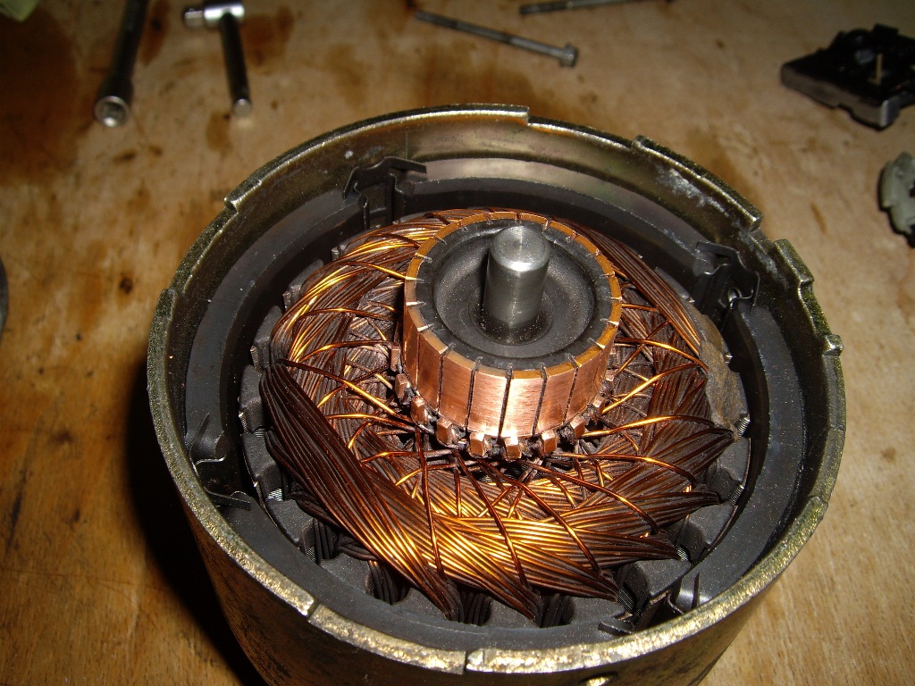

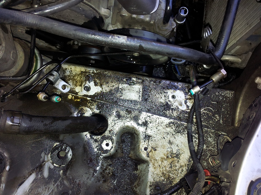

Jovani wrote: 08 Oct 2014, 08:10 Here's our photo report on the repair of the hydraulic pump. I apologize in advance for bad English - for faster translation we use Google Tanslate

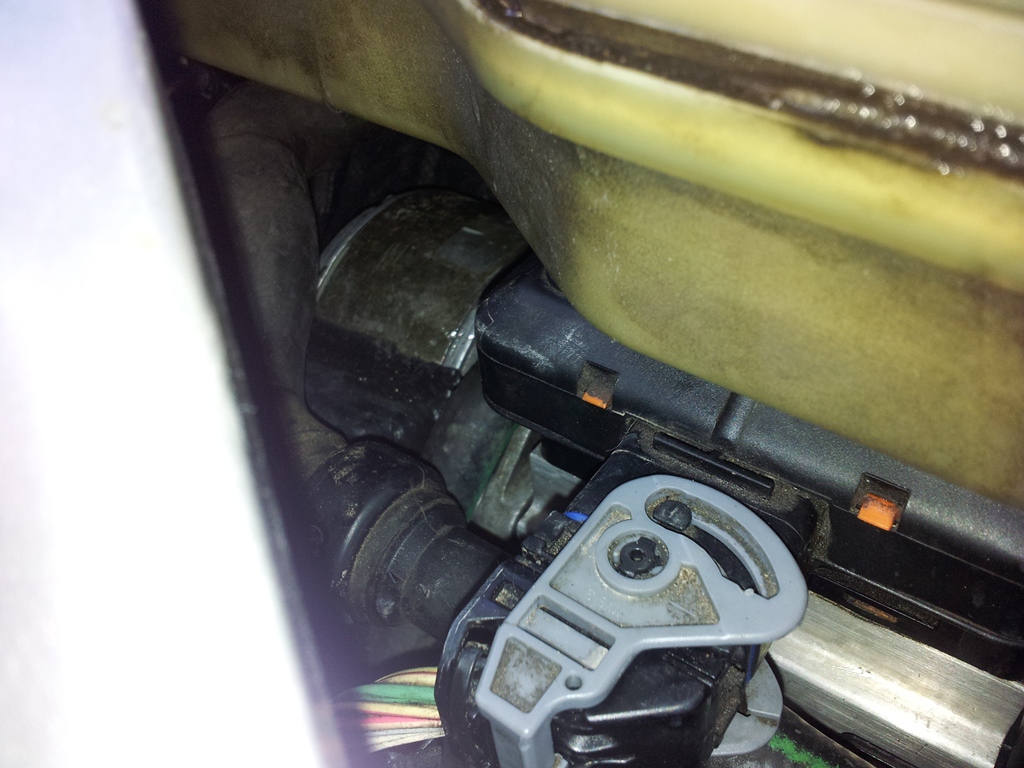

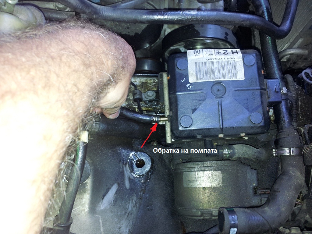

Raise the vehicle on a max. position, jacking, removing the right wheel and the front of the fender. Leaning car pivot holder and placed in the lowest position REQUIRED!!!. Deprsharize using LEXIA or other means to loosen the air vent on the right WING INNER FRAME.In the end, disconnect the battery.

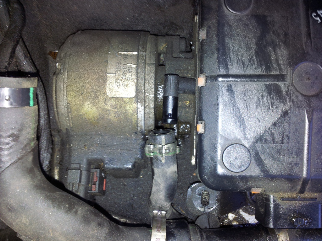

To remove the tank, top detaches Reversed top, underneath the fender from the tire return hose and drain into a clean container / tube oil
Lift tank and it is another disconnected Reversed and suction hose
Once removed tank, detachable Reversed pump and the coupling of the electronic block
Continuing with disconnecting the suction hose from the pump to the suspension and from the pump to the rudder servo
Following two tubes of high pressure to the front and rear axles. Particular attention to the two green "O" ring - one fell, but found it. Without them there is no seal then.

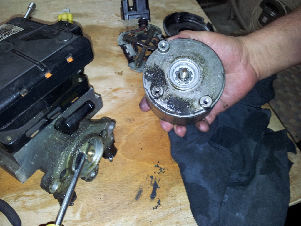

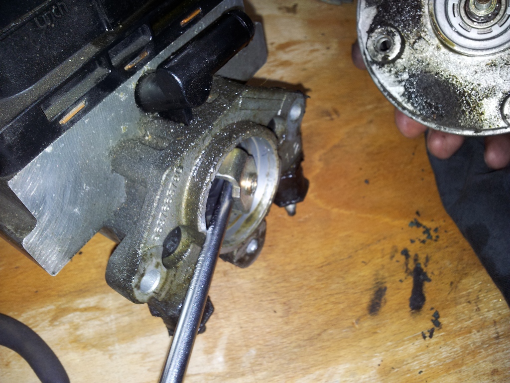

After unscrewing the nuts on the rear pads and disconnecting the motor cables take out dead pump. Unscrewed from the pump to the hydraulic unit is removed the back cover, remove the wiper shaft is furnished and management, pull gently pump, store counter of the box and develop rotor box - with a reverse thread.

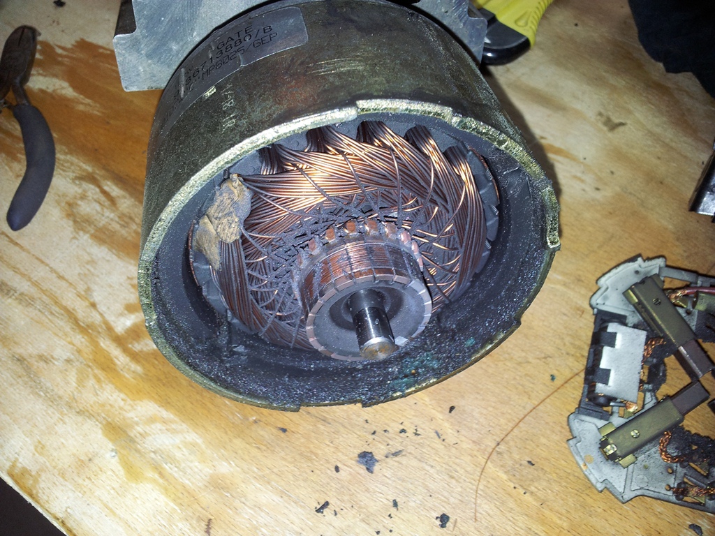

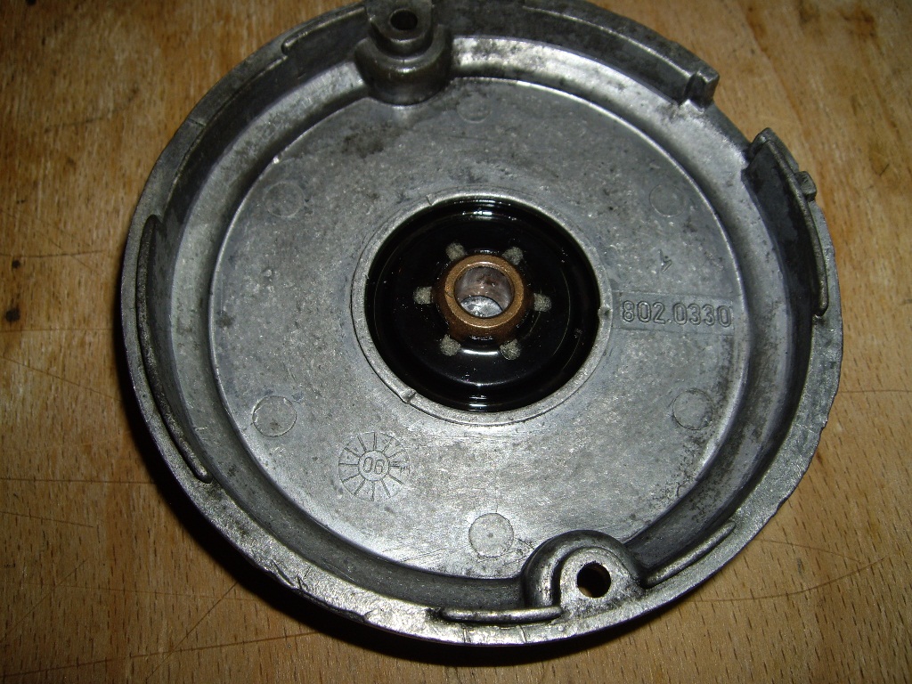

It totally disassembling and cleaning. At the front end of the pump shaft has a nut underneath circlip - is removed. Camp hood is kapselovan but munched - change for pennies. Back is a bronze bushing - after washing lubricated.
And that is the culprit for problems.
Because things smack ...

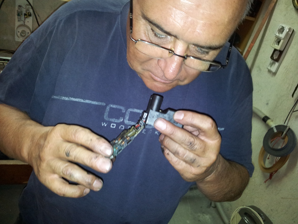

we decided to see what was in the control unit of the engine, but the bastards have it covered with black paint, though in good will could get our hands on the marking of transistors
After a wash, it is as ever wash all offal motor
We changed the front bearing, rotor went fine grinding and balancing
Assemble in reverse pump smeared with black silicone management (factory was also smeared) and assemble the car
Pour oil and now attention - to be swell tank with over 0.5 atm. pressure to be able to lift the pump. Quite straining fell :) dry after repair pump is not heard, and quite disturbing. Is less citroaerobik (up and down) and move the car in the shade cleaning mistakes and train his brain
