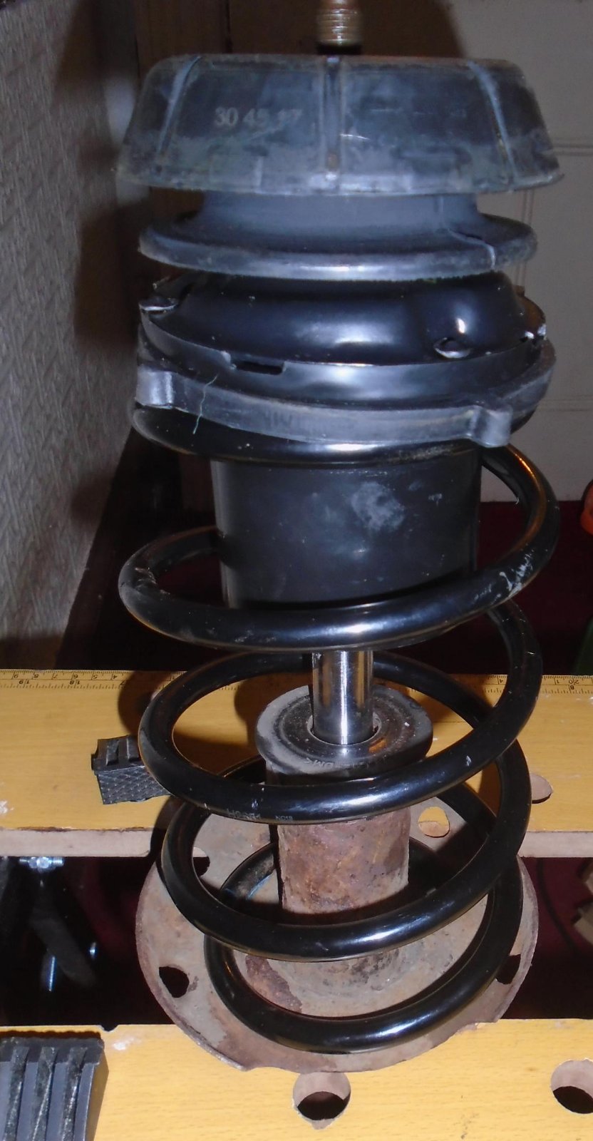

Bit of duplication but my "spring compressors" are worth a mention here too
Obviously a compressed spring can be lethal if your spring compressors break, but if the rachet or webbing gives way, particularly if you have 3 others in place, and several turns of webbing around the coils for each the likelyhood of a total catestrophic failure is reduced.
Anyway worked for me.

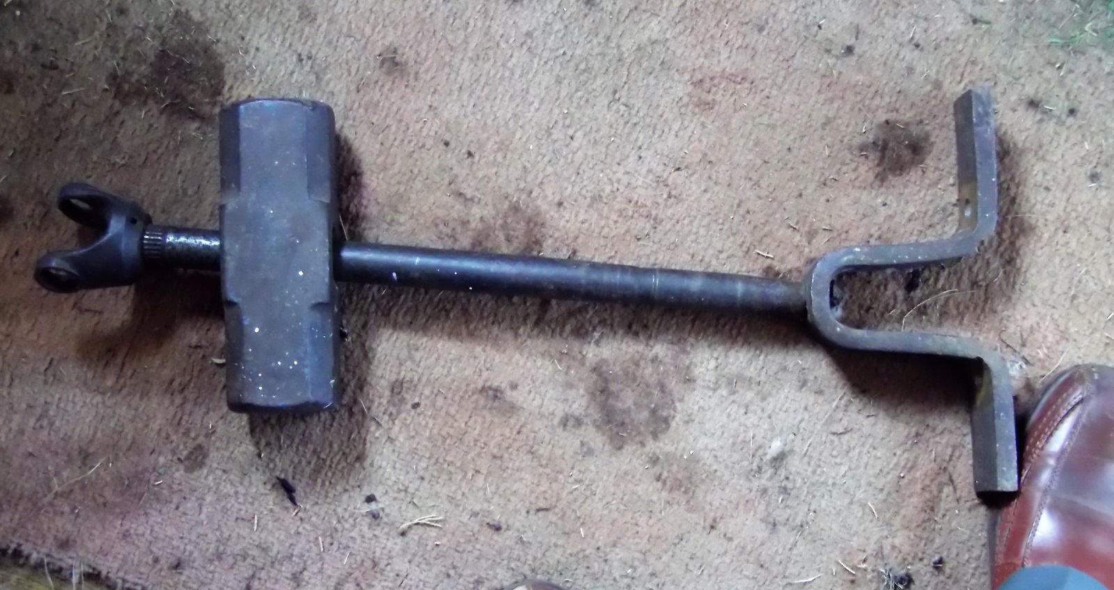

That's much too delicate Neil, take a look at my home made slide hammer for the big stuff.
- x 1751
- x 2943
Re: Toolbag Tales-Homemade and improvised tools
It was never defeated Chris.

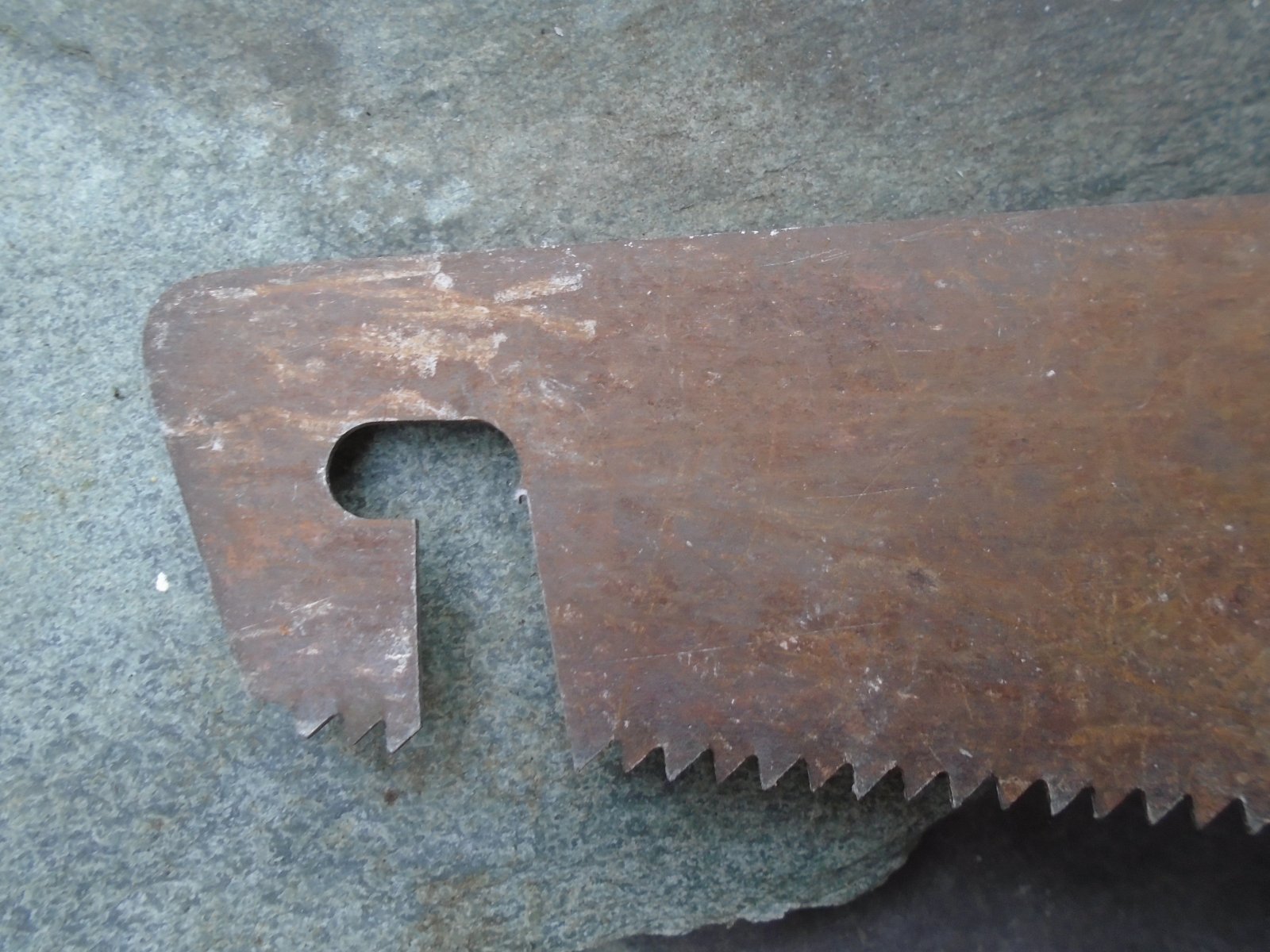

So what do you need when replacing a few broken slates.....
So I made one myself in a bit of inspirational creativity, and it works.
Well its a 40+ mile round trip to the nearest "Slate Ripper" supplier. Screwfix and Toolstation within touching distance of each other.............One has slate rippers for £28.99 quid, one for £8.49 (same make at both).Number 1.....A suitable youtube video ?
Number 2....A Slate Ripper. X
REgards NeilTake one rusty blunt old handsaw. Hacksaw a couple of cuts to the hanging-up hole to fashion the "hook" and bobs your uncle. You can hit the handle end with a hammer to exert additional force if required.
