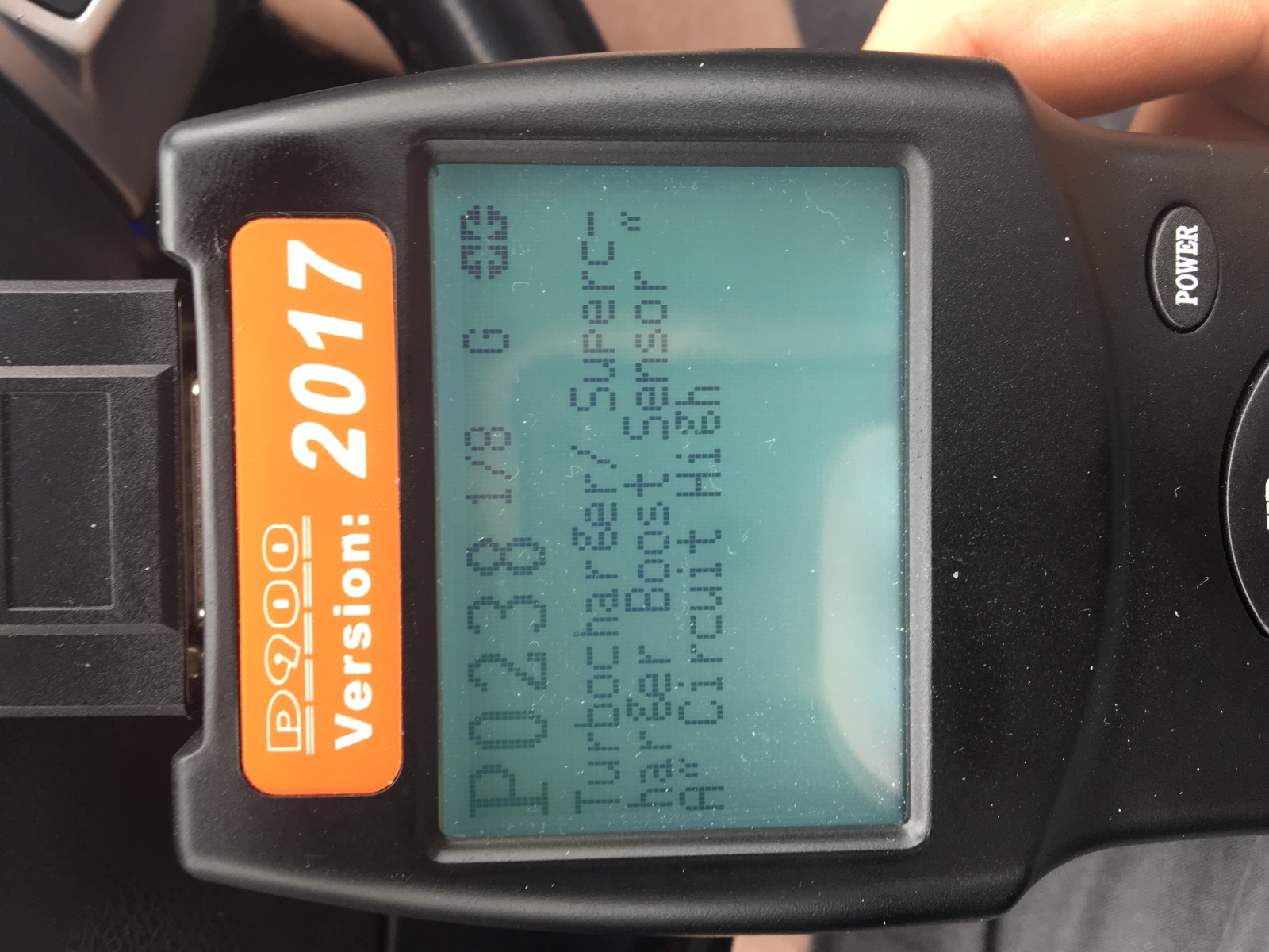

Have the engine management light on and poor fuel consumption.
Engine sounds fine and appears to run ok
Any suggestions on what could be coursing the issue
Thanks

Can we have a VIN code please? It would help identify engine type and options and with codes.
Initially and without a VIN to get the specific engine codes...
P0487 EGR electric butterfly position fault: Electrovalve jammed
Or: Mixer butterfly position copy signal : EGR throttle opening too low
P1161 - Mixer butterfly position copy signal : Butterfly jammed while driving
Or Fuel pressure regulation fault: Coherence of the pressure
P2100: Control of the mixer/butterfly : Open circuit
Or: Motorised throttle control: Short circuit between the wires
I'm wondering if the vacuum circuit is faulty, but would need your VIN to check specs.

Thank you for your reply it’s a 2.2 hdi
Will check vin and post
