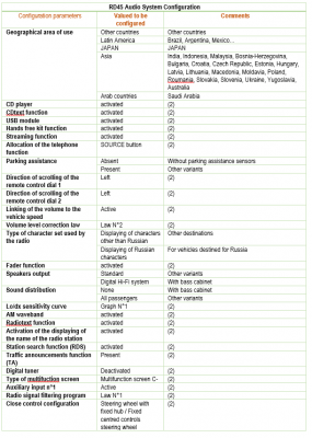

In case it helps, here are the RD45 Configuration Parameters (for a C5 X7 - but should be similar for the C2) Anything coded with a (2) is a default value that must be configures as such. As you can see this unit supports streaming and USB (if other modules are fitted) - but the values with a (2) must still be coded as such.
Lexia may show this slightly differently and in a different order and with slightly different descriptions - so be aware.
