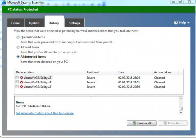

To day I checked the virus program on my own laptop.
I had inserted the CD that came with the Lexia / laptop into my own laptop to read what was on the disc.

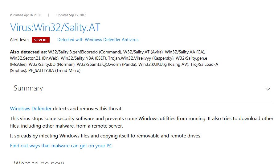

It had tried to install so I stopped it, the virus report is attached ?
Some virus reports can be misleading I know.

That virus warning could of come from anywhere - to be honest and would likely of been picked up and intercepted on the DVD by Windows Defender before it got transferred your PC.
