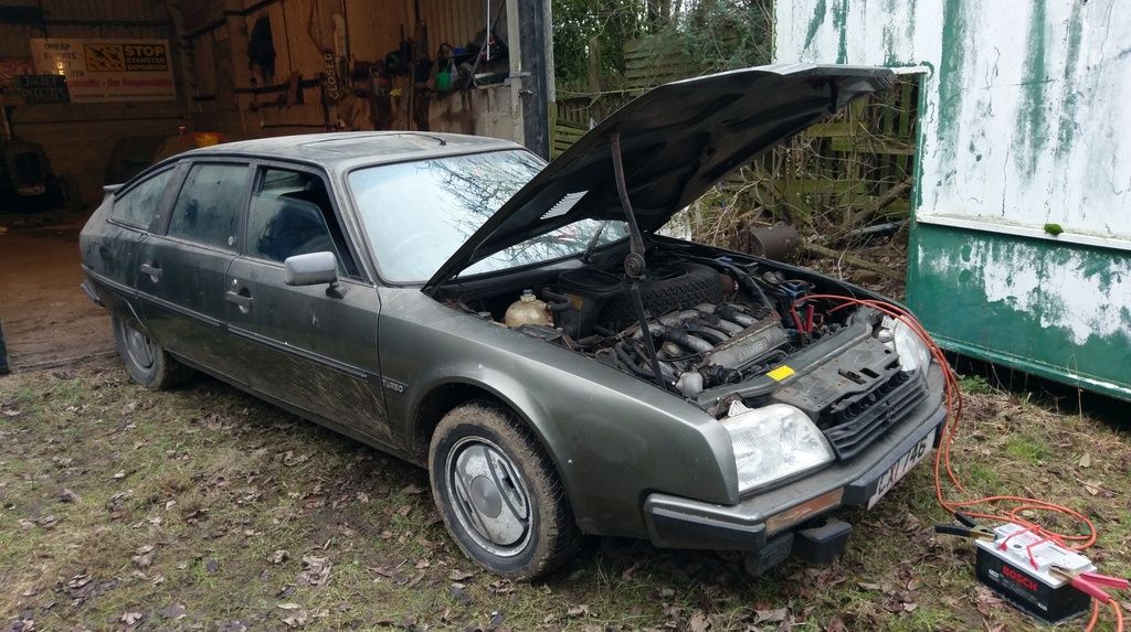

They're finds - in that although I parked them up there, it's been about 3-4 years since I last saw them... But I have found that they are still there!
Metallic blue S1 GTi T1 in front, ex Gerry Dennigan (if any members on here remember him and if I've spelt that correctly...) ABS and Air-Con, non-sunroof.
Metallic Grey S2 T1 GTi Turbo in rear, ex my dad. ABS no-air con or sunroof;
And hiding under there is a metallic green S1 GTi T1. Non-ABS, Non-Air-con but dreaded sunroof.
I had been planning to go over for some time, but not yet managed it. My hand is now being forced however, as I will be losing the space and need to get them moved. Alternative accommodation is one problem, getting them running so they can be moved is obviously another!
So after seven hours on Sunday, result is as follows;
Metallic Blue S1 GTi T1 = after purging lots of fuel I got it running (on two cylinders :roll: ) alternator completely seized (leaking thermostat housing onto an alternator that has run about 2 miles since I had it overhauled :evil: ) but suspension pumps up great, no leaks and tyres hold air. So that one can probably be moved ok but I really need to get it on 4 cylinders tbh. Alternator removed for repair.
Metallic Grey S2 GTi T1 = god knows what has happened to the starter motor. Absolutely nothing from it when jumped directly. No click, no current draw, nothing. So that's gonna have to come off. Couldn't face that horrendous job on the day so left it for next visit. One tyre refuses to hold air and the rad (that I had re-cored about 15 years ago) is leaking :roll: No further mice damage to the wiring than the last time I saw it had been ravaged, fortunately. Obviously no idea what will happen when suspension pumped up.
Metallic Green S2 GTi T1 = had it running, briefly. It will run while the cold start injector fires but dies when that times out. Pretty sure the fuel is stale and having tipped a gallon in still wasn't enough to mix it into usable state. Need to flush out all the old fuel and then refill with new and try again. Airs seem to hold air. Didn't have it running long enough to pump up the suspension so no idea on this one either. Hopefully ok because I replaced a lot of pipes before laying this one up, but.... 8-[

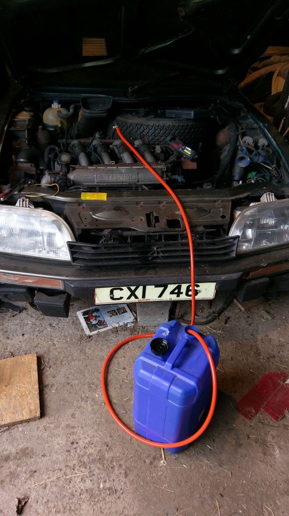

Back to them today. First up was flushing the old fuel from one;
I sussed out that LPG hose was significantly cheaper than car fuel hose, but rated for the same kind of fuel and pressure. 9mm ID was perfect for screwing the M10x1 banjo bolt into and hey presto :)
Watching the fuel pump out pointed to the flow not being consistent - it sorted of 'pumped' rather than continuously flowed. I went to the back of the car to check whether the pump was running smoothly and while I was there, heard the unmistakable sound of a metal tank collapsing in on itself, under vacuum.
Opening the fill cap caused a long intake of air and the tank popped open again. Hmm... Seems the tank vent system is blocked... Bingo! (we thought...) Topped it up with fresh fuel and we tried running it with the filler cap off and... Same

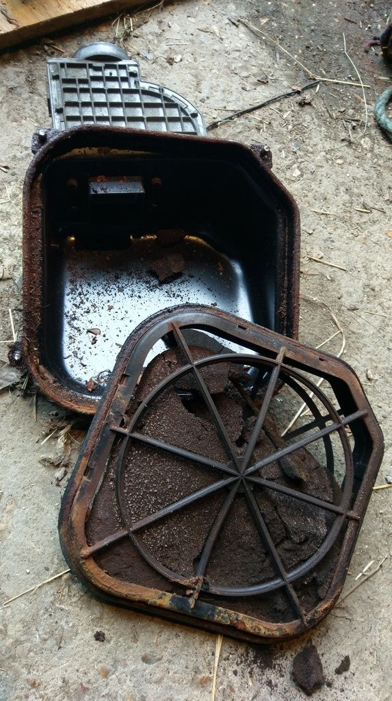

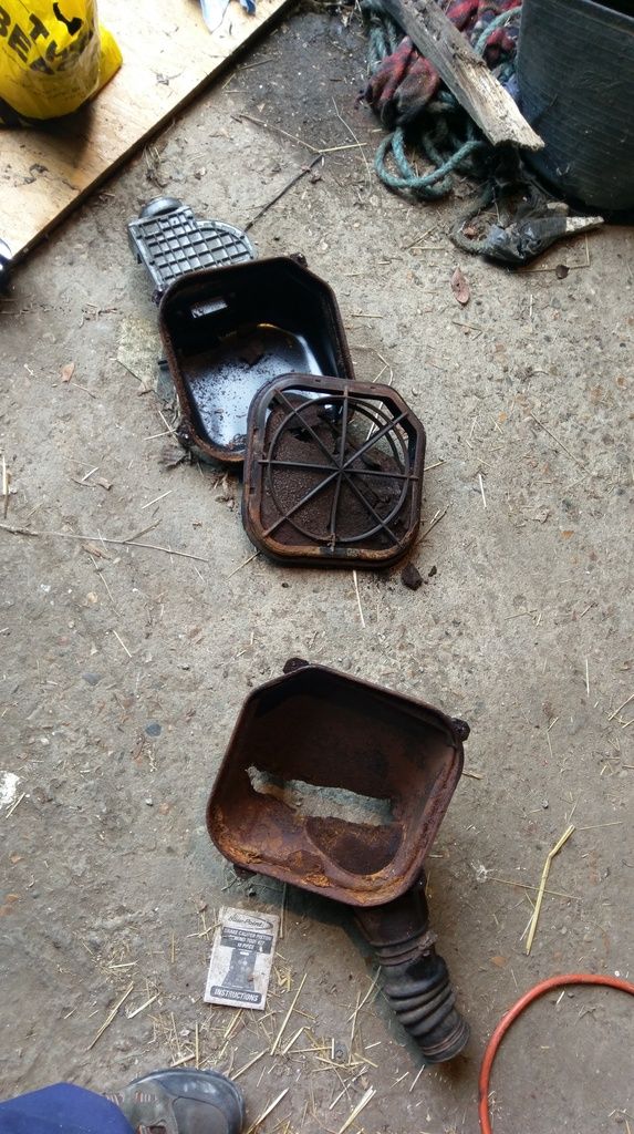

Stripped down the intake system, in case there was something blocking that and found that the filter was completely rotten and the bottom of the filter housing was completely rotten out;
Haha! More possible causes..?
Nope, same.
