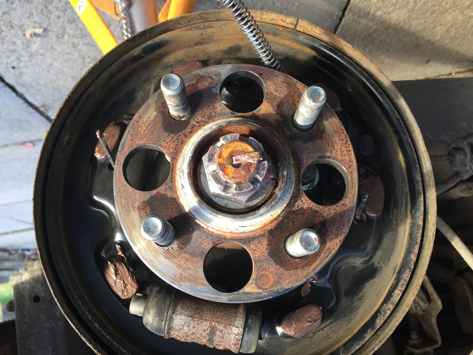

All finished, and pretty successful I think!

Anyway I stripped everything down and gave everything a good clean (I was impressed with Wynns brake and clutch cleaner, it just dissolved the grease and sticky muck instantly leaving it spotless) and found what I think was the main reason for the brake stickiness/binding.
Apart from everything being coated in greasy sticky brake dust, it appears that the baking plate has some sort of hard black enamel paint on it which has worn through to the metal on the little raised ears where the side of the shoes contact, and they were snagging in the resulting depression: Before clearing the backing plate there was hardly any grease on these ears and it was a yellow gummy stuff - not sure what it was. I ended up deciding to use copper grease for the backing plate ears, as well as the bottom shoe guide: (not visible)
I used normal lithium grease in the thread of the self adjuster, which was a bit gummed up with a dirt/dust/grease mixture. I also sanded the rusty lip off the inside edge of the drum where the edge of the lining would touch, and chamfered the trailing and leading edges of all the shoes slightly.
Put it all back together and adjusted the handbrake adjuster so that the hand brake started applying at 3 clicks and was on hard by 5.

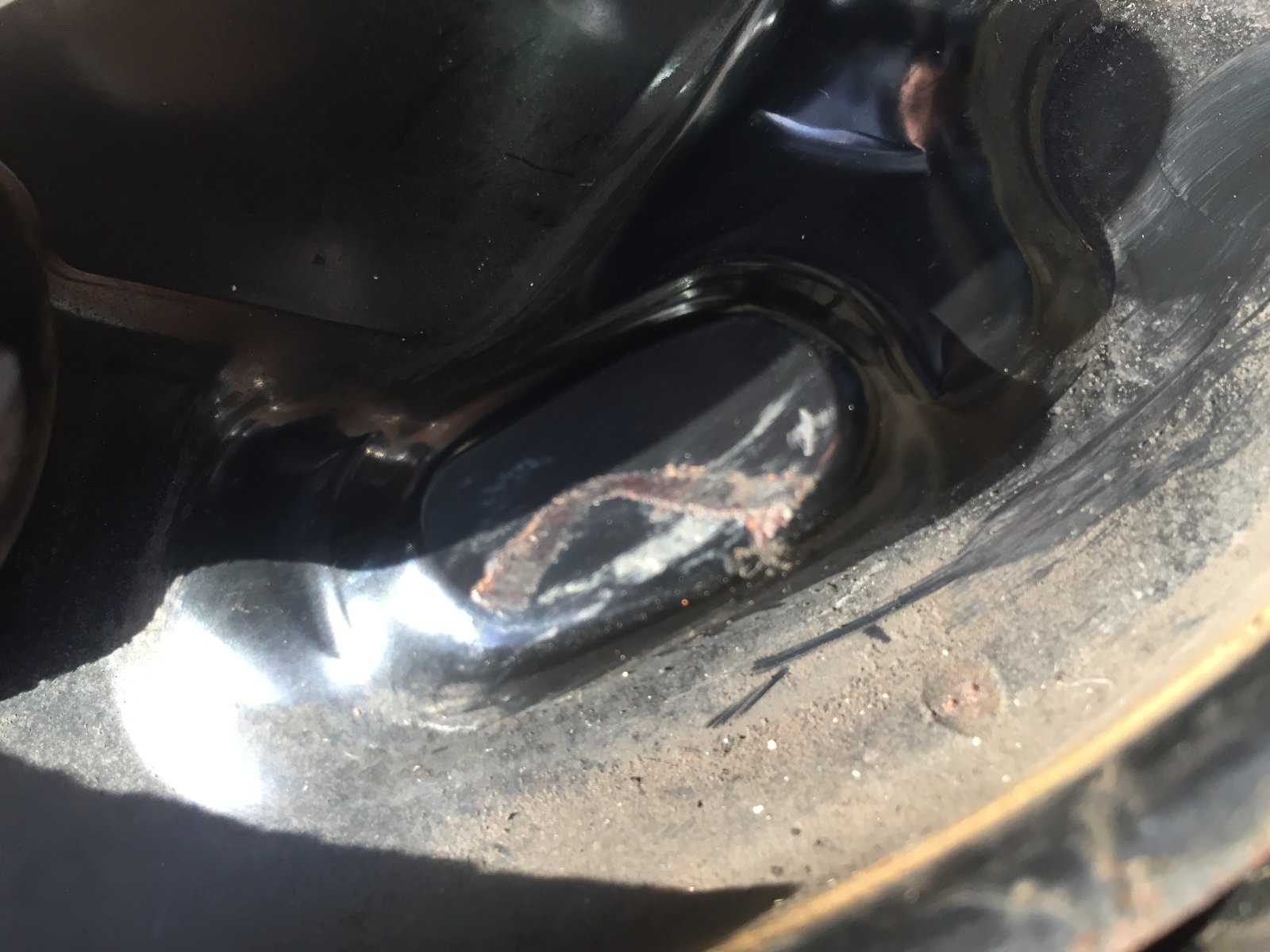

The only thing I wasn't completely happy with is the drum on the right hand side seems to be slightly eccentrically located - there is a tiny bit of dragging noise at one point in its rotation - and I also noticed that if I pulled the hub off and turn it around on the studs that it was a lot worse in some orientations than others when in theory if everything is true it shouldn't make a difference. So I just fitted it in the orientation where it did this the least, and it seems very minor. The left hand side came out perfect and doesn't seem to care what orientation the drum was fitted.

Yes I noticed the right hand drum had a lot of rust on the lip - I ended up sitting it down flat on the concrete and rotating it by hand - smooth concrete does wonders here.bobins wrote: 06 Jan 2018, 13:53 When refitted, the drums can be a bit of a snug fit against the backplate - not touching, but not much clearance. Make sure the edge of the drum and corresponding part of the backplate are cleaned back of rust and crud so the drum can rotate freely - a simple wire brushing will do the trick.

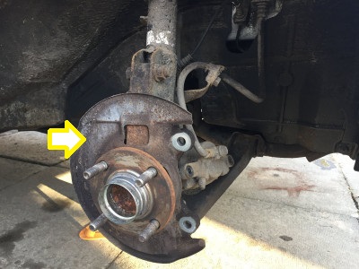

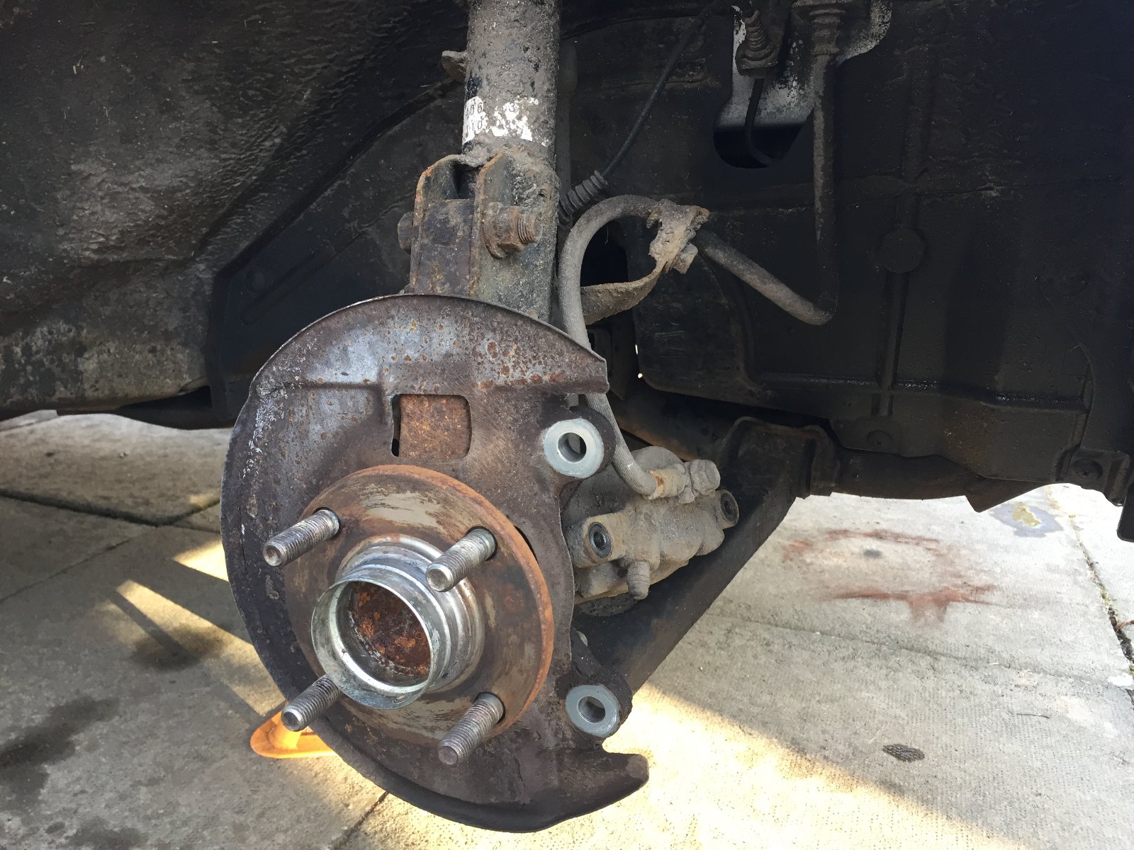

So I decided to brave the -4C temperatures and aches and pains from the previous days drum brake work to do the front brakes yesterday.
On the whole it went well and the front brakes on this car are a dream to work on - very easy to disassemble, so no problem there. I could have done the whole job in a fraction of the time of the drum work, were it not for a couple of snags...Here is everything stripped back:

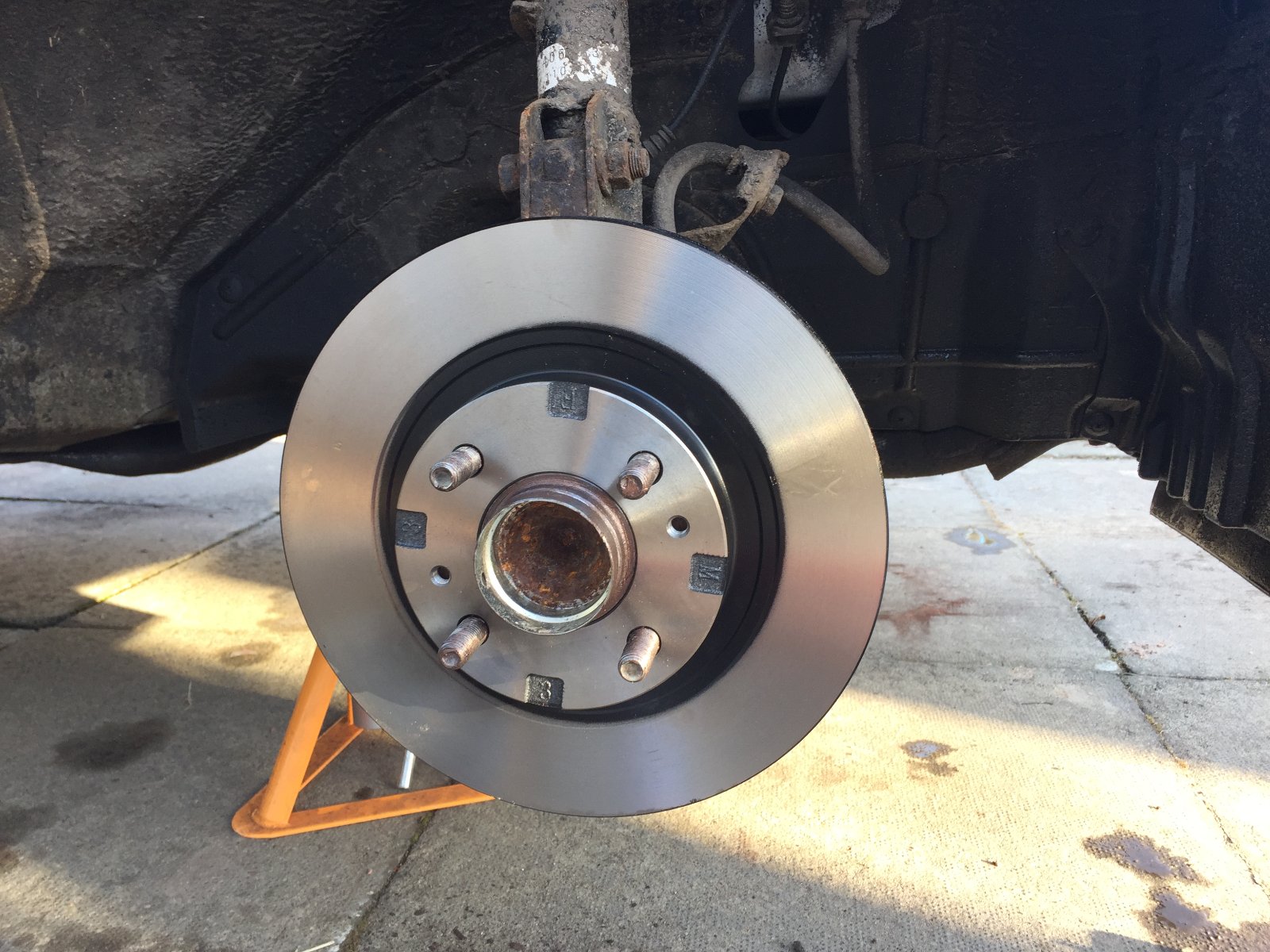

And here are the new discs sitting in place:
There are no locating screws holding the discs on this car - in fact they have the same M8 threaded holes to use as pullers to get the disc off as the rear drums... I didn't have any M8 bolts within reach without searching through countless containers spread around the house and garage so I just carefully tapped it off from behind with my block hammer - took a while working my way around to keep it even but off it came.

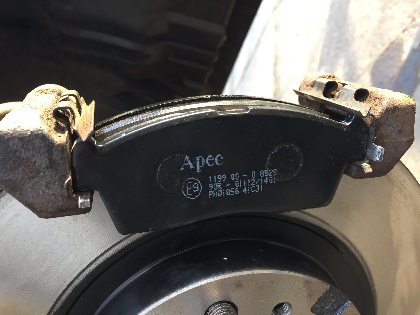

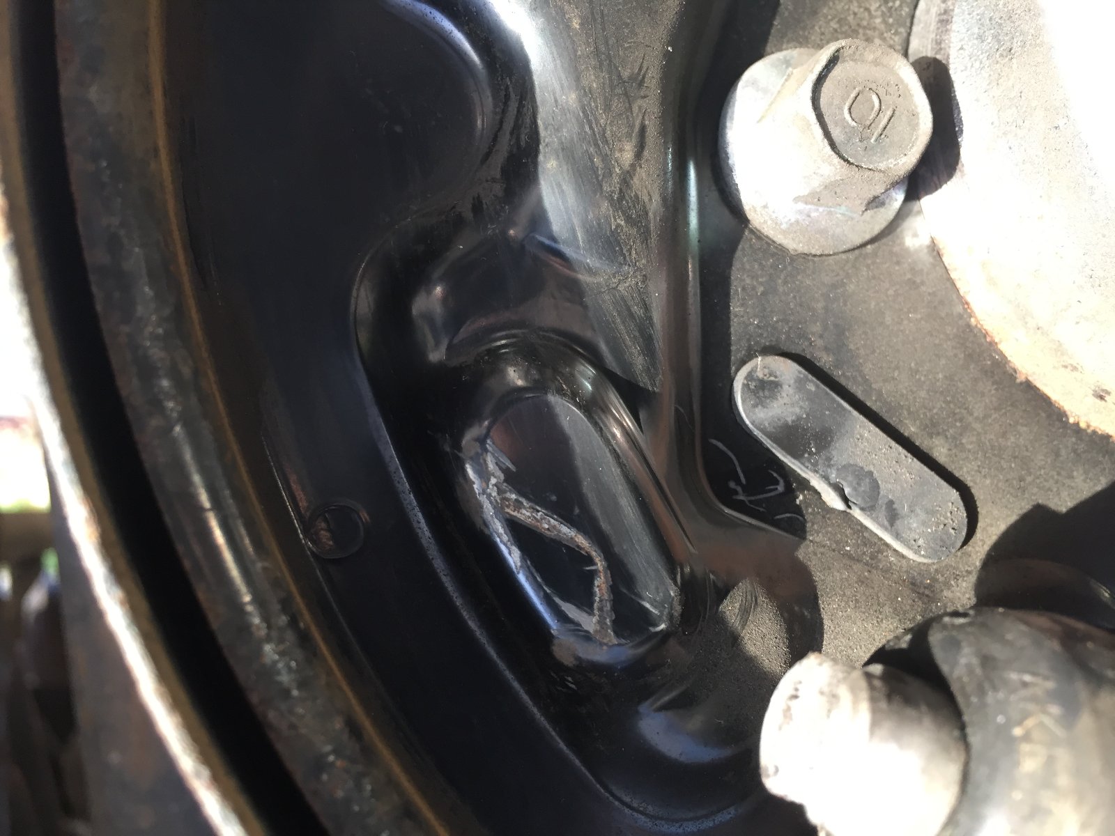

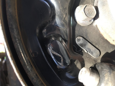

The major snag I ran into that turned an otherwise very smooth easy job into a bit of a pain was that the new pads didn't fit in the caliper!!
The ears protruded too far and physically could not fit. And if I forced them in, they were so tight that they would never move freely so they wouldn't work properly.
They measure about 0.5mm longer tip to tip than the original pads - which themselves were wedged in kind of tight as well... These calipers have well designed stainless steel shims with built in anti-rattle springs which you can see in this picture:
I checked there wasn't any rust build up behind the stainless steel shims but there wasn't, and I'd already cleaned the shims as well, but there was no way they were going to fit. So I did a little bit of googling to see if other people have this problem and whether it was an acceptable fix to file a bit off the ears of the pads!
Apparently its a relatively common problem on some cheaper pads that the ears aren't stamped very precisely and they often don't fit very well if at all.
I didn't like the idea of filing them since I'm filing the protective paint layer off them which will inevitably lead to the tips of the ears rusting in the future but I don't see what other choice I have ? At least in this case the ears only contact stainless steel shims so they're unlikely to actually rust solid into the calipers like they do on calipers where it is just steel to steel contact.
I ended up having to take about 0.8mm off the total length of the pad measured from ear to ear before I felt they were fitting and moving well with a little bit of clearance of around 0.4mm to allow for rust growth in the future without them getting tight again. The way the shims are designed the spring loaded part keeps them tightly in place even with a little bit of vertical clearance so they don't rattle at all. I also put a little wipe of copper grease on the shims.
I have to wonder how many out of spec pad ears there are on 3rd party pads which are too tight but loose enough to be jammed in that people just go ahead and forcibly fit without considering that they will seize and not work properly especially as they get rusty... In this case they were so over size that they just wouldn't go in so I was forced to file them.

Note that you didn't check whether there was any run-out (lateral wobble) of the new discs on the old hub. You could be lucky! (Not sure whether you have a surface micrometer and magnetic stand.)
If you do get any front brake vibration when the brakes have settled in (and that you can't check with a micrometer), then just rotate the disc on the hub bolts by 90deg, and try again. Four possibilities for minimum run-out, which should be 0.002"/0.05mm-ish. A cleaned hub mating surface also helps.
Those backplates etc could do with a coat of wax, back and front; they're very rusty, and can vanish altogether if not protected. There's no danger of applied wax getting on to the brakes.

I've had the same issue with after-market brake pads being a bit long or inaccurate in the ear department Simon...
A few seconds on the grinder soon sorts it... Never painted over it. just smeared a thin layer of copper grease on...

I've used the grinder on pads that don't quite fit many times. I was taught to do this when I was only 13, helping out in my Nan's friend's back street garage on a Mk2 Escort. Imagine that now, a 13 year old being allowed to use a grinder in a working garage!
Made me laugh with your careful tapping of the disc to get it off. Most discs I've done, have needed rather more than that
- Posts: 53003
- x 7329
Re: Simon's new Xantia V6 and Peugeot Ion blog
Michel wrote: 08 Jan 2018, 12:30 Made me laugh with your careful tapping of the disc to get it off. Most discs I've done, have needed rather more than that![]()
Me too.. I've smashed 7 bells out of them with a bloody great sledgehammer before now...
Great for relieving frustration...

Well actually I did check for run out, I just didn't mention it.white exec wrote: 08 Jan 2018, 12:02 Note that you didn't check whether there was any run-out (lateral wobble) of the new discs on the old hub. You could be lucky! (Not sure whether you have a surface micrometer and magnetic stand.)
Not sure what piece you're calling the back plate ? Are you referring to the two fingers that clamp over the outer pad from the caliper ? Or are you referring to the hub face that the disc goes onto ? If the later, I put a thin coating of copper grease over the face where it meets up with the disc, also around the edge where as you say it had quite a bit of surface rust. Better than no protection, probably!
They have a habit of progressively rusting away, especially in salty conditions, and have been known to be annoying MoT failures.
