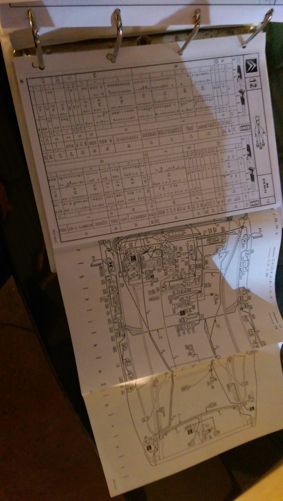

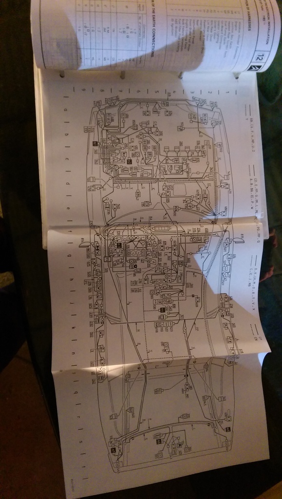

Sunday just gone, I spent some more time on it - this time armed with multimeter and service manual 8-)
About 4 hours spent and of course... Still haven't got to the bottom of the non starting :evil: injection loom all bells out ok, have live feed to one side of the injector plugs as I should when the ignition is on, checked out loads of the rest of the kit all ok to spec... Yadda Yadda...
But, with the help of some hieroglyphics...
I tracked down exactly what the spare/stray unconnected wire was in the area around the injector loom connectors and... It's not meant to be connected to anything 8-)
Nb: the wiring looms info looks an awful mess, but is actually really really good.
So, I'm back to thinking the fault can only be either ignition related (of sorts - I know the ignition system itself is working, but might not be sending the firing pulse to the injection ecu) or a fault with the injectors themselves (unlikely that all 4 would intermittently dir together?)
Next job is to bell out the wires between the injection and aei ecu's (easier said than done, given one is in the engine bay and the other is in the pax footwell somewhere). I'm assuming that link is what provides the pulse to fire the injectors (since it's the AEI unit that picks up engine rotation sensors, not the injection ecu).

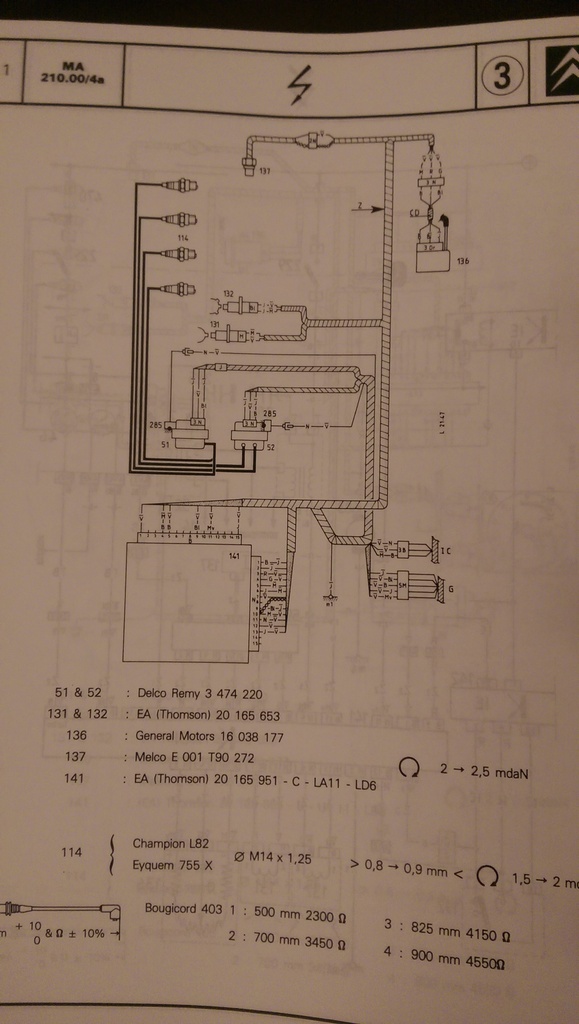

According to the oem service manual, this is the wiring schematic for the 2 sensor series 2 CX Gti Turbo;
This doesn't show any bloody link between the AEI and the Jetronic ECU.
However, the series 1 CX Gti Turbo schematic shows the following;
(clear link from B3 on the AEI to 21 on the Jetronic ECU)
That link is also shown in the main wiring schematic for 2 sensor M22/669 GTi Turbo's in the ignition section of the manual, so I think that's right.
The wiring diagram shows this;
I want the connector ("3B") that sits between loom Z2 and IC so that I can bell out to/from it. I can't find the damn thing anywhere and it's not shown in the main wiring loom layout drawing or the conenctor pin out table (annoyingly - otherwise that would give me the grid reference on the layout drawing)
Can any other CX owners help tell me where this connector is please?

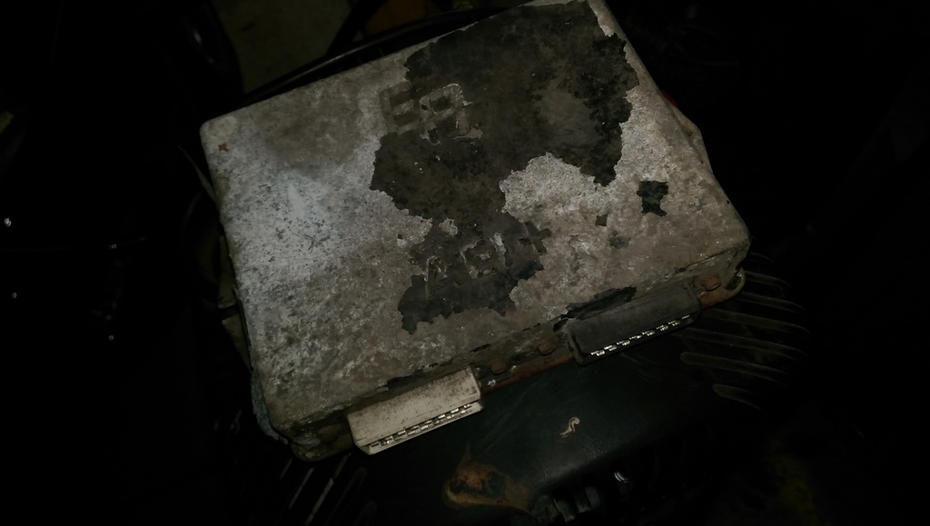

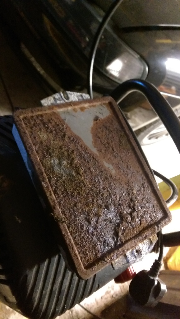

In the mean time I thought it might be worth checking the aei ecu itself for any damage, so hoiked it out:
Top looks a lot worse than it is really. It's aly, just causing the thin paint to flake off.

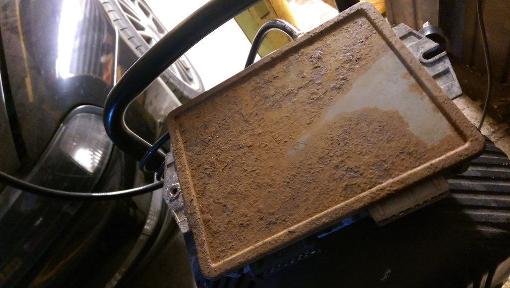

Underside however looked awful :roll:

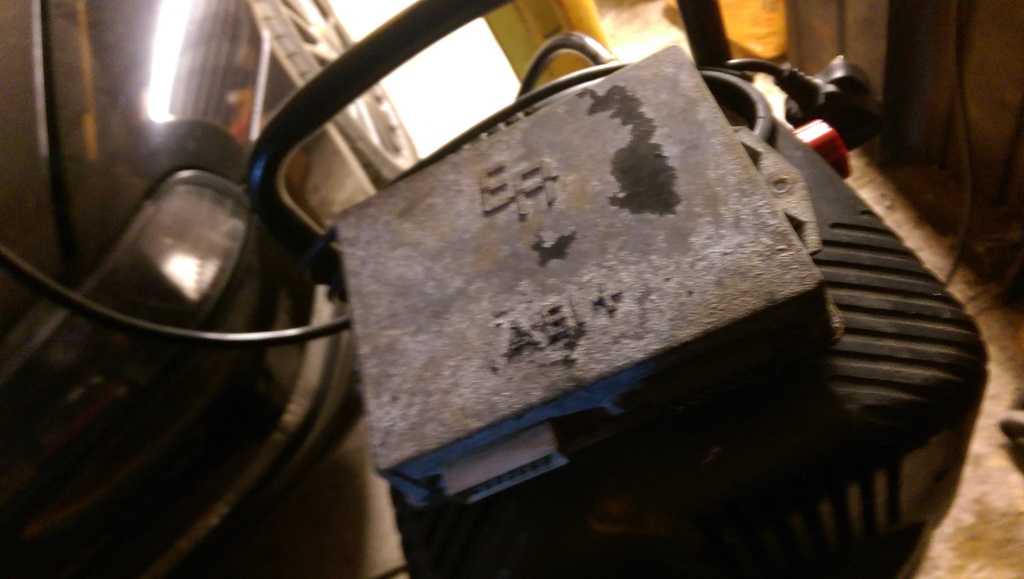

Quick brush over of the top
(that will clean up and paint ok)
A bit of wire brushing down and scraping with a screwdriver and the bottom actually isn't that bad:
Rest should clean off nicely with deox gel and re-paint fine.

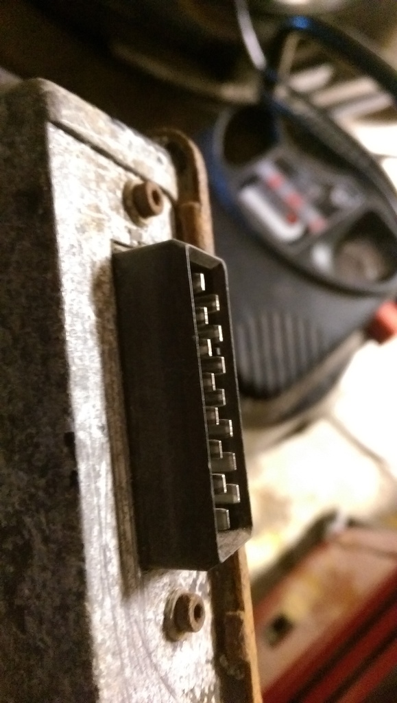

After I'd got it out, I thought I might have found the cause - Image
One of the pins in the black connector is slightly pushed in, but... alas that's not one of the pins involved in sending the pulse signal to the Injection ECU.
Now... :-k do I have the guts to bend the tabs, open it up and probably destroy the seal between the 2 halves of the case in the process..? 8-[

This is a great blog Iain and I'm enjoying it immensely :D
I've seen Xantia V6 gearbox ECUs looking like your AEI ECU as they live under the battery tray - a stupid place if ever there was one - I've cracked them open only to find them perfect inside...
Reseal with good electronics-grade silicone sealant and all will be good...
