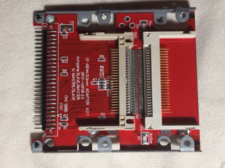

Compact Flash to IDE Adapter
You will need a CF to IDE adapter that can be bought very cheaply. For our purposes, we would need a CF to IDE 2.5” 44 Pin adapter, not the 40 pin type that are designed for the 3.5” Desktop versions. Pins 41 to 44 carry the 5V power supply that would normally be supplied by a Molex connector in a desktop version. The one pictured below happens to be a dual CF card adapter. I only bought this one instead of a single adapter because I mistakenly assumed from the pictures that this one had a metal bracket with screw holes that would allow it to be mounted in the NG4 HDD tray enclosure (there are additional holes along the sides of the metal support too). It didn’t! The screw holes are completely wrongly spaced when compared to the mounting screws on a 2.5” drive, but it still does the job.

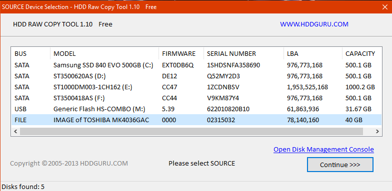

HDD Cloning Software
Cloning the Hard Drive will allow you to keep an image of the drive in its current state, so that you will always have a working image if your hard drive starts to fail in the future. Obviously if your system is already exhibiting data errors related to the Hard Drive, these will also be copied over.
Choosing the software to make a copy of the HDD is also important, some do not work very well. I have tried Acronis, Clonezilla and Paragon, and these failed to create a usable copy in my case (probably too many options). So my solution in the end was to use the free Open Source HDD Raw Copy Tool, from HDD Guru, which worked flawlessly, has a simple and easy interface with no complex options and is available from here:
HDD Guru Open Source Software
With the HDD Raw Copy tool can make an exact duplicate of a SATA, IDE, SAS, SCSI or SSD hard disk drive regardless of the Operating or file system on the HDD. It will also work with any USB and FIREWIRE external drive enclosures as well as SD, MMC, MemoryStick and CompactFlash media. The tool is free for home use.
This software will create a compressed image of an exact duplicate of the entire drive, sector by sector, so all the partitions and data will be replicated.

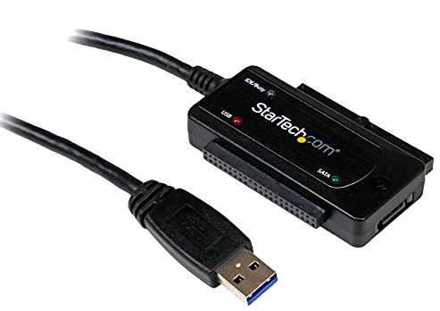

IDE to USB Card Reader
You will need some form of USB to IDE converter in order to copy the data from the original Hard Drive to an image file and again to write the image back to the CF Card.
USB to IDE Converter
I already had one of these from Startech that are reasonably priced. They are available in USB 2.0 or 3.0 specifications - but be advised that my USB 3.0 version failed to write back to the CF Card when connected directly to the IDE adapter and when connected to the USB 3.0 Port. In the end, I used the Compact Flash Internal PC Card Reader I have and this worked fine, albeit at a sustained 2.8MB/s write speed. I was happy with this as at least the data was copied back correctly without incident.
This is probably down to the USB 3.0 speeds being too fast for the CF card to handle as you have to remember that the USB 3.0 SATA / IDE converter is designed to send through data at the fastest speed available and also that the CF IDE Adapter is passive. It should be fine with USB 2.0 though.

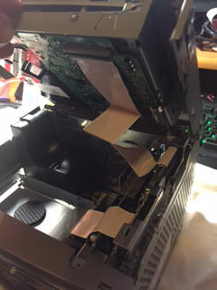

6) Next, you need to remove the 4 torx screws on the top of the unit indicated with green arrows.
7) The whole of the top of the unit is basically loosely hinged at the rear (connector end). You must be extremely careful here, as immediately attached to the inside of the lid is the DVD player and the ribbon cables, so do not go poking about inside with any instrument.
8) Using a small flat bladed screwdriver or blunt instrument, you need to gently lift the top of the unit working from the front of the sides, working towards the back on each side. Use a gentle pressure to lift the unit lid up, but do not use too much force as it may suddenly release and you may pull or damage the ribbon cables.
NG4 DVD Unit and Lid hinged Open
9) Be aware that the unit is not secured at the hinge - it can easily lift off so be extremely careful not to leave the unit unsupported as there is a lot of weight on the top of the lid. Also be very careful not to put any strain on the ribbon connector.
10) Undo the small torx screw on the left hand side, and use a small flat blade screwdriver to lower the metal flap. You can now slide the hard drive enclosure out of the unit.
11) Remove the 4 screws securing the drive to the enclosure - be aware that there is some ‘thread lock’ type adhesive on these - so they will be quite tight - also make sure that your torx bit is the right size to prevent damage to the head.
12) Gently lower the Lid back down and put the NG4 unit safely to one side.

Connect your Hard Drive to your IDE to USB converter first before powering up the converter (if applicable) and then connect the converter to your USB port.
14) Launch HDD Guru, which should detect all the PC Hard Drives as well as the NG4 Toshiba. You can check the correct drive by looking at the Serial Number on the HDD and matching this with the serial number shown in HDD Guru.
15) You first select the Toshiba as the source drive from the list, then you select the target location. In this case as we want to keep a source image of the drive, so select a target location on one of you PC Hard Drives that has at least 40GB free space. The tool makes a compressed image of the drive which in this case will result in roughly 24GB on completion.
16) Once the image has been copied and there are no errors reported, you can prepare to copy the image back over to the CF Card.
If using an IDE to USB converter:
17) If the CF to IDE adapter card has any jumper settings to configure, ensure the CF card is configured as ‘Slave’, as the NG4’s DVD Drive is the ‘Master’.
18) Ensure the USB connection of your IDE to USB converter device is removed from the PC. Insert the CF card into the CF to IDE adapter and in turn, connect the adapter to the IDE to USB converter device. Ensure that the pins are lined up properly then connect to the USB 2.0 port of your PC.

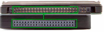

Pin Connector
Pin Connector
Or:

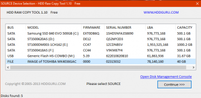

If using an Internal PC Card Reader:
17) Insert your CF card directly into the CF slot of your internal PC Card reader
18) Open up HDD Guru and this time select the ‘File’ - in the case below ‘IMAGE of TOSHIBA MK4036GAC’ Image that you created earlier as the Source and select the CF card as the Target (Drive M: in my case).
HDD Guru
HDD Guru
19) Select ‘Continue’ and leave the drive to copy - it will take longer to write than it took to copy. As I used the Internal Card Reader is only wrote back at 2.8MB/s, so will take an hour or so minimum.

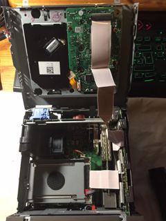

20) Once completed and assuming there were no errors, power off and remove the CF Card Adapter or eject the CF Card from the Reader.
21) Depending on the type of CF to IDE adapter you have, you may need to support it once it is plugged into the NG4’s PATA connector. Although these adapter cards are quite light, you do not want any vibration bouncing the card up and down, weakening the pins. Also, depending on your adapter, you must not allow any part of the underside of the pins or solder joints to come into contact with the drive enclosure metal. I used some ‘coin’ type adhesive foam pads and positioned a few of these under the card to act as both a cushion and an insulator. These worked great in keeping the adapter card level.
This picture shows one of the foam pads in place - I used 2 in all.
Placing Several Coin Pads to Cushion IDE Converter
Placing a Foam 'Coin Pad' under the CF Adapter

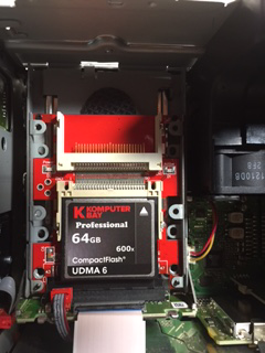

22) Now carefully position the CF Card adapter into position and connect the pins ensuring they line up correctly. Check that there is no excess play and that the adapter is well supported.
CF Card and IDE Adapter Installed
23) Secure the drive bay rail flap and replace the screw. Carefully close the lid ensuring you don’t trap the ribbon cable. I would suggest securing with one screw, just to keep the lid shut, until you connect the unit back up and check the system, in case you need to remove it again.
24) Re-connect the cables at the rear, ensuring that you connect the 40 pin Quad lock connector last. Gently slide the unit in, but don’t lock the unit back into place until it has been tested. Follow the battery connection procedure.
25) Start the engine and wait for Navidrive to initialise - it may take a little while after switching on for the first time after the replacement. Go through all the screens and check the functionality.

Has Anyone tried a 1.8" drive from an ipod ?.
The Spec's look similar if not better than the original drive

You would have to get a LIF to PATA / IDE interface converter, and they would have to be UDMA6, as UDMA7 or any later and they won’t work. Could be an alternative to try, but I’ve had no issues with a CF card that I’ve been using for 3 years now.
