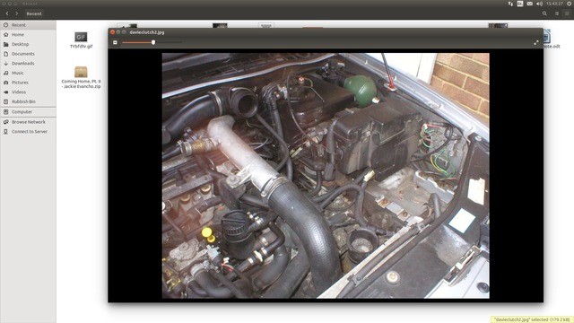

Jim ... your pics are reallu useful but is it possible to post them so's that they can be 'clicked' to open in a separate window, my eys are not that good and enlarging an image helps. What do you use for posting?

Those images won't do that but you can download them and open in your image viewer then enlarge them.

Right click - "Save Image As" and it will download for you or may even open directly in your image viewer (Paint?)

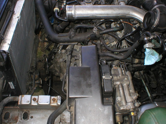

Got a bit more done this afternoon despite the weather
Sunny and dry but a wicked cold wind
Removed the LHM reservoir, the ABS block bracket, Activa Accumulator sphere and bracket, turbo hose and intake hose, pressure regulator and no doubt some other small items...
The ABS block has not been removed as it will pull far enough away from its bracket with all pipes still attached to allow the bracket to be removed and thus expose the gearbox top mount...
The gearbox is slowly becoming exposed

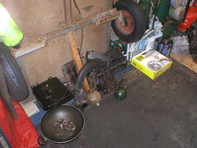

And the pile of bits removed is stating to grow nicely:
Davie, I popped your main accumulator sphere on the tester and it's at 42bars - 20 down on what it should be..
