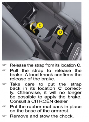

Guys sorry to resurrect a pretty old thread. Due to a dead battery I tried the strap method of releasing the handbrake earlier. When it eventually clicked I had a piece of yellow plastic fly out which I'm currently trying to find. This doesn't seem right or am I just paranoid?
x 6960
Re: C5 (X7) Electronic Parking Brake problem
Are you referring to the yellow plastic grip used to pull the handbrake release? Hopefully you didn't pull the end off! Here's the extract from the manual in case you don't have it. Ensure you follow the procedure below to make sure it is properly working:
