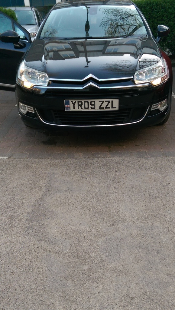

Ok, finally got around to changing the blown halogen DRL bulb. I'm buggered if i was gonna pay £40 for a bulb so i went the LED route, got 3 LED bulbs from China for £6 delivered. Had to wait 2 weeks for the bulbs but saved £74 so worth the delay. Bulbs are a straight swap, just remove the halogen bulb from the holder and replace with the LED. Here's the picture and the link to the ebay seller if you wish to go the same route....
http://www.ebay.co.uk/itm/151210066485? ... EBIDX%3AIT" onclick="window.open(this.href);return false;
09 C5 X7 2.0Hdi Exclusive in Perla Nera black (the best colour) :wink:

Definitely brighter than the ones I fitted back in 2011.
