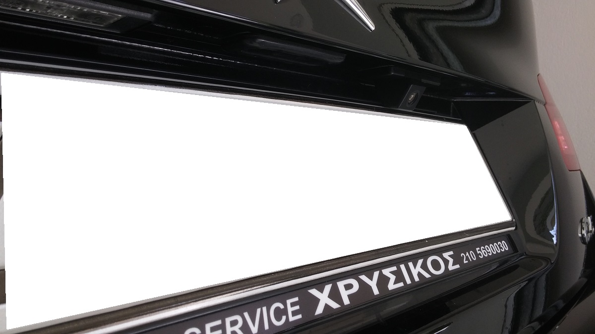

We install the ??? camera in place of one of the rear licence plate lights

A small problem I didn't even suspect could arise: the camera has a LED light, while on the other light I have installed a Phillips WhiteVision W5W bulb. Obviously the color temperature difference is significant, so I installed a small LED W5W bulb on the other licence plate light. However, instead of staying continuously on, both LEDs blink on and off at about 5-6Hz. The LED I installed is operational and just removed from a Peugeot 206 (side/parking bulb). By itself or paired with a normal W5W, the camera LED works OK. Any ideas ?

Sounds like you need CAN bus compatible LED's. LED bulbs draw hardly any current compared to normal filament bulbs. Some multiplexed cars detect this as a fault & cause problems with bulb failure detection systems etc. The CAN bus LED's have resistors in them to trick the car into thinking the bulb is OK.
A search on eBay for CAN bus or error free LED's will bring up thousands of results.
x 6959
Re: Aftermarket electrochromatic rear view mirror + camera
