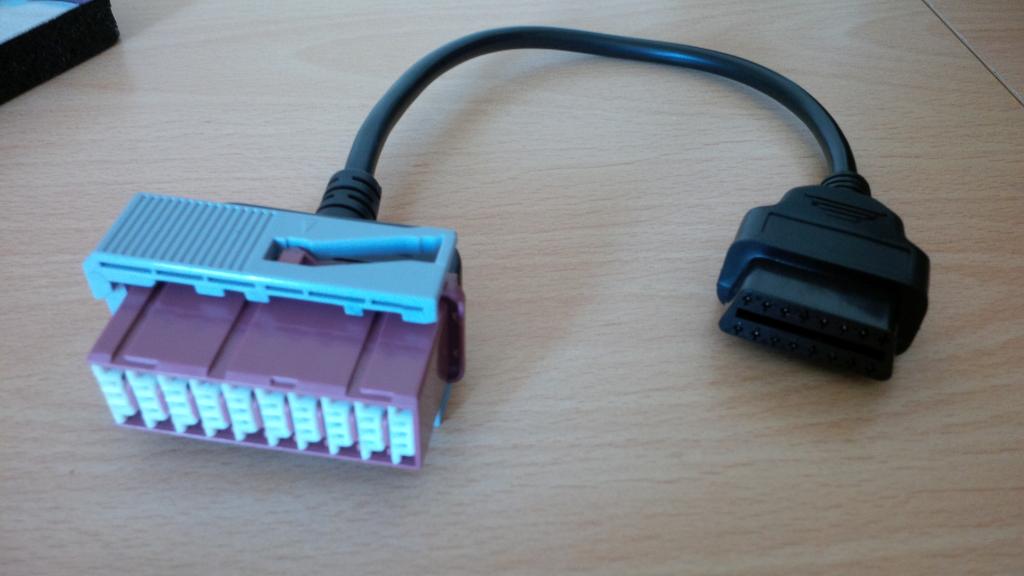

When I originally purchased my Lexia/Peugeot Planet, I discovered that the OBD to 30 Square Pin adaptor (used no older models ie Xantia and XM) wouldn't work
I decided therefore to purchase the 30 pin Circle to 30 Pin Square adaptor, however, this didn't work either.

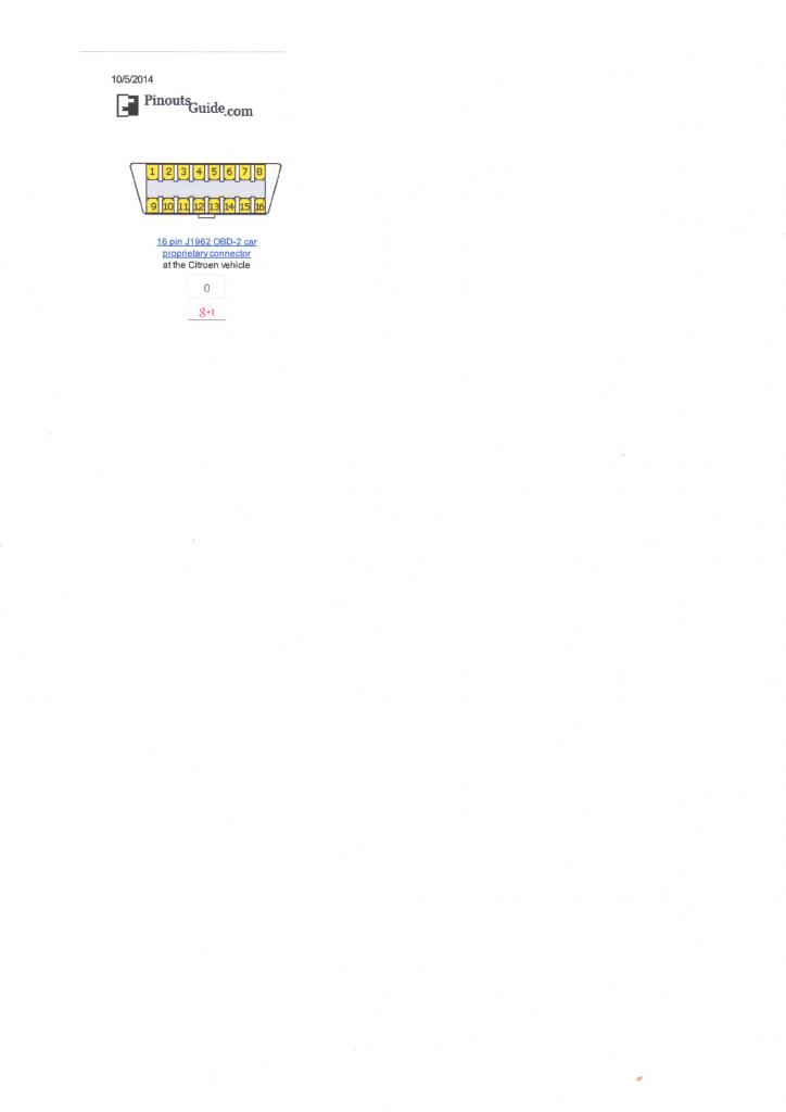

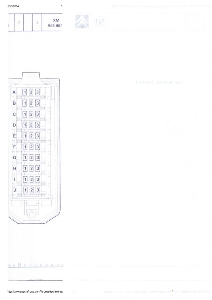

In a conversation with a couple of people I was sent a couple of diagrams from http://pinoutsguide.com/search.php?lang=eng&t=citroen" onclick="window.open(this.href);return false; these show the pin locations of what the wiring of each unit should be, however, I don't believe they are perfect, therefore what I'm after are is a diagram from a working cable, either of the above two pictures would be good, basically if somebody can pin out for me using a multimeter, which pins go to where, I would be grateful.
I'm copying to layouts of the connections at each end of the cable

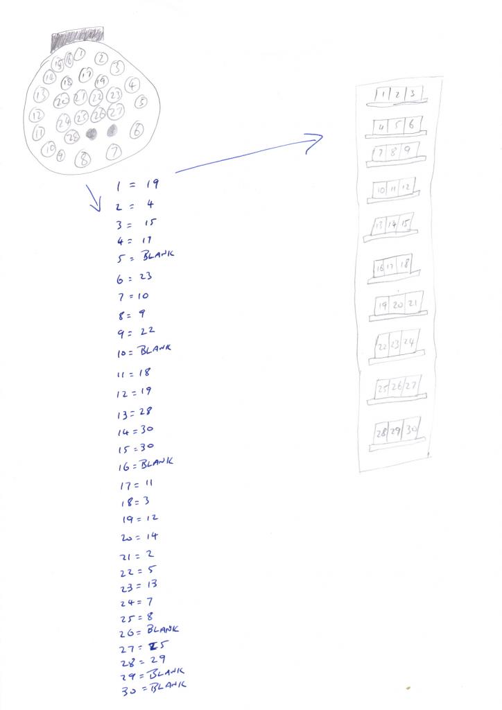

I also have a crude diagram of the pin out of my 30 pin Round connection to 30 pin Square connection

I've traced the OBD-II 16 in to 30 pin PSA rectangular connector for you. The orientation of the 30 pin connector on the pinoutsguide link you posted is a bit misleading - not only are 1 and 3 reversed when looking at the plug (since their picture is the socket in the car, not the plug) you also have to reverse A and J... which gets confusing. (I confirmed the orientation below is correct by checking for consistency of the +12v and ground wires between the two plugs, since we know those for sure on both plugs) See the photo below for the correct pin numbering and orientation:
Referring to the above pinouts, here are the connections, as well as my best guess at the function of each one, based on the pinouts on the pinoutsguide page. (There is some ambiguity on a couple of them...)

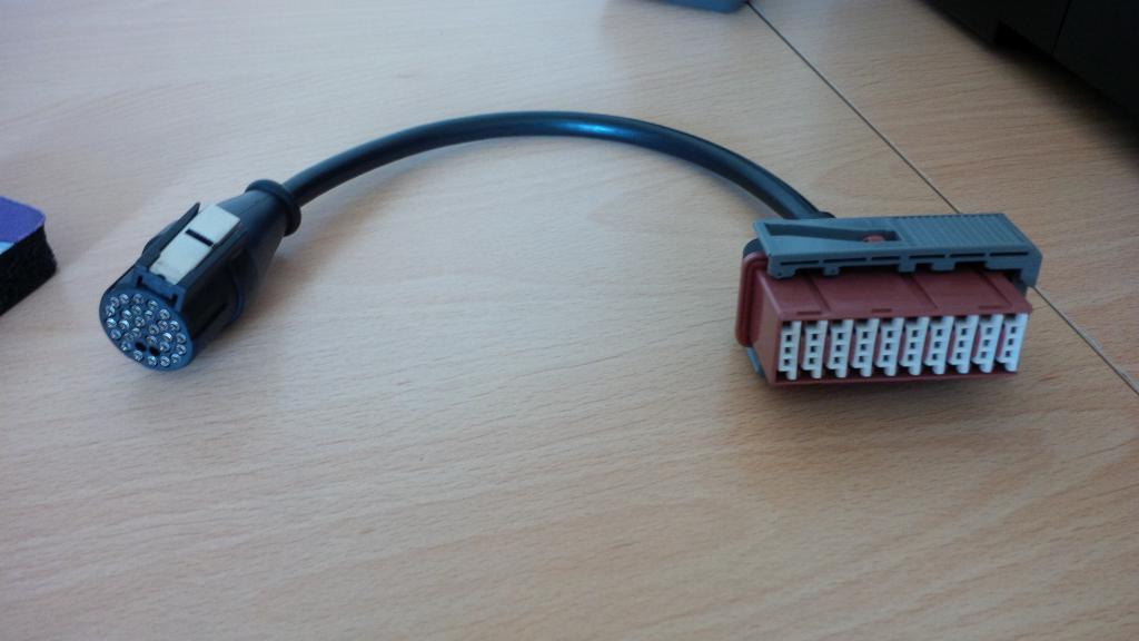

Steve, here is the wiring from the round connector all the way through to the 30 pin rectangular connector.
The pins on the round connector are actually numbered on the plug but the method of counting them is a little ambiguous so I thought it best to take a photo and show the pin numbers as I interpreted them:
Here are the pinouts referring to the above picture and the 30 pin rectangular connector on my previous post:
30 pin rectangular PSA / 30 pin round connector / Function
A1 / 5 / +12 volts
A2 / 22 / Switched (?) +12 volts
A3 / 3 and 4 / Chassis Ground
C1 / 25 / Engine ECU K-line
C2 / 12 / Engine ECU L-line (?)
D2 / 2 / GMV2 test (?)
E1 / 8 / K-line ABS
E2 / 14 / K-line Clearance adjustment (Hydractive 2 ?)
E3 / 7 / K-line Steering wheel module
F1 / 26 / K-line Heater / Aircon
F3 / 1 / K-line Air Bag
G1 / 11 / K-line Gearbox ECU
H3 / 6 / K-line Door lock
I1 / 30 / K-line Rear view mirror
I2 / 27 / K-line Anti-theft alarm
I3 / 30 / K-line Immobiliser
Hope this helps. :)
