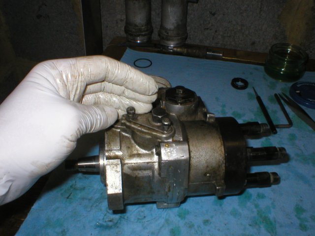

Mike, here's a guide to what you need to do to strip as far as replacing the body seal and ESOS seals.
Firstly remove the plastic cover on top of the pump. Then remove the ESOS Valve assembly and the two electric actuators, one on the side for the timing and one on the back of the pump that controls pump stroke. ESOS and actuator removal is easy and obvious but take care that you don't loose the plungers out of the ESOS valves. Most critically, if you do dislodge an ESOS plunger from the valve body note that they have small springs in teir ends and these are critical.
Note that one ESOS has a big red tip. This is the stop solenoid and this tip should alwas be replaced as it is liable to wear and cause problems. Also not the arrangement of O rings where the ESOS valves meet the pump body.
Here's the ESOS and actuator assembly removed:
The Stop ESOS is arrowed.
Remove the static timing port ready for a new O ring to be fitted to it. Notre it is held in with Security Torx screws: The port is shown in this picture:

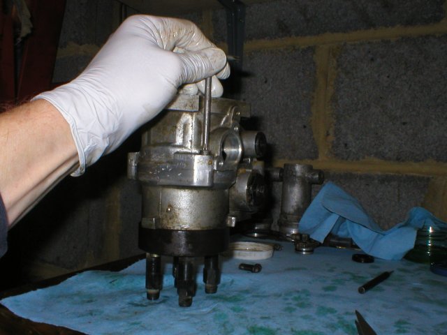

Next, stand the pump up on end so the HP delivery ports are resting on the bench as shown:
Gently and evenly loosen and remove the four Torx body screws.

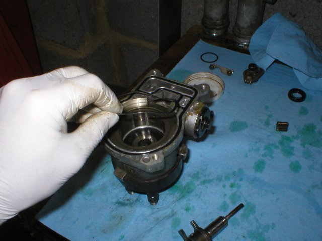

Carefully separate the two halves:

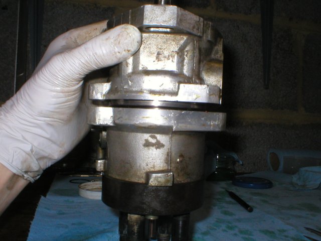

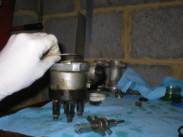

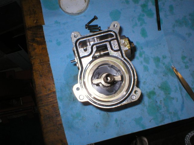

And lift the top away from the bottom. If you are lucky the pump plunger will stay put and you'll see this:
More likely though you'll find the plunger rises with the body and the ramp, rollers and pump elements will fly. Be ready to catch them!
Here you can see the body gasket.

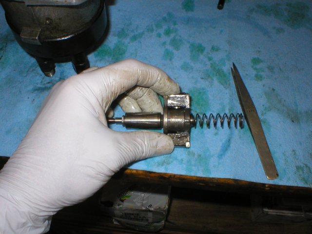

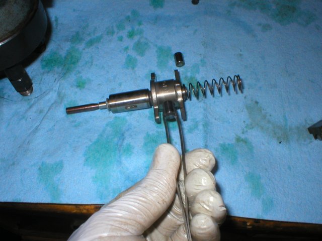

Lift the plunger, ramps and rollers out in one piece if you can. This is what it looks like:
Treat these parts very carefully as they are precision components.
The ramps and rollers will come away to reveal the pumping elements. these are the bits that actually pump the diesel to a high enough pressure to inject. They seem incredibly small for what they are!
Remove the big crinkly washer followed by the flat washer above the timing cam so they don't get lost.
Crinkly...
Flat...

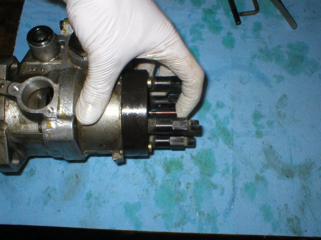

Now remove the iron distributor head (three Torx Screws) in readiness to replace the big O ring around it. Note the orientation of the head and the small O ring sealing the filling passage to it.
That completes disassembly. The next part is reassembly...
