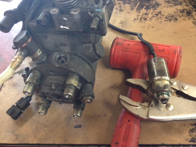

This is my mates 03 plate Berlingo, he turned up today and just out of interest i had a look to see if could see if the solenoid was the same as mine and look what i found!
He said if i can't find the right solenoid he'll pop back and i can take his out and see if there is a model number on it..

I'm going to get a pair of big mole grips and a dead blow hammer to hit them with..
D.

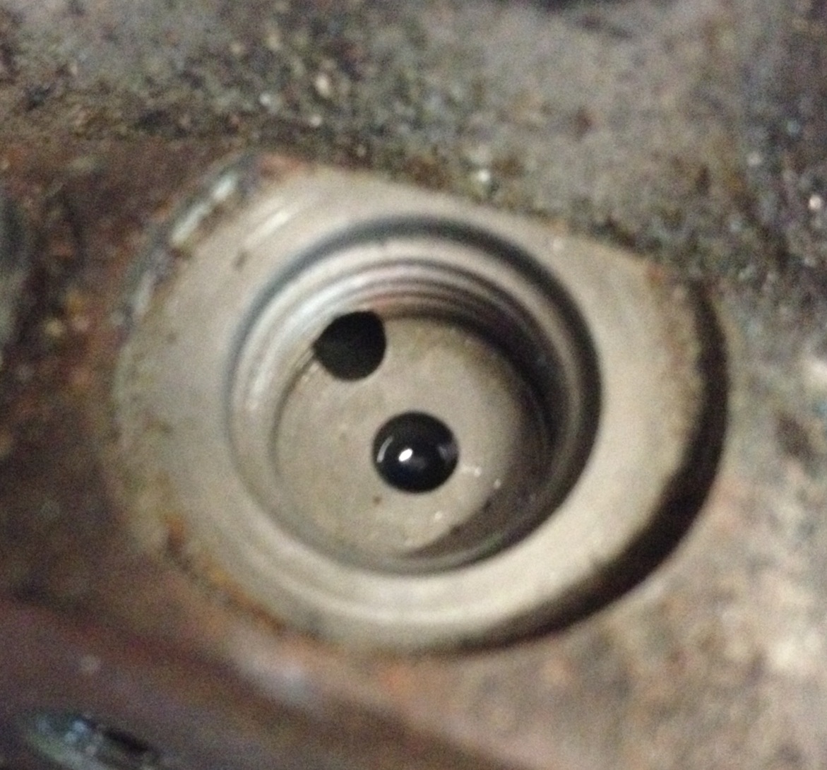

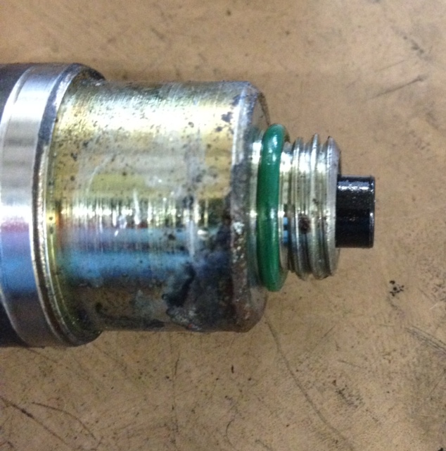

Here is some close ups of the hole and tip
The thread is M12 x 1.5, the solenoid has a rubber seal which is around 5mm long which just pulls off, so i'll build it back up now and post when shes running..

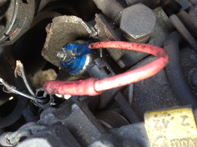

You can use in most cases one of the wires from that four pin plug, one will be an ignition supply to the module, I did this to mine. An alternative if you're really stuck in most cases is the reverse light switch feed as tis not too far away.

What I'm planing to do is pull out the fuse for the solenoid and hopefully one of those 12+ feeds will disappear, that's the ignition supply (well atleast acording to autodata!)..
Going to put a terminal on the wire and a rubber boot over the solenoid (http://www.ebay.co.uk/itm/170682119870) so it'll all look standard..

Funny you mention the solenoid boot I was looking for one for a Bosch solenoid a bit ago but could not find one then saw that MG one and thought that would be ideal, but never got around to getting one. I had to change the solenoid on mine as it did not have a thread, it relied on a cap which did not really stay in place without the armouring (I cable tied it in place for two days until I obtained a 'normal' solenoid) , as it looked a bit too small to risk trying to cut a thread into the 'nipple' , its been 100% since then.

What I did was once I'd found the wire out of the four with an ignition supply was to solder / heatshrink a ring terminal onto it, and cut the others short (at the plug more or less), and heatshrink them closed. It looks almost factory in a way.
