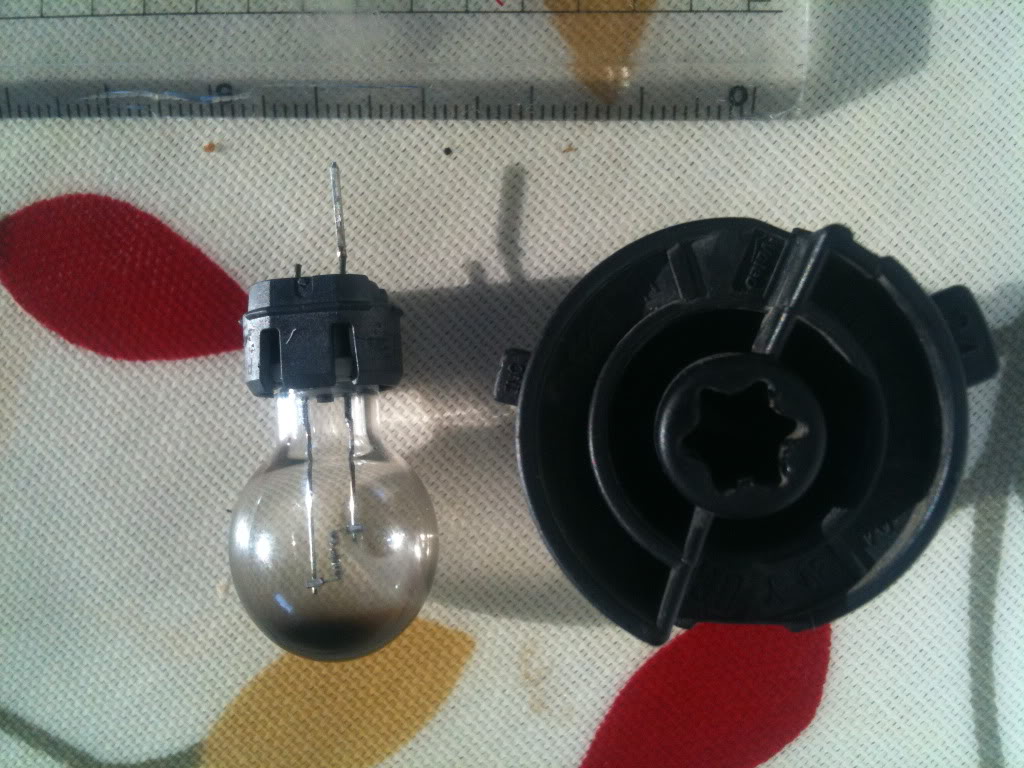

Thanks to birksy's tip I paid my 5 Euros and discovered that you can use a Torx bit in a small ratchet drive and undo the bulb and drop it out of the bottom of the headlamp assembly with a bit of wiggling as it has a rubber seal holding it in. Suffered a few scratches to the forearms-but nothing new there.
Another tip, if you drop the bulb-like I did with one-you can easily remove the foglight assembly to retrieve it.
But now comes the next issue-the bulb. I cannot find its equivalent. Citroen say you cannot remove it from its mount-yes you can. It might break a spur or two, but then you would only be doing it if the bulbs blown.
So can anyone identify the bulb used?
Of course what I didn't say was that I did this without removing the bumper, but accessed everything from the engine compartment.
- Posts: 48
- Joined: 20 Aug 2011, 12:58

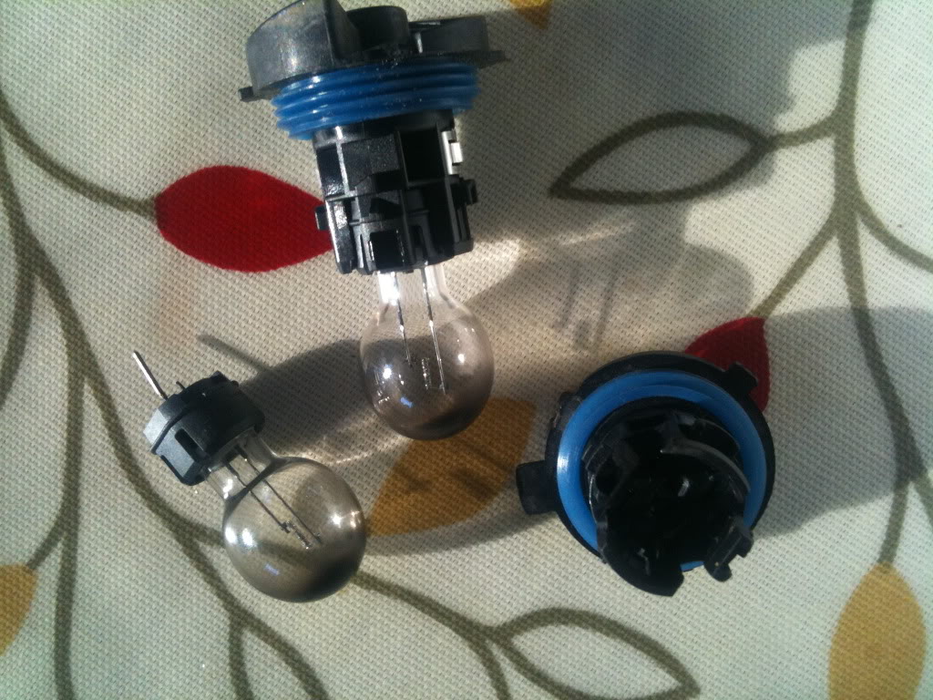

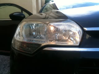

I think I have now sorted this.
The mount the original bulb came in is the same size as a G4 halogen lamp.
I managed to track down an LED G4 lamp with a claimed equivalent output of 20-25w costing £7.80 plus p&p from www.everled.co.uk. To my surprise the package arrived covered with a load of russian postage stamps! The total cost for the two bulbs was £19.60 compared to the £35 for one bulb from Citroen. Also an estimated life of 50,000 hours with an LED compared to what you can expect from a halogen.
This new bulb slotted in and appears to function perfectly. I have covered over 100 miles and they are still working fine. I had been concerned about them working loose.
The bulb on its own and mounted in the base and comparison pics between the new daylight running bulb and the sidelights are below.
