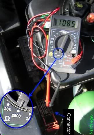

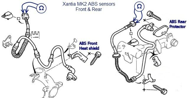

rasputyn, before 'butchering' the rear sensor, measure the resistance also from the ABS sensor connector (see pic below, similar in MK1 ).
You can remove front sensor in one piece, chances are ~ 50% but rear sensor chances are only ~ 5% :roll:

Measuring ABS sensor resistance:

Speaking from my experience (several experiments :wink: ),
actually it is not the distance but the speed.
With the new sensor static sensor reading might be fine
but it must also give healthy result when the the car goes
over the threshold speed. This critical speed is 20 km/h.
I guess the equivalent value can be seen in below pic:
