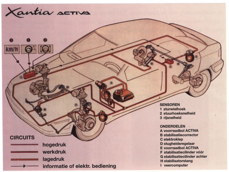

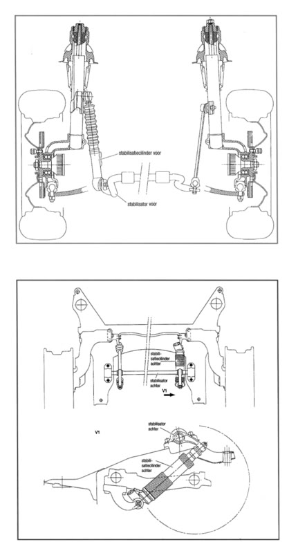

A picture speaks a 1000 words, so here's a few!
and overview links outlining suspension system:
http://www.ukcar.co.uk/features/tech/su ... activa.htm
http://www.citroen.mb.ca/citroen_quarte ... ctiva.html
Intersperse these among the text if you like Jim!!
It may be worth mentioning the context of what hydractive and the VSX
set up actually offers over the normal Xantia hydropneumatic suspension.
Andrew

andmcit wrote: It may be worth mentioning the context of what hydractive and the VSX
Andrew
Yes, good point. Hydractive suspension has two distinct modes of operation, hard and soft. Under normal running, the suspension will spend most of its time in soft mode if everything is working properly. The suspension will switch to hard mode under certain conditions. These include hard braking, hard accelleration, hard cornering and any time the suspension feels it is about to bottom out. A myriad of sensors determin conditions and theses feed into an ECU that makes the decision when to switch. Sensors include speed, rate of change of stering angle, brake pressure, throttle position and yaw. A Hydractive car is very soft and comfy when in soft mode but will switch to hard mode in an instant when the aforesaid conditions happen. It will switch back to soft just as quickly. In practice you really don't feel it happening.
All Hydractive cars have a normal/sport switch down by the height lever in MK1s and on the dash on MK2s. This switch simply changes the thresholds at which the suspension switches from soft to hard and back again. In sport mode, the suspension will switch much more readily and even on an Activa it sharpens the handling somewhat.
The hard/soft ride is achieved by switching an additional sphere in and out of circuit, both back and front, called the Hydractive Centre Sphere. This sphere handles the soft side of things and is hydraulically switched into circuit by an electrovale under control of the Hydractive ECU. In hard mode, the sphere is switched out and suspension stiffness is then determined by the suspension corner spheres alone. These are much harder than normal corner spheres.
An Activa has two more spheres, the Activa Accumulator and Activa Balancing Sphere. The Accumulator supplies a reserve of pressure for the Activa roll correction rams whilst the balancing sphere acts as a spring between the front and rear rams and provides some "give" in the otherwise very stiff anti roll bars. The balancing sphere is switched in and out under ECU control to provide either soft or hard roll correction and switches modes under much the same circumstances as the hydractive system.
For a more in-depth description of the Hydractive and the Activa system, Have a look at the Citroen Technical Guide.

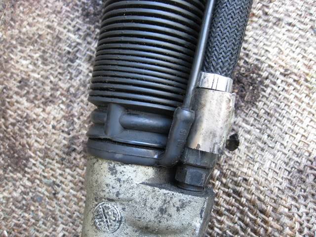

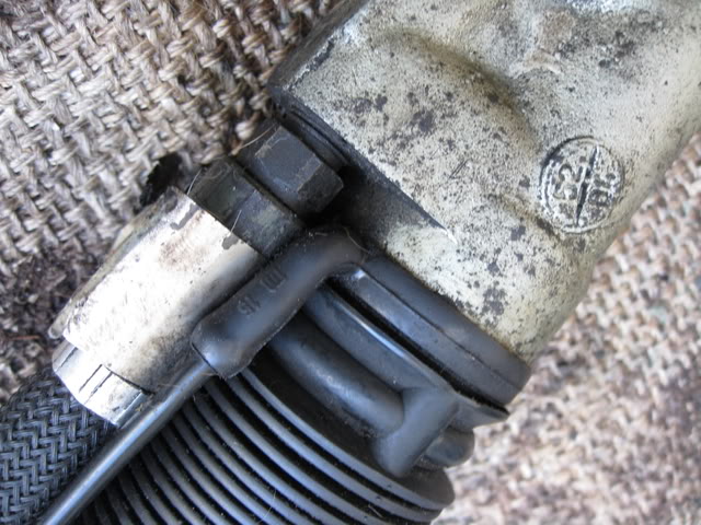

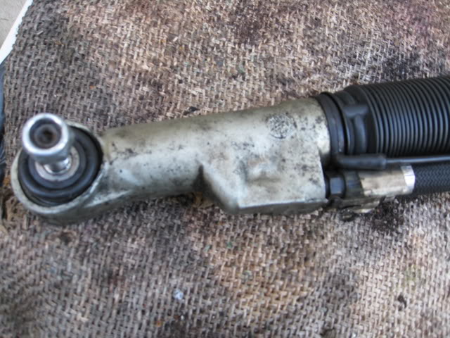

Just found these of a relatively new front ram I had which show the vulnerable
leak off pipe that normally fails causing MOT and LHM hassles:
Helps visualise to someone new to Activae what may be wrong and leaking on
their new/prospective purchase!
Andrew
Posts: 52987
x 7323
Thanks Andrew :D Brilliant!
