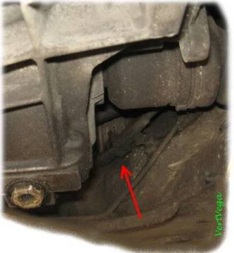

Another point, before removing (or throwing away) the sensor you can measure from the sensor connector (see pic).
I have sent this picture before in another thread. It is from front left side.
Right side is "almost" mirror image of this :) .
PS: my meter shows value 1 for open circuit. may be different standards(?)
Value "1" (on the left most side) is also seen when meter is switched to Resistance mode.
Touching probes to each other, display value settles down to "000".
