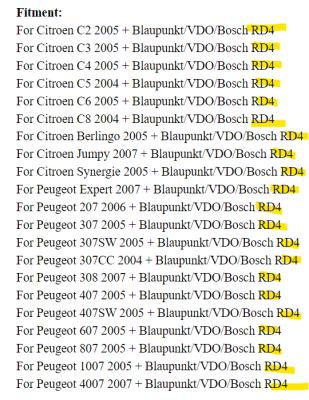

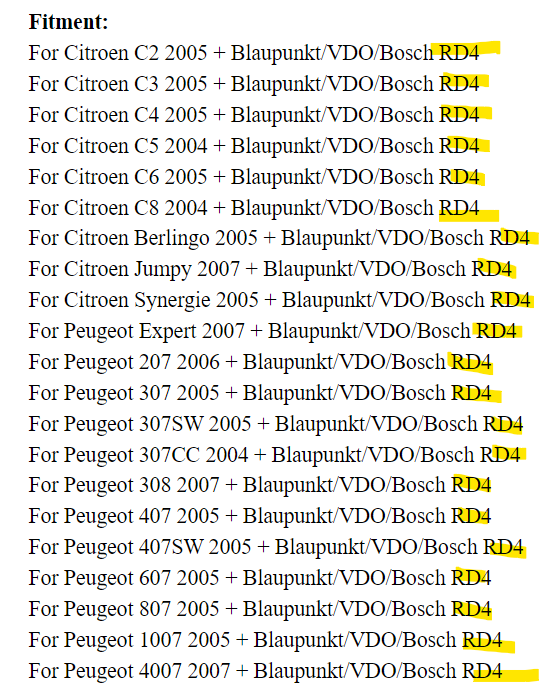

No, because that is only for RD4 systems (basic units), and you have a full telematics system.

Looking at the advert it only mentions music and not phone calls.pajeffery wrote: 01 May 2024, 02:46My main aim is to get Bluetooth so I can listen to music and talk on the phone.
Would this be a simpler alternative: https://www.ebay.co.uk/itm/314150740640 ... media=COPY
- Posts: 42019
- x 6955
Re: Peugeot 206 (2004) replace radio
That just won't work on RT3 Paul.

What won't work? I'm pointing out that the advert doesn't mention phone calls, only music.
- Posts: 42019
- x 6955
That interface won't work - it's for RD4 systems, not RT3 so what is supports is irrelevant, which is what I said in my first response....Paul-R wrote: 01 May 2024, 12:22 What won't work? I'm pointing out that the advert doesn't mention phone calls, only music.
I'm trying to avoid the OP wasting time on things that are not even compatible.
