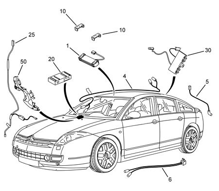

Ok, so here's what I have on the system James:
Aerial diagram
(1) Radio Aerial
(4) Aerial Cable
(5) Aerial Cable
(6) Aerial Cable
(20) Aerial Switching Unit
(25) Filter for Aerial
(30) Impedance Adaptor

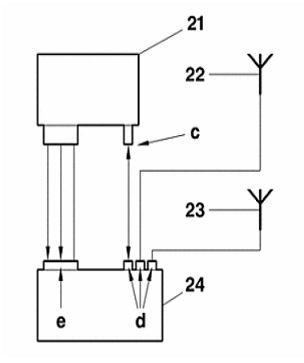

This is the 'FUBA' Diversity Unit
(21) RT3 audio/telephone.
(22) FM2 radio aerial.
(23) FM1/AM radio aerial.
(24) Diversity unit.
(c) ISO connector.
(d) FAKRA connector.
(e) 3-way yellow MQS connector.
The diversity unit is used mainly by the twin tuner function.
The diversity unit makes it possible to obtain a better quality of reception via the intermediary of two radio aerials:
  • The second aerial continuously searches for a better reception frequency than that received by the first aerial
  • The diversity unit selects the best frequency and transfers it to the RT3 radiotelephone

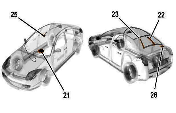

The diversity unit is located under the glove box (left hand drive vehicle).
The diversity unit is located behind the glove box (right hand drive vehicle).
(25) Dual-function aerial (GSM/GPS) located near the dual-function rain and brightness sensor.

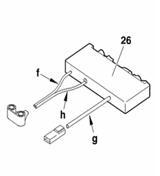

(26) Radio aerial adaptor.
