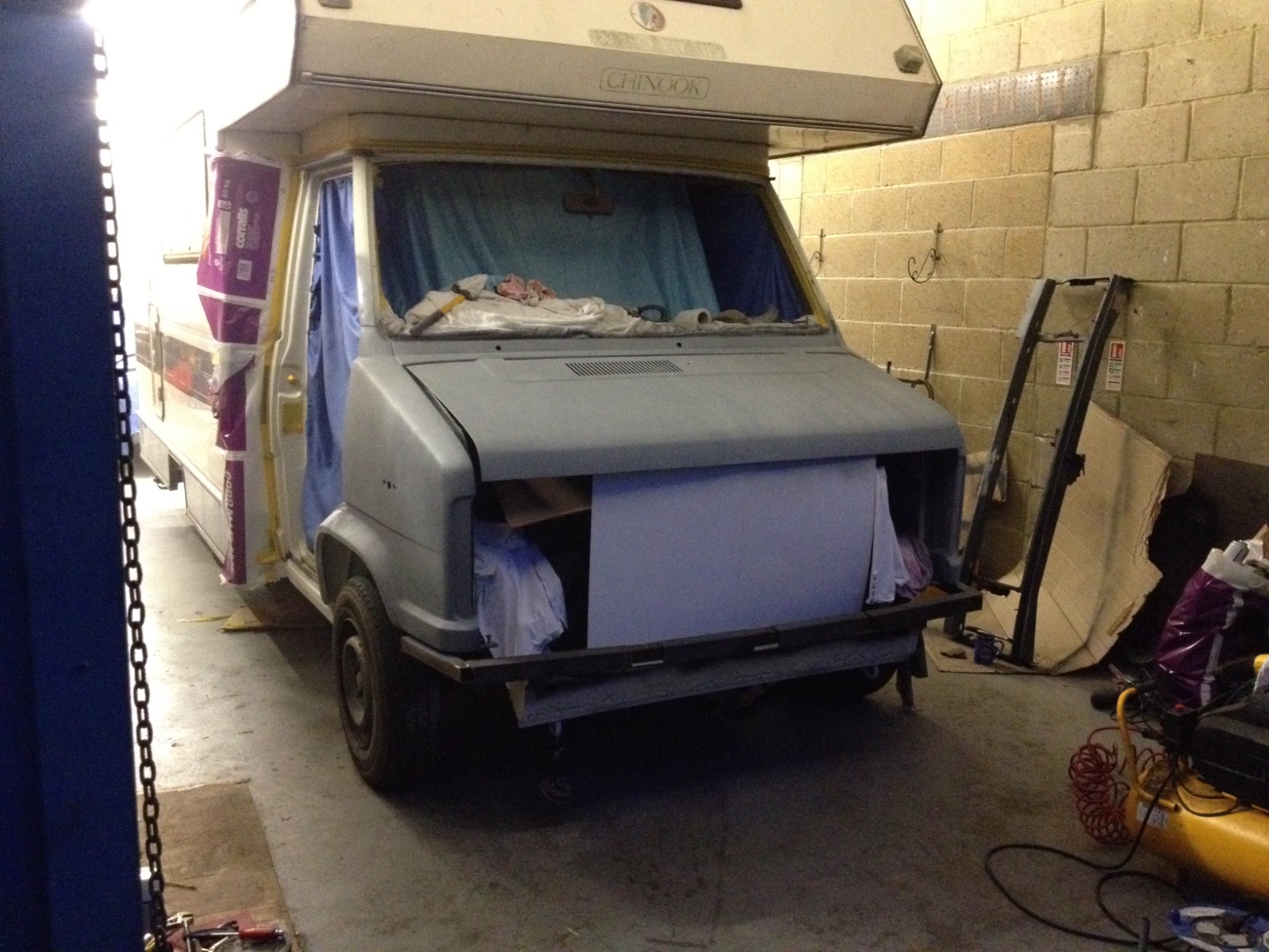

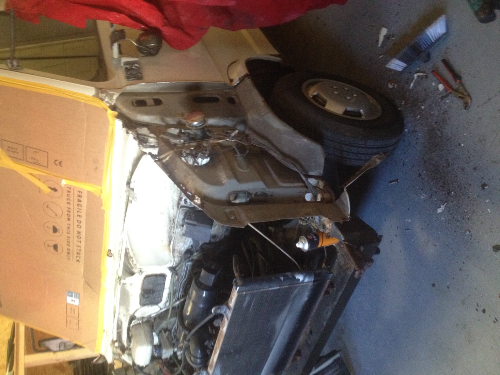

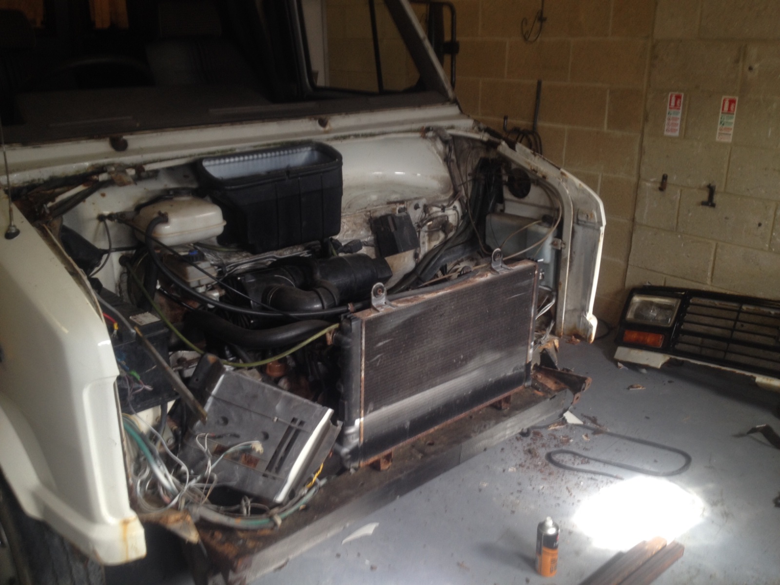

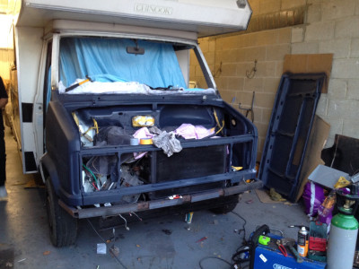

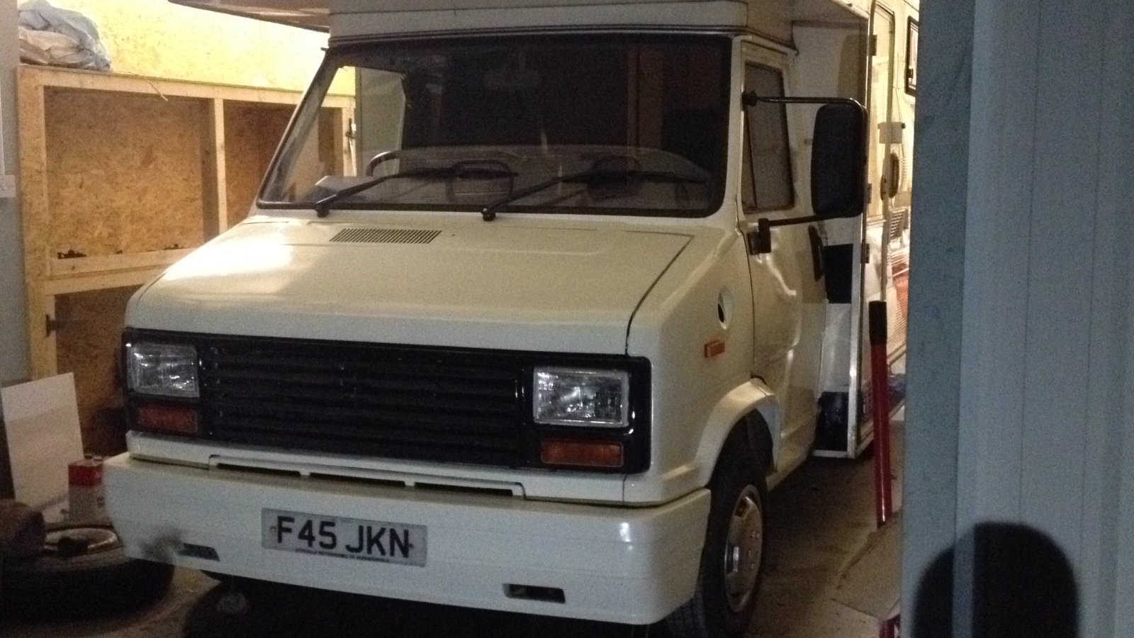

After a great deal of welding, parts, painting and labouring the dampervan has been returned to her former glory...
XM Prestige PRV6 92

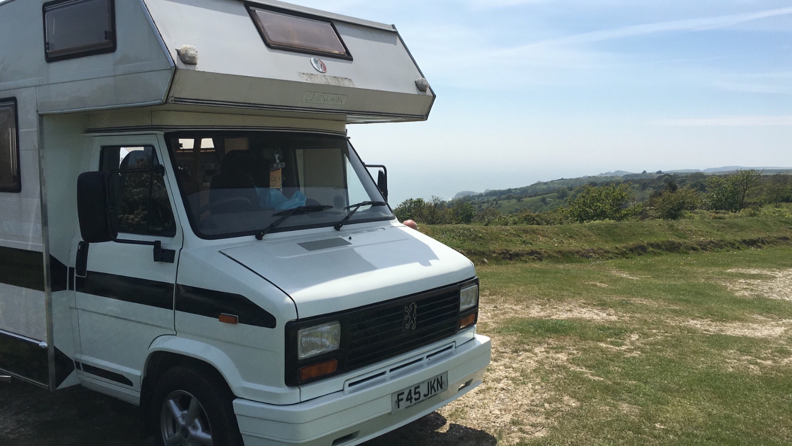

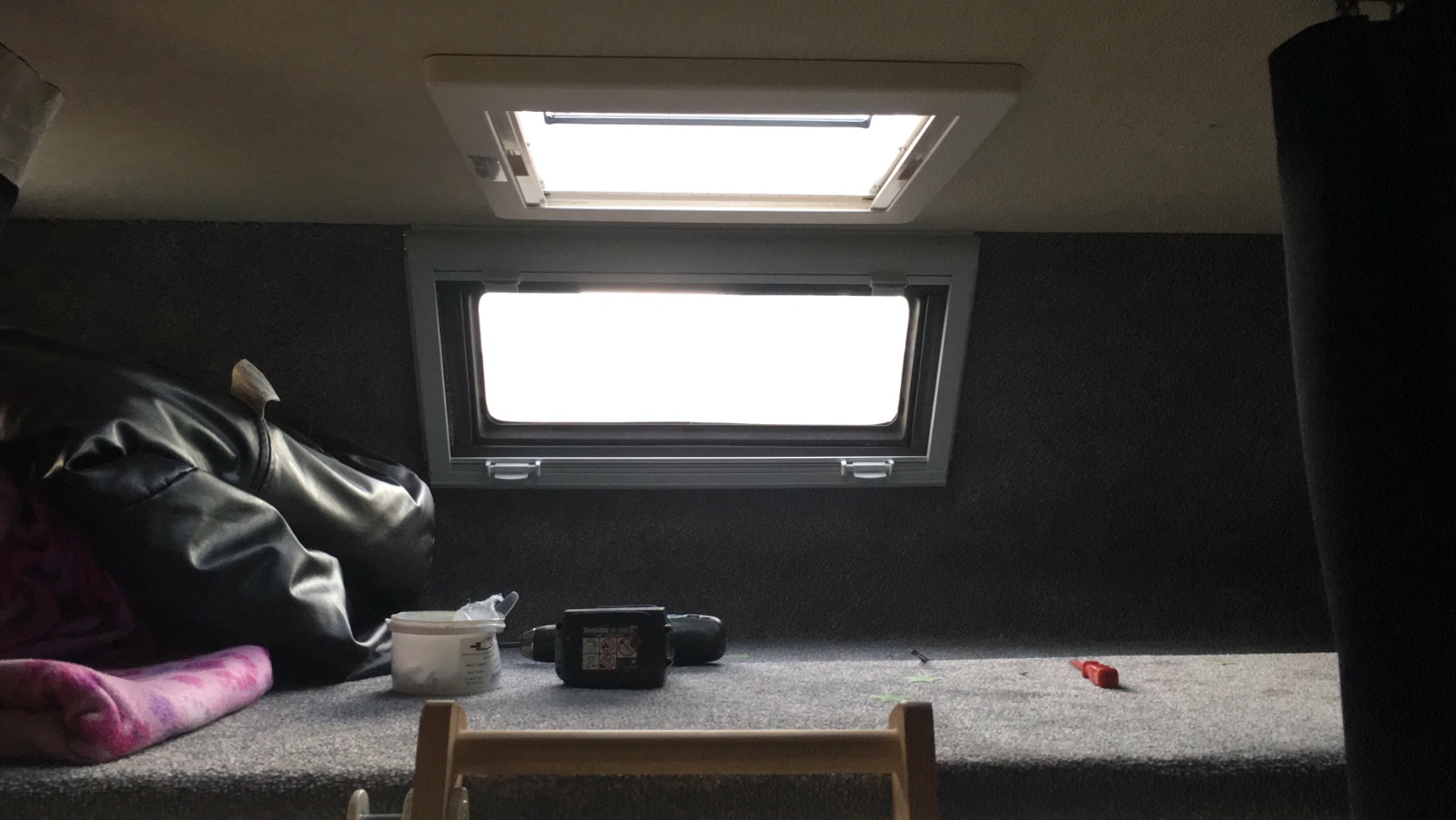

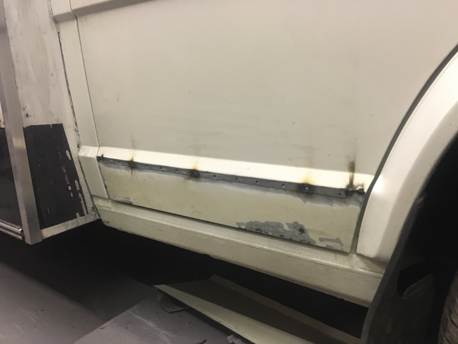

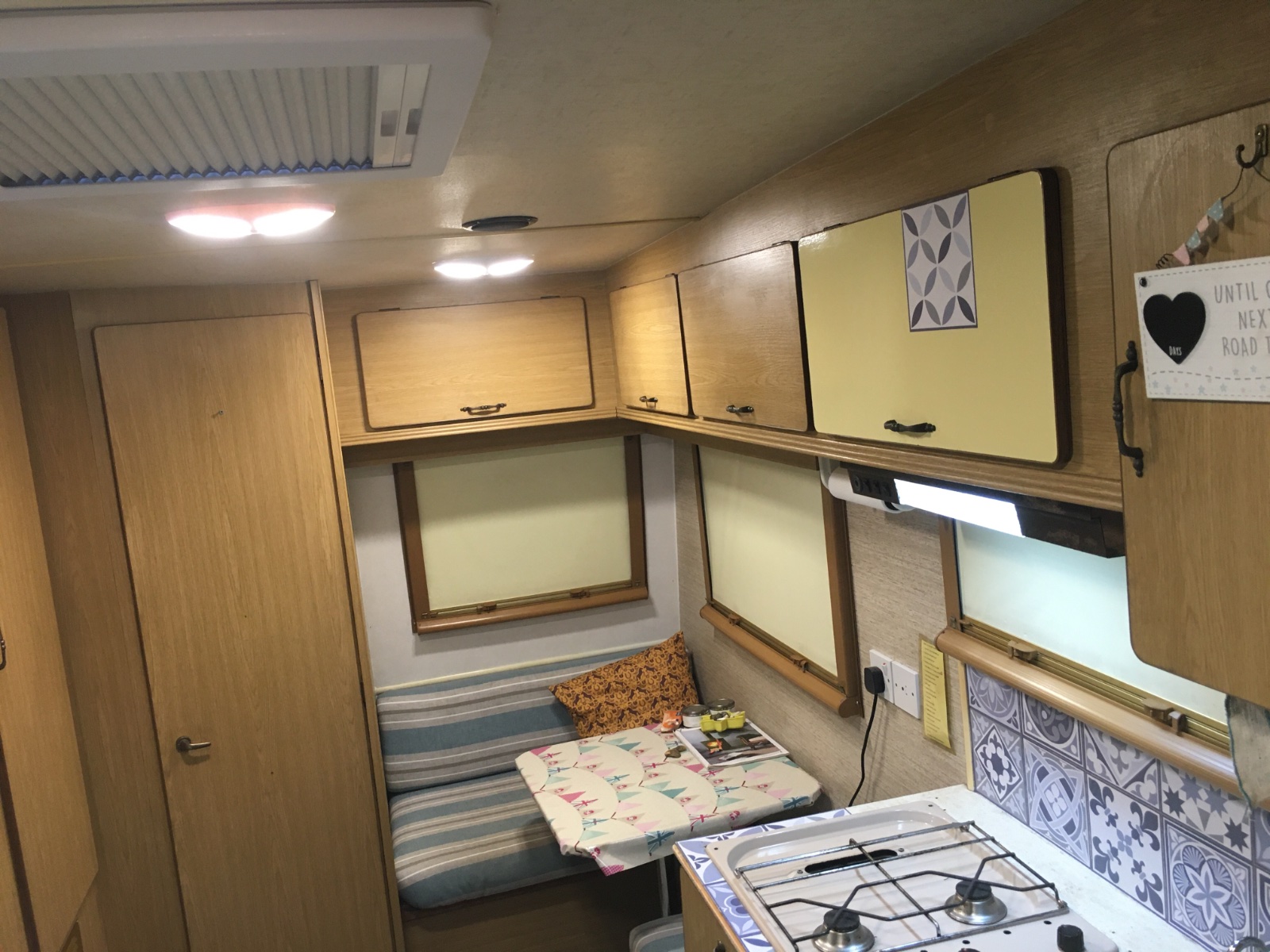

The XM is still happy and used regularly apart from the heater blower resistors that packed up this weekend. The Talbot is still with me and has just undergone a stage 3 spruce up with new door bottoms welded In, panel seams smoothed out, bitumen insulation added (huge difference in road/wind noise), new roof lights, led lighting and Dynax cavity wax (definitely closing the gate after the horse has bolted).
They are both, surprisingly (touch wood) very reliable and the old camper is damn near indestructible, something it arrived with broken gets fixed, and it stays fixed, nothing short of a miracle, anyway, gratuitous photo’s just because.
