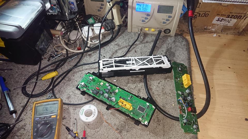

So the next job on the agenda, is to tackle the faulty speedo, this has completely failed, it's totally blank. I understand they are prone to a couple of blown resistors and some potential dry joints........ lucky a fellow Citroenist has repaired a few of these and will be getting this job too..........

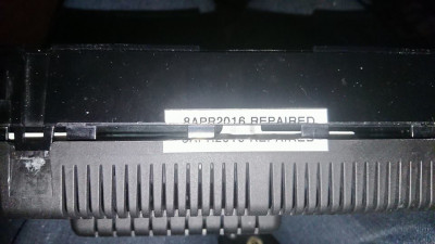

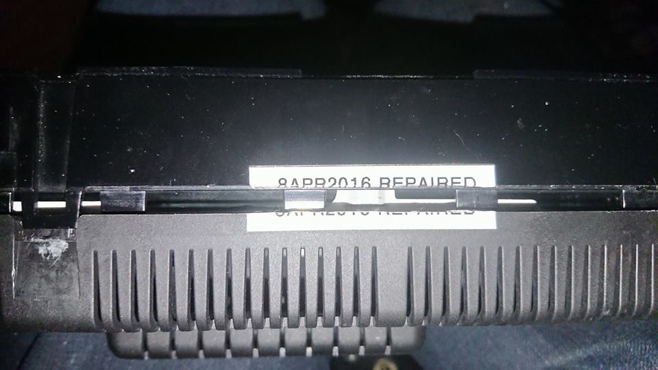

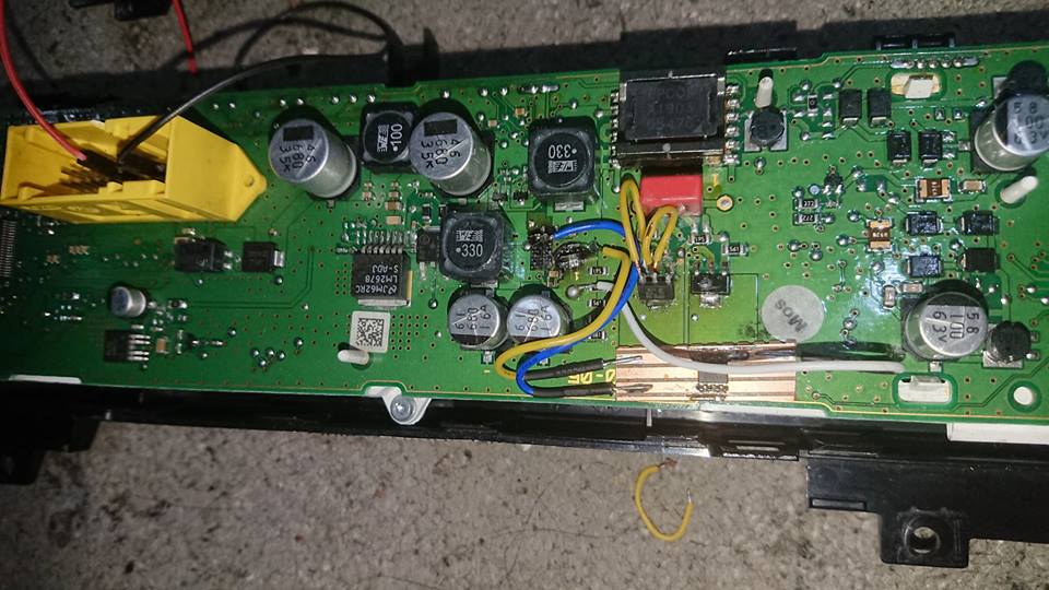

I've been without the C6 for a couple of months due to a fault on the speedometer, basically it stopped working, I sent it away to be repaired, and was told that there was an intermittant fault with the CPU (the display). I was told if I could get my hands on another unit the CPU could be swapped over and my speedo could be up and running.
This turned out be a mammoth task........... I managed to acquire another speedo, however, it was down on the east coast, luckily the chap was heading up to Morecambe where I duly collected it and sent it off to Somerset to be utilised as a donor, this turned out to not be the case as the CPU is not compatible with my speedo........ the CPU is different.......

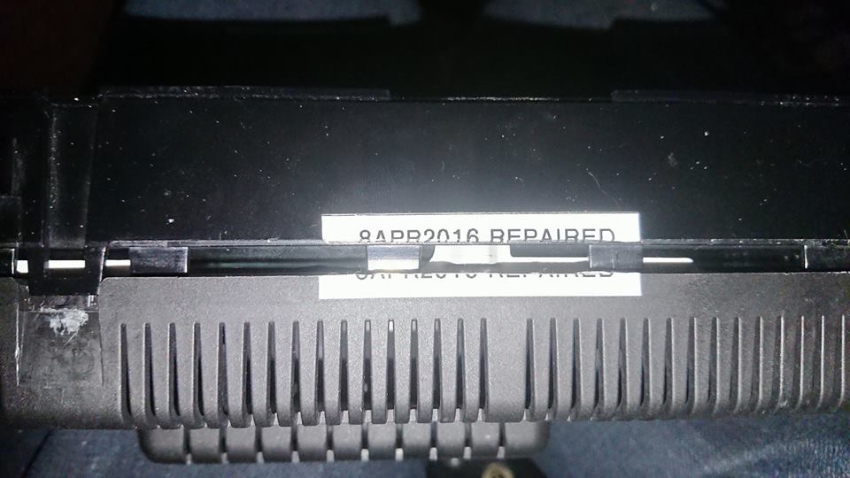

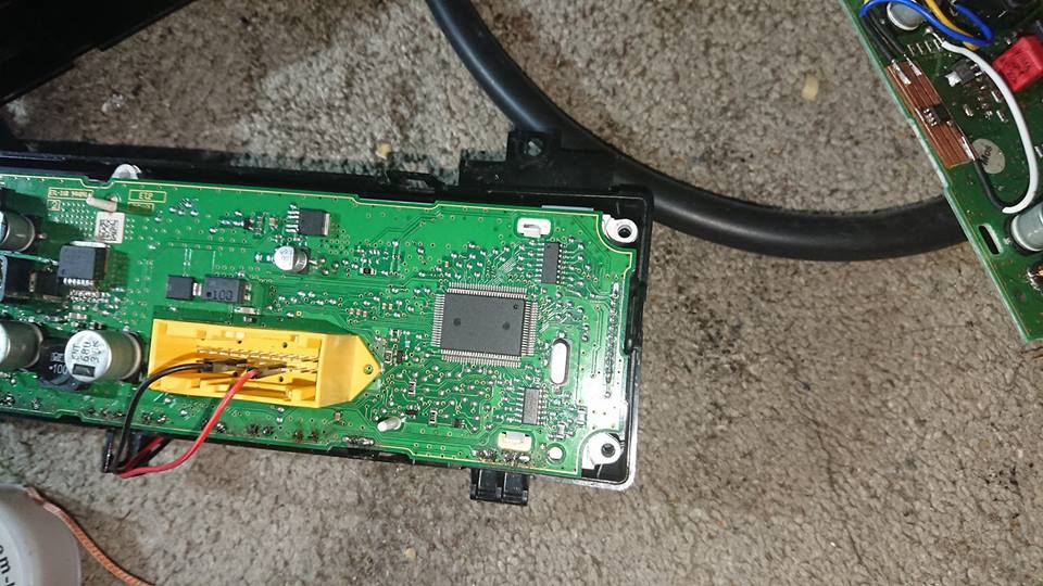

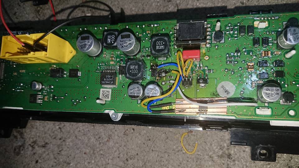

It did throw up the quality of 'proffessional repairs' though......... The top two pictures show what the back of the speedometer should look like.....
The bottom two pictures show the "repair" that had been carried out by somebody, prior to Robin acquiring his car. {rant!
So at the moment I'm still without the C6, although it can be driven with just the Heads Up Display........... oh and before you ask........ a new speedo is £900

Those repairs don't look good at all Steve...
Shame the parts from both cannot be used to make one good one...

Hell Razor5543 wrote: 26 Oct 2017, 18:29 I wonder if the CPU is a custom chip. If it is not, my first step would be to contact the chip manufacturers to see if they can help.
The company who make the CPU are BORG, and it seems, well known for not supplying replacement parts.....
CitroJim wrote: 26 Oct 2017, 18:25
That was the original plan, alas BORG changed some of the componant's and there not compatable with each other now.........
