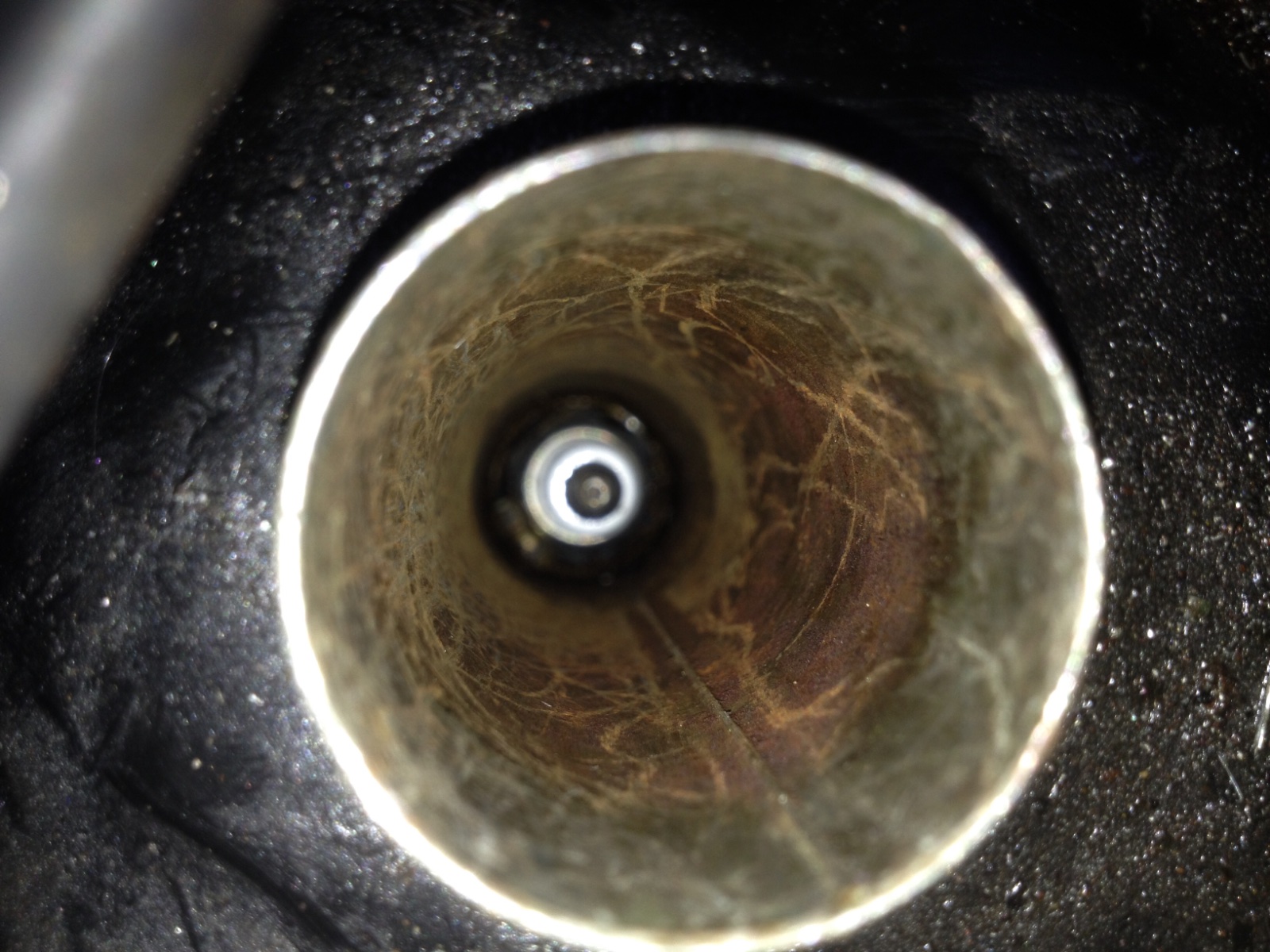

Had another look today and tried to get the other three plugs out, one however had the top snapped off it and I'm not sure how......
Fitted a new plug and had a play with the carb and surprisingly with ignition on all 4 cylinders it idles well but I've not driven it yet, I suspect there will still be lean issues.

Colour of plugs after a bit of driving should tell.
That is a very strange photo...

The plug wells are very deep, I had to take the air filter off and the heater cowling out to get access to look down, the threaded section with the little screw on nipple had snapped off and fallen down the side of the plug so I couldn't get the plug spanner in, good job really as if it didn't I would of taken the plug out and the nipple would have fallen into the cylinder which would of been fun!
I still think it's running lean, fuel pump delivery looks ok, I'm getting 6psi pressure and the fuel pulses out ok but I do get the fuel running back to the tank after sitting for a week so it could be a dodgy non return element in the pump.
