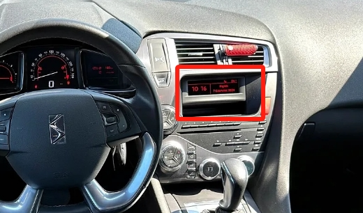

hezhouxin0714
- Posts: 8
- Joined: 01 Jul 2024, 09:20
Re: RT6 to NAC (Connected NAV) Upgrade
@MacSlavko
Really thanks for all information.
But I am not a pro-engineer, so still confused about something.
My DS5 2013 was installed RD45( I think it`s RD45, orange light with small monitor)
My purpose is [CarPlay]
What you need is:
a) NAC Wave2: 9821908880 (analog); 9821908980 (DAB+),
b) capacitive 7" touchscreen: Continental EMF DGT7C 9813041280; or multi-touch (3 finger gesture) 9825031680,
c) cable adapters (AliExpress),
d) telecoding your VIN (by seller with Arduino tool or by dealrship and DiagBox) so it doesn't beep at you every second.
For Item a): what`s the difference between "9821908880"&"9821908980"? For Carplay, both of them are suitable or should be "9821908980"
For Item b): For Carplay, should be "multi-touch (3 finger gesture) 9825031680"?
If you can help answer me, that`s really great!
Thanks.
What you need is:
Thanks.
MacSlavko
- Posts: 132
- Joined: 17 Aug 2017, 23:39
- x 32
1: You will have CarPlay and AndroidAuto with both 9821908880 and 9821908980. Only difference is that the later one 9821908980 is equipped with DAB+ (that’d be my choice),
2: CarPlay will work on any DGT7C (capacitive) touchscreen you’ll be able to find. 3 finger gestures is just a welcomed convenience if you come across it, but not necessary for either NAC or CarPlay to work.
PS: when searching for NAC make sure the seller provides you with donor car VIN so you can update it via dedicated PC/Mac app or have Connected Services subscription…
Also, mind that you’ll need different Fmux panel (fascia) to accommodate bigger screen that replaces tour old (orange) one...
hezhouxin0714
- Posts: 8
MacSlavko wrote: 01 Jul 2024, 10:19 1: You will have CarPlay and AndroidAuto with both 9821908880 and 9821908980. Only difference is that the later one 9821908980 is equipped with DAB+ (that’d be my choice),
Thanks for your professional reply.
[Also, mind that you’ll need different Fmux panel (fascia) to accommodate bigger screen that replaces tour old (orange) one...]
For this one, what you mean is, if I upgrade to a new screen, it would be bigger than the original frame?
MacSlavko
- Posts: 132
- x 32
Yes. New touchscreen that you'll need with NAC is 8" (about the size you've marked in red) and it takes up the space for small items underneath your current orange screen.
It's reference nuber is 98102714ZD and you can find it all explained on page 4 of this thread.
Another friendly advice; keep those air refresheners in side air vents (if this is your picture) as they tend to leak chemicals and that kills the touchscreen...
hezhouxin0714
- Posts: 8
Thanks for your reminding.
The pic I posted is not mine.
So that means:
NAC Wave2:9821908980 (DAB+)
Contral Panel:98102714ZD
Cable adapters
Telecoding the donate VIN
Then perfect CarPlay, right?
So that means:
Cable adapters
MacSlavko
- Posts: 132
- x 32
Yes, that´s about right!
