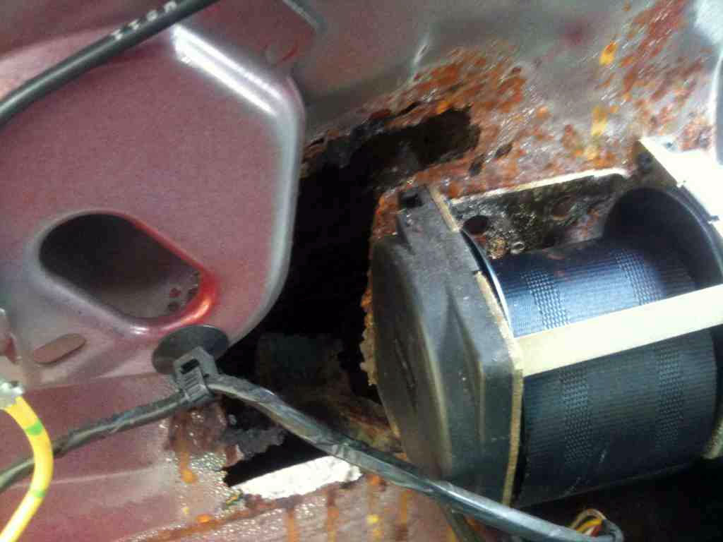

These days I read many things about rusty 306 (mostly phase 1) and tomorrow I am going to check for rust ..I I read usually there is rust at rear belts mechanisms. Are there any other places to check for rust specially inside but and outside )?
spider
Posts: 3949
Joined: 05 Jan 2010, 14:28
x 77
Re: Peugeot 306 keys
Unread post by spider »
mixalis kal wrote:These days I read many things about rusty 306 (mostly phase 1) and tomorrow I am going to check for rust ..I I read usually there is rust at rear belts mechanisms. Are there any other places to check for rust specially inside but and outside )?
MK1 can suffer a bit around the rear inner wing area (where the seat belt lower mounting is) , I think you may find its the right hand side of your's (right hand inner lower wing) that suffers more as your car is LHD. RHD cars it is the left hand side usually.
The reason is this 'side' is sat in the kerb and gets more road spray on it.
Later and MK2 models do not have this to the same degree as they have the plastic 'mud shield' fitted inside the wheel arch.
To be honest, the rust proofing of these is very very good. Rust can mean repaired accident damage in some cases. I've only seen one with rotten sills (under drivers door/front wing edge)
Andy.

The only place I could find rust is there?
(I found the photo on the Internet )
Is there any other place where I could find rust inside the car ?
I have some pics which I will send you (one my phone ) that shows rust at the rear breaks (behind the wheels) . Do you think that it is a problem?
spider
Posts: 3949
x 77
I think that is the normal place if they start to go.
I'm not really sure where else they might rust (front of sill under drivers door maybe in bad cases) , I've not seen any old 306's for a while now...
