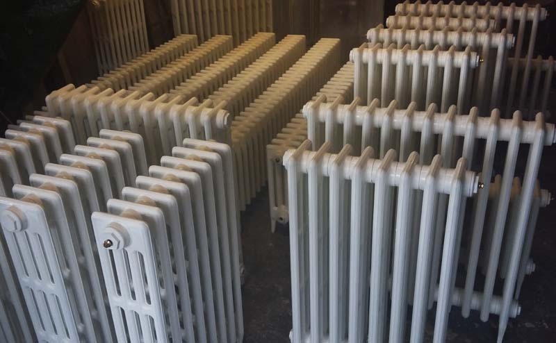

I may be able to check this tomorrow...swamped with this crap at the moment

Stickyfinger wrote:I may be able to check this tomorrow...swamped with this crap at the moment
That's a good haul of rads. I can feel the warmth from here :)
