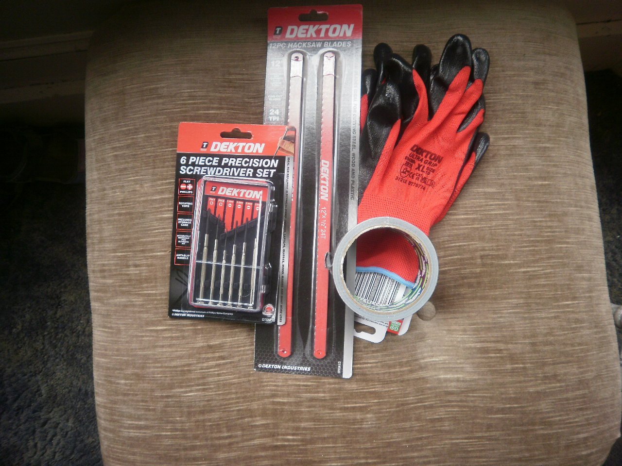

Visit to the Recycling Centre and Yorkshire Trading. Spent about £6 and came away with...
Never mind the quality feel the width!

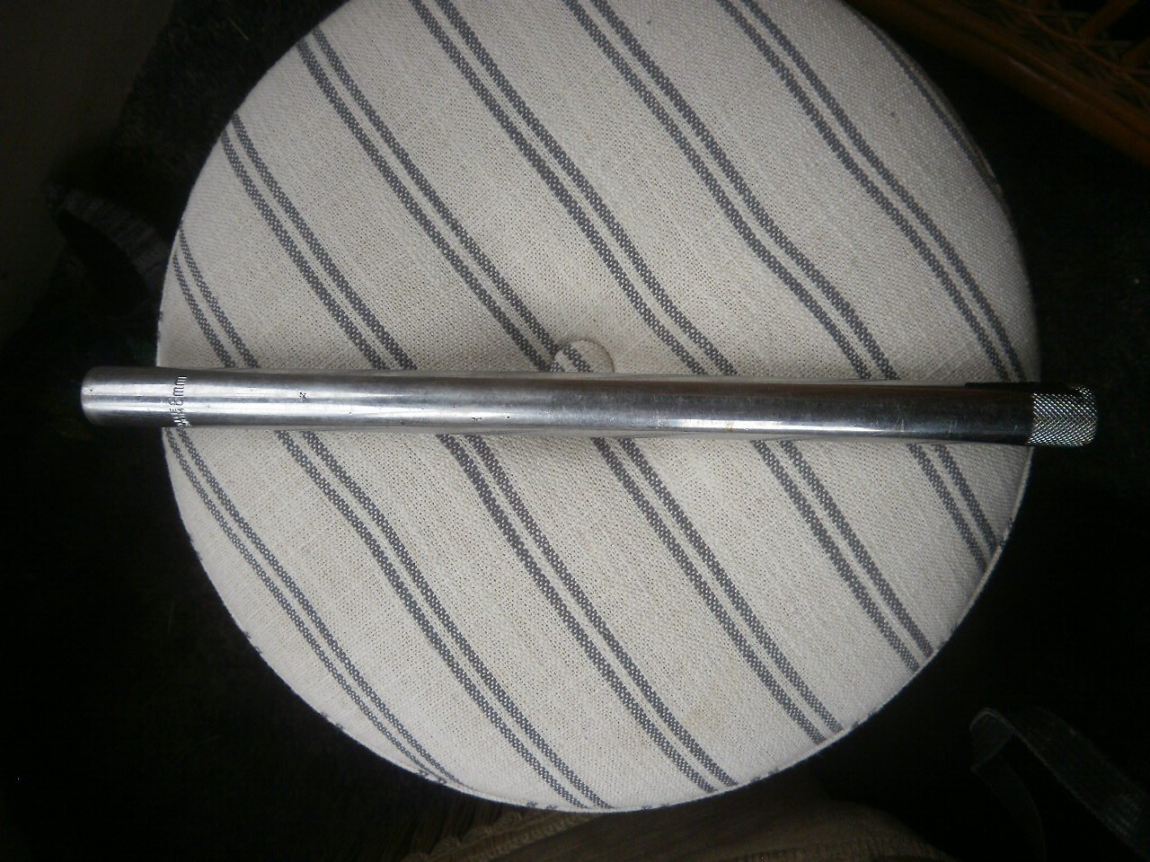

The BBClio, being the workhorse of the fleet had been sitting filled up with stuff for the tip since last week. I had also searched high and low for this long specialist thin tube spark plug socket for the deep seated spark plugs on the Clio D4F engine. Almost given up and resigned to getting a replacement when the trip to the tip came up trumps. Once the rubbish had been moved out there it was poking out from under the drivers seat!
Once was lost but now is found!

Wow that is long / deep!

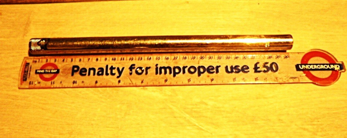

MattBLancs wrote: 16 Mar 2026, 20:19 Wow that is long / deep!
Just for you Matt I measured it!
12" 300mm ish  Clio Spark Plug Socket

Looks like that will cost you £50 Neil 🤠

Getting on for vintage now that flexible "ruler". Must have been in the 1980's when I brought that back from the London Transport Museum Shop.
