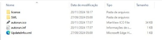

@GiveMeABreak there is a risk that some of these updates (Firmware 21.08.90.52_NAC-r0, Staino Licence File) may render the system inoperable? ...........Can you send me updated GPS maps?.......folder created with the files are they correct?

You should not have those ICO and INF files on the USB.
No it won't render the system inoperable - but it may not install if the certificates are out of date.
1) You need to remove the 2 files above from the USB.
2) Why have you installed files on separate dates? This is going to cause a problem as I suspect you are mixing firmware and Licence updates!
You have a licence file folder created 20th November and a SWL folder created 27th September! Do not mix updates and licences.
You should use the same files I have provided, which should create folders the same day. Expect problems if you are not following guidance.

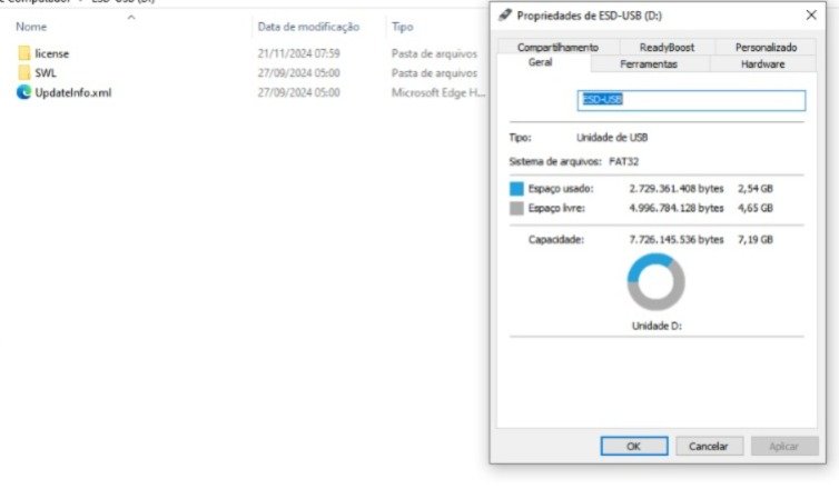

when I create the license folder and put the file in it, the folder is created on 11/21, today's date
Posts: 42019
x 6917
Re: PSA NAC RCC Updates
Yes, but what about the SWL folder? That is showing September.......
You really need to reformat the USB in FAT 32 again and extract the files I sent you in the link using the latest version of 7Zip. Then licence file folder looks OK.

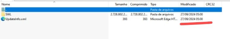

Marc, I did everything you said, the folder shows the date 11/21, 99% of completion updateInfo.xml changes to 09/27/2024. 7-Zip Installer latest version....If you can check what is happening, thank you.

GiveMeABreak wrote: 21 Nov 2024, 11:43 Yes, but what about the SWL folder? That is showing September.......
Good morning Mark
I formatted fat32 using Rufus latest version
I unzipped using 7z latest version
When unzipping the UpdateInfo.xml file the date is changed to 09/27/2024.
If you can test it I would appreciate it.

Ok, so the archive utility is maintaining the original file creation timestamps - that's ok then, as I thought at first you may be using different versions.
So if you have cleared away those other files I mentioned, disconnected the batter y for 5 minutes or so using the BSI Reset / Battery Disconnect / Reconnect Procedure, then there may still have an issue with certificates that are buried elsewhere in the files and not obvious - there are a lot of files in the firmware archive. If this still doesn't work, you nay just have to wait and see if they provide a certificate update if this is the case. There's no loss really, as long as the system works, don't worry about it, just update the maps (V28 should be out soon for Wave 2).

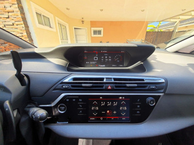

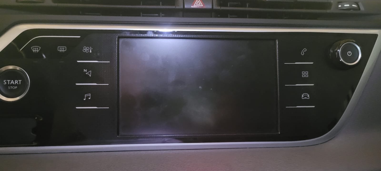

When I save my cell phone contacts, personal settings, wifi and bluetooth in my personal profile, it gives a bug and keeps restarting and I lose everything saved in the profile... do you think I should restore the factory settings, and then update the maps?

So you need to be aware that you may have in internal storage problem if it's refusing to save data - flash memory doesn't last forever. But a factory reset will lose all your personal audio and settings, you'll just have to spend a bit of time setting them up again.
