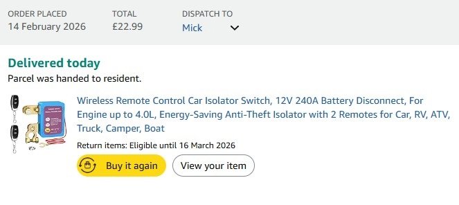

This morning I thought I'd take the MX3 out for a run in view of the sunshine so I was a bit choked when I got in and discovered a completely flat battery. That is the fourth time it has happened, bear in mind I only use it once a month or so, since I installed a new Yuasa battery in September so I decided that it was obviously suffering from too little use in general so I decided to take action. I took the car into the garage and connected my full power charger at 12.00 and thought I'd give it six hours. I came indoors and the idea of fitting a battery isolator as I used to have on the rally cars came to me. That way with a decent charge and isolated while sitting outside the battery should give the service I expect next time I jump in.
So I set about finding a suitable isolator on ebay and did for £21.99 but before I ordered it with 3-4 days delivery I checked on Amazon to find exactly the same unit for £22.99 but delivered today!! No brainer I thought, I'll leave the car on charge until it arrives and then fit it before taking the car outside again to allow SWMBO to put her car to bed. Well it did say delivery between 7 and 10pm so I hoped it would be here around 8 but in fact it arrived at 9.10, so I have just finished fitting it and putting the MX3 outside, installing its cover and then clearing the garage and putting SWMBO's car away.
So obviously I tested it and it seems to do exactly as it says, it is operated by a remote fob, I have a pair, which I can take away with me making it an extra immobiliser so I will be interested to see how the battery is on the next test in a few weeks!!
I must admit I have only had these problems since I fitted the new all singing and dancing entertainment system so I believe that may have been draining the battery. The downside is that now when I get in and actuate the system the stored radio stations and bluetooth setup will need refreshing each time but that doesn't bother me as I only use AM and one station!! This is the unit I have put in:
