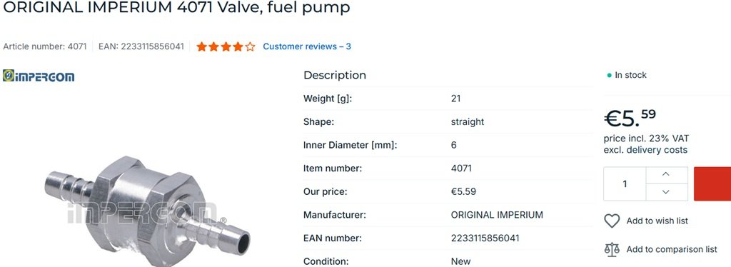

If the problem is on the fuel side as I suspect, the trail starts at the tank.
The pump is inside the tank, that pump is responsible for pressurising the fuel. This component is described by the oracle that is autodoc as the fuel pump valve/fuel pressure regulator. A cheap as chips bit and they carry them as spares so presumably from time to time they fail.

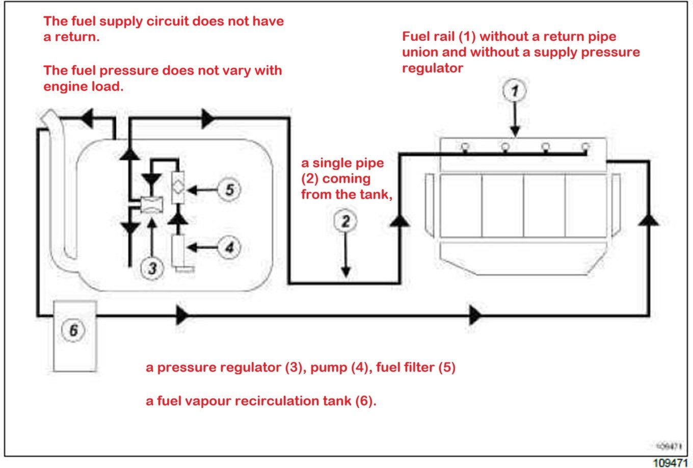

Much as a wordy description can be useful there is nothing like a picture or a diagram for a bit of clarity. of the nitty gritty.
Click and it gets bigger!
I think due to its positioning that what was previously described as a Fuel Filter External to the tank and slung underneath the clio at the rear is decribed on the diagram as a fuel vapour recirculation tank.
- Posts: 20344
- x 7860
Re: Falcon's Bargain Basement Motoring
A useful diagram Neil, I still wonder if my earlier suggestion may be a possibility re intermittant loss of fuel pressure. A pinhole in the vapour pipe may also cause an occasional blip in manifold/rail pressure?
