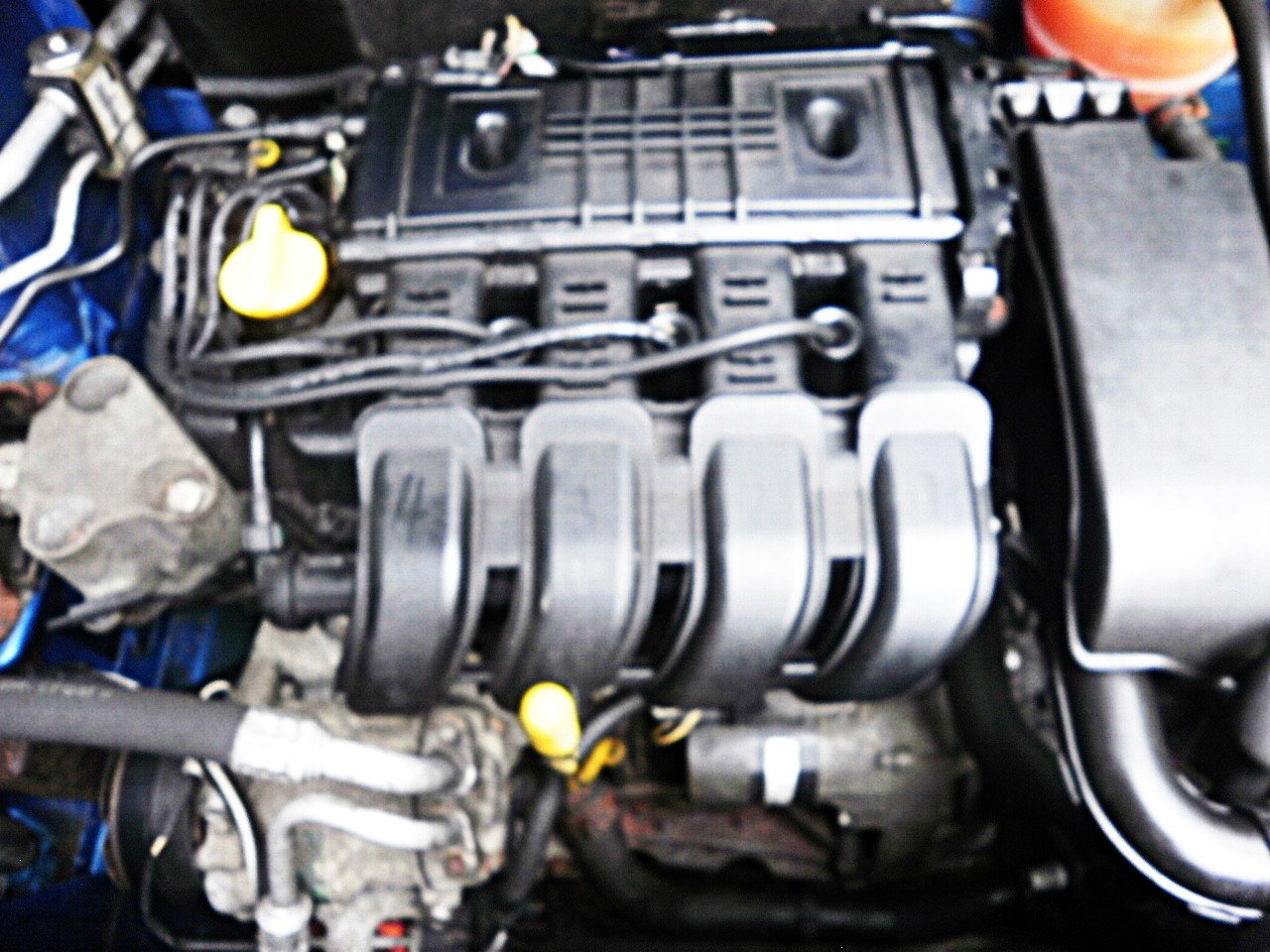

Very grateful for your input Matt. The Inlet Manifold is a bit of a cumbersome beast in the finest plastic, sitting on top of the engine snaking over from back to front with its four "arms" before the fuel rail and 4 injectors mount into it at the front. Plenty of scope for a bit of leakage at its gaskets.MattBLancs wrote: 06 Mar 2026, 07:10 Hi Neil! Sorry to be clear, I thought your description was good, nice and clear how it's (mis)behaving.
Only intending to give a bit of "thinking aloud" on the theories posted![]()
On MAP sensor, think they can get a bit gummy too (depending on how near they are to the PCV connection I guess??) so might be worth putting that on the Give It A Clean suggestions list.
I'd not bother cleaning entire inlet manifold, just the throttle body bit.

Crikey, that photo is verging on an AI nonsense nightmare creation.

The throttle body is underneath all that plastic as shown in this vid which I have started at the point where the Inlet manifold is lifted off to reveal the throttle body!

Oh wow, wasn't expecting that! How odd!NewcastleFalcon wrote: 06 Mar 2026, 11:18 The throttle body is underneath all that plastic as shown in this vid which I have started at the point where the Inlet manifold is lifted off to reveal the throttle body!
Is the air filter under that big assembly (inlet manifold off for a filter change!? Surely not) or is that throttle body pulling from a large plenum and the air filter is elsewhere?
In any case, agree there looks to be lots of potential leak paths there

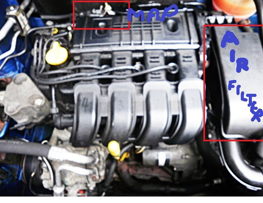

Air filter and MAP sensor as indicated in this photo.MattBLancs wrote: 06 Mar 2026, 16:37 Oh wow, wasn't expecting that! How odd!
In any case, agree there looks to be lots of potential leak paths there![]()
Another odd Renault thing the Renault 1.2 16V D4f engine doesn't have a PCV valve as such. The oil breather is actually part of the rocker cover,
and discharges into the air filter housing according to the Renault Forums https://www.renaultforums.co.uk/threads ... se.114424/

I think a new MAP sensor at £14 is an intervention worth doing as mentioned by Ryan. Here's a vid of a bloke testing his MAP on my very engine with a multimeter and a safety pin. The MAP sensor is very poorly mechanically connected to the top of the air intake. It is a push fit into a hole, it has an O-ring but there is no bolting down to prevent it moving, and is is retained only by that push fit and the o-ring.
Mostly for my own reference...Renault in their wisdom entombed the ECU in an anti-theft, anti-tamper loosely fitting metal enclosure. In Clio's this is notorious for jiggling up and down on the vital wiring loom as it enters the main ECU connector, often damaging the bundle of thin wires going to the main ECU connector. That turned out to be the particular problem fixed in the video. Probably my rudimentary code reader, but I have never had the P0105 DTC , nor any other MAP related or otherwise. The only DTC's are P0130/P0170 thrown out by the Pre-Cat O2 Sensor.
Today's little Italian tune up was done without the air filter for no particular logical reason other than to maximise the flow of air into the intake and see how that affected the stuttering. I would say it improved things marginally. It didn't throw up an EML at any stage, but at no time was there one of those serious stuttering episodes, although there was some discernible hesitation at times, but maybe not severe enough to throw up the light or the P0130 code.
