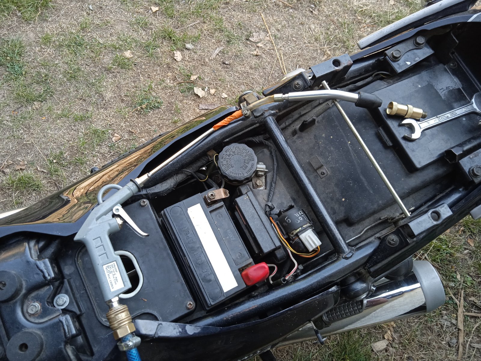

Not so long ago I did one on my Zeph11 when I noticed a cool downpipe. (That's another test to perform actually with in infrared temp gun on each downpipe.) I been having a pop on cyl 2 after after stripping the carbs 3 times, which is quite a job, I measured the temps. No.2 was a lot cooler the the other 3. Did a compression test and it was a lot lower. Didn't do a leakdown test properly, as in 2 guages to see jow much each cylinder loses over a given time period, more like get No. 2 to TDC and inject compressed air into the sparkplug hol using an improvised tool and listen to where it was coming out. carb, exhaust or oil filler. Twas exhaust. Had to go down 6 shim sizes to get into perfect condition. Goes like the clappers now......well it would really, it's gained 1/2 a cylinder.
