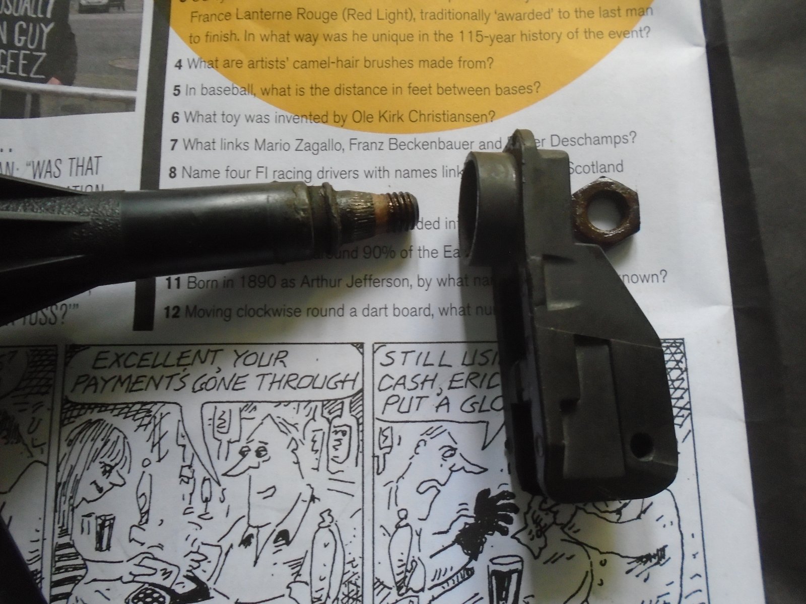

Spent a good hour and a half (nicely under cover and a concrete floor!) at my go to scrapyard attempting to get a rear wiper arm off a Corsa.NewcastleFalcon wrote: 02 Oct 2018, 15:22
I refer to my previous post.......I can confirm first hand it works![]()
Here's the evidence
Its a one nut job, then all you have to do is wiggle the arm off the splines. All techniques failed and I eventually hacksawed off the motor shaft to get it out, and hopefully "bench dismantle" later. It was rock solid on.
Maybe on this occasion a proper puller tool may have worked, but in general the outer bit is plastic, middle bit where the splines go metal, and the type of force even applied in a gradual manner with a puller could well have broken the plastic anyway.

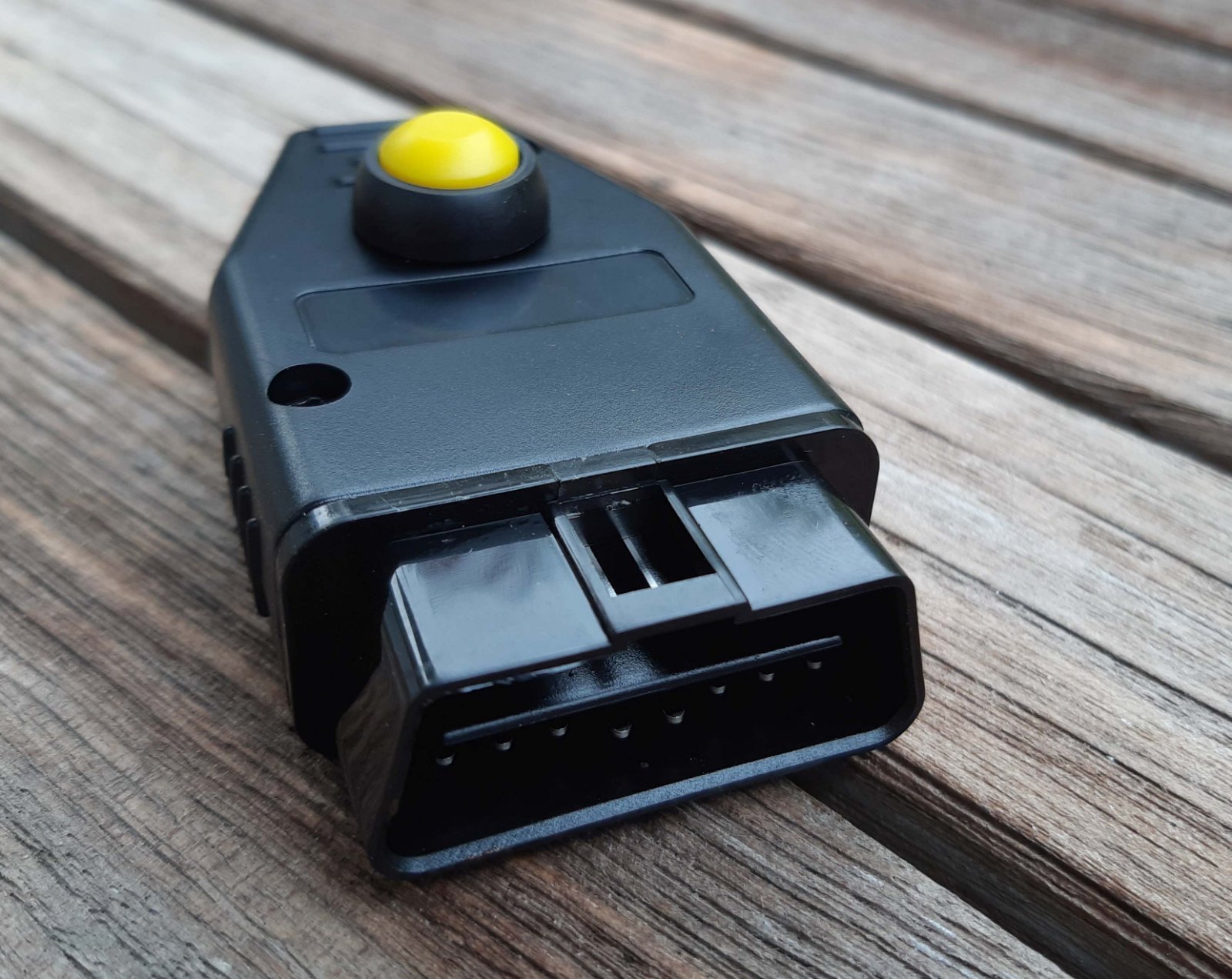

An OBD plug with a button on it ! Hi-tech stuff
Why have you put a yellow button on an OBD plug ? I hear no one ask.......
Ford Rangers and Mazda BT-50 of a certain vintage should have their MAF sensors put into a learning cycle at each service.... though it's often forgotten about
You can no doubt use the 'MAF learn' function on your very flashy OBD diagnostics kit...... or you can spend £5.46 on a button and an OBD plug and then wire pin 8 and one of the earth pins through the button. Once the engine is up to temp, press the button 5 times within 5 seconds and the truck goes into its 'learn' function and procedes to do two cycles of revving up to various RPM. Hey-garlic, basil and pine nut dressing - a bargain basement piece of hi-tech electronics. Or not.

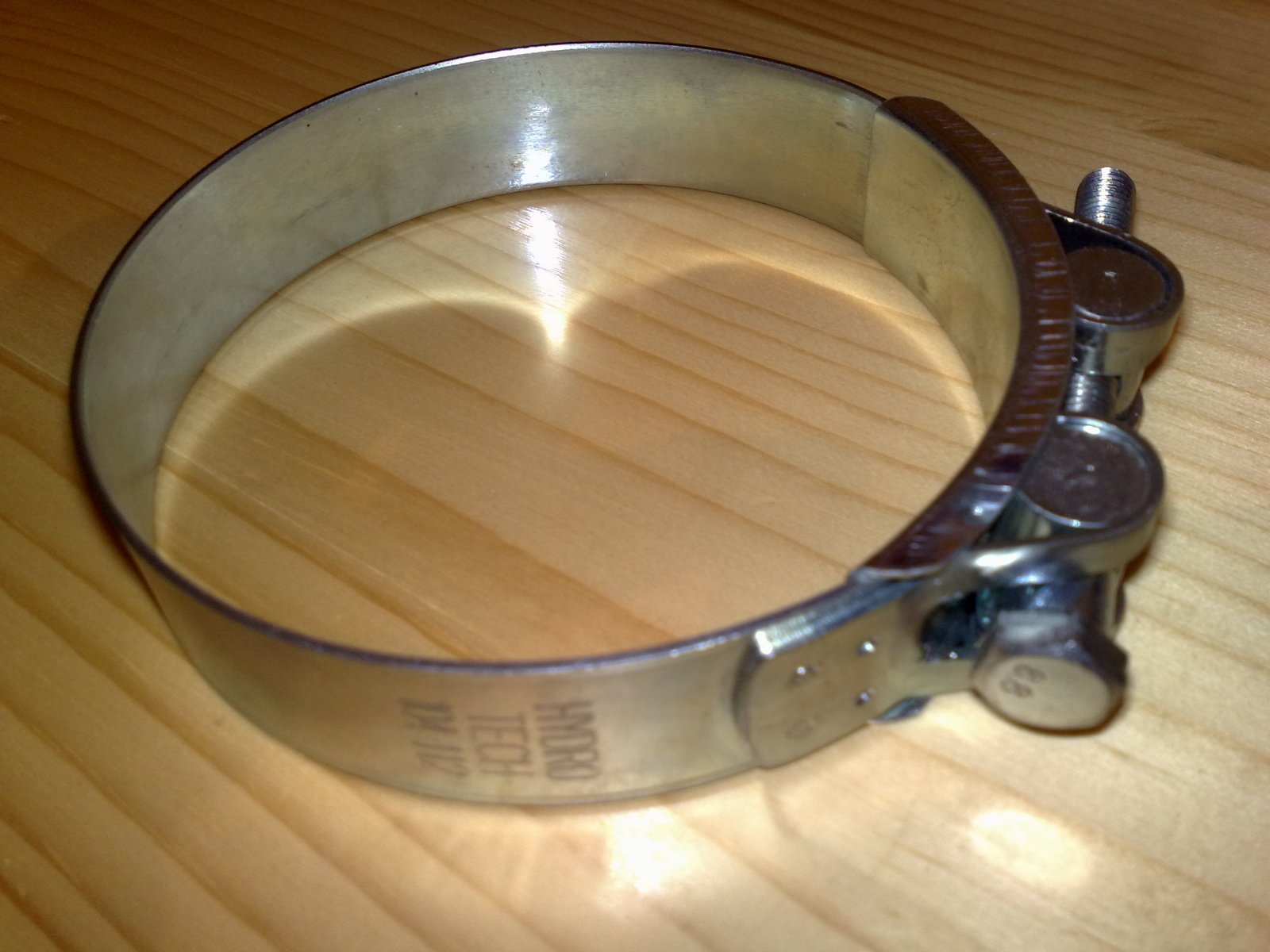

Eh, far from perfect
Hope it will work

Re: Toolbag Tales-Homemade and improvised tools
I'm sure it will. I made a similar one from motorbike chain for removing Citroen spheres and its had a fair bit of use, probably 20-30 years, so much so that the chain was beginning to become smooth and not gripping well.
I've used this with great succsess, when had to remove the front spheres.
The friction forces are enough for the job.
Just weak taps over the bolt's head, while counteracting with your spare hand, for the initial unscrewing.
You can put also a big flat screwdriver between the head and the clamp and make a leverage - just like Archimedes

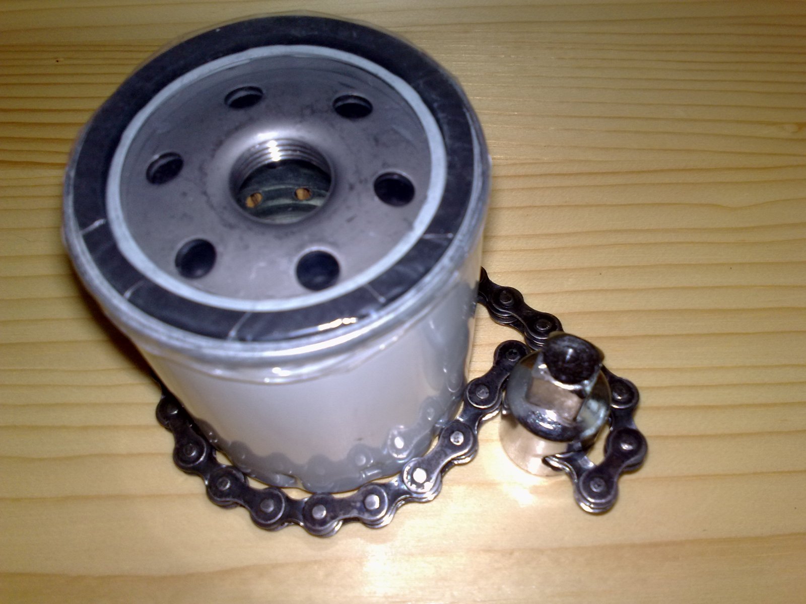

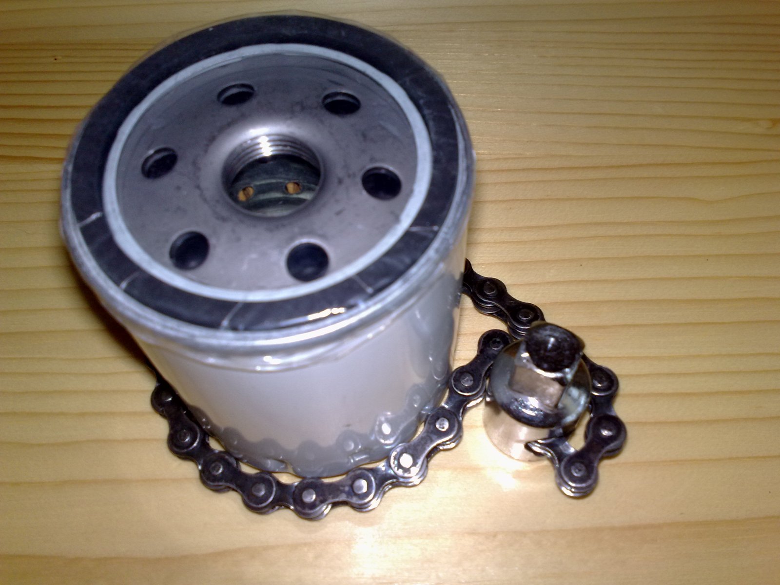

The improvized oil filter removal tool (for Xantiae
) is from worn bicycle chain and spare hex bits T-adapter.
Only 3 rollers fall into engagement with this particular filter, so its efficiency is under suspicion
