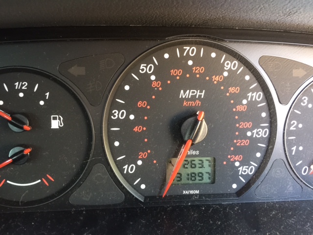

Trainman
- (Donor 2018)
- Posts: 2593
- Joined: 21 Aug 2009, 11:58
- x 43
Re: It's been a while (C5 Adventure)
following on from Gibbo's point yesterday, the pointer is here:
which does lead me to believe the pointer is out, now for the strip down..............
Steve
http://c6owners.org/index.php
Mandrake
- Posts: 8692
- Joined: 10 Apr 2005, 17:23
- x 694
Definitely looks out!
But where should it be aligned ? On the first dot ? It's not always obvious on some speedos where the 0 position should be...
Does anyone have the same style speedo on their C5 who could post a picture of it sitting in the rest position ?
Simon
1997 Xantia S1 2.0i Auto VSX
1978 CX 2400
1977 G Special 1129cc LHD
1978 CX 2400
- Posts: 12471
- x 1441
See this one: E-bay C5
Fourth pic shows the dash, and if you zoom in you can see it's pointing at the dot below 10.
- x 2943
I've just checked mine and the pointer is sitting precisely on the round dot, the handbook pictures also show it in the same place.
