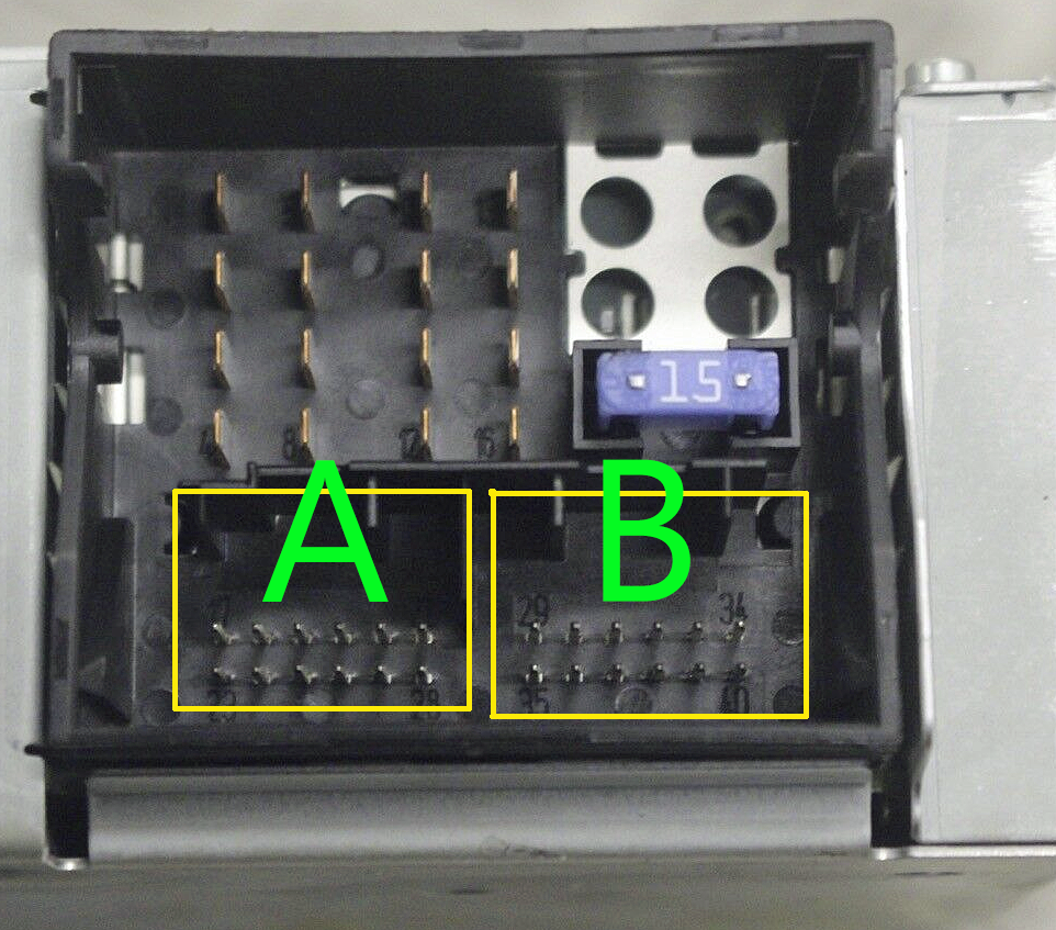

Hi I'm new to this forum and have had the same issues with the rebooting head unit to the point where it eventually factory resets itself.
After reading this I was hoping that by removing the Sd card it may have cured the problem but sadly it did not.
However I have now removed the 2 x smaller square multi plugs that plug into the big multi plug and so far after 3 days it has not rebooted.
I read somewhere that the economy mode could cause the problem and that this is controlled by the main ecu?
The problem is not with the head unit as I purchased one from ebay which rebooted also. The seller kindly sent me a 2nd one to try which also rebooted.
So now I'm back to my original unit, the aux connection and the Bluetooth is no longer working since I disconnected these 2 plugs but at least (hopefully) I'm narrowing down the actual issue, any feed back greatly appreciated. Cheers

Hi and welcome.
Can you confirm you have removed 'A' & 'B'?

Hi Marc yes that's correct

Can you pop your VIN up for me here (it will automatically be masked from public view), so I can check out exact specs of your X7.
A lot of these failures can stem from a faulty internal flash drive, but also from a corrupt SD card. Try taking the SD card out and rebooting the system once you have connected everything back up - but a warning - always unplug the Quadlock connector first and attach it back last - as this can brick the system if you unplug other connectors like the screen interface whilst it is powered...
