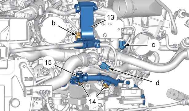

I can confirm that the work-around by adding an external resistor seems to work. I had a rummage through the junk box and found a 47 Ohm 10 Watt resistor (probably salvaged from on old black and white TV about 40 years ago). I put some flying leads onto it, and connected it in place of the heater on the thermostat, and the A/C is now working reliably again. I will still fit the new thermostat assembly when it arrives, but that could be a couple of weeks away.
For anyone needing this in the future, the heater connector is item 'd' in the diagram below:
