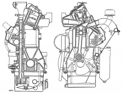

I do wonder how far you could actually tune one of these engines. Probably a lot further than many people would think. Especially as the clever head design means that a lot of the usual headaches of the typical IoE layout are overcome and you do actually have a pretty compact and optimally shaped combustion chamber (albeit upside down to how it's shaped on most modern engines). Even in stock form this was producing 123bhp and a good old slab of torque (I can't find the number right now) and feels far more responsive than the engines in a lot of cars from this era in the way it delivers that.
It's also an excuse to pull out this cross section of the engine, which I always enjoy seeing.

Wow, think definitely dodging bullets with all the coolant system work you are doing!
Thanks for the cutaways, the IOE arrangement is very odd indeed! Am sure I have read of Land Rover folks being able to double the power output of the related four cylinder Rover engine.

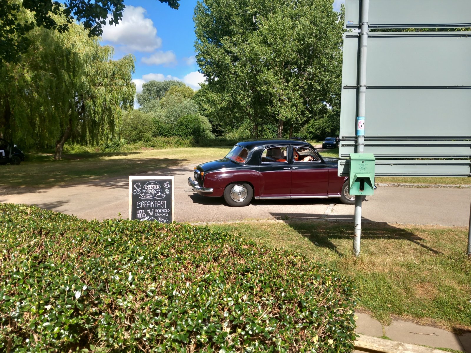

Spotted in Emberton Park this afternoon Zel...
Looked almost as tidy as yours...
Apologies it's not a great photo, best I could manage from the cafe area...

CitroJim wrote: 29 Jun 2025, 17:44 Spotted in Emberton Park this afternoon Zel...
Pretty sure I've seen that one at a couple of shows. The black over maroon is a nice colour for them. A good deal tidier than mine if you look closer! This one is always going to be at best I'd say a 7/10, that's my target anyway. I'd not really want to go further than that anyway as I'd worry about using the car then, and I've no intention of this being a show queen.

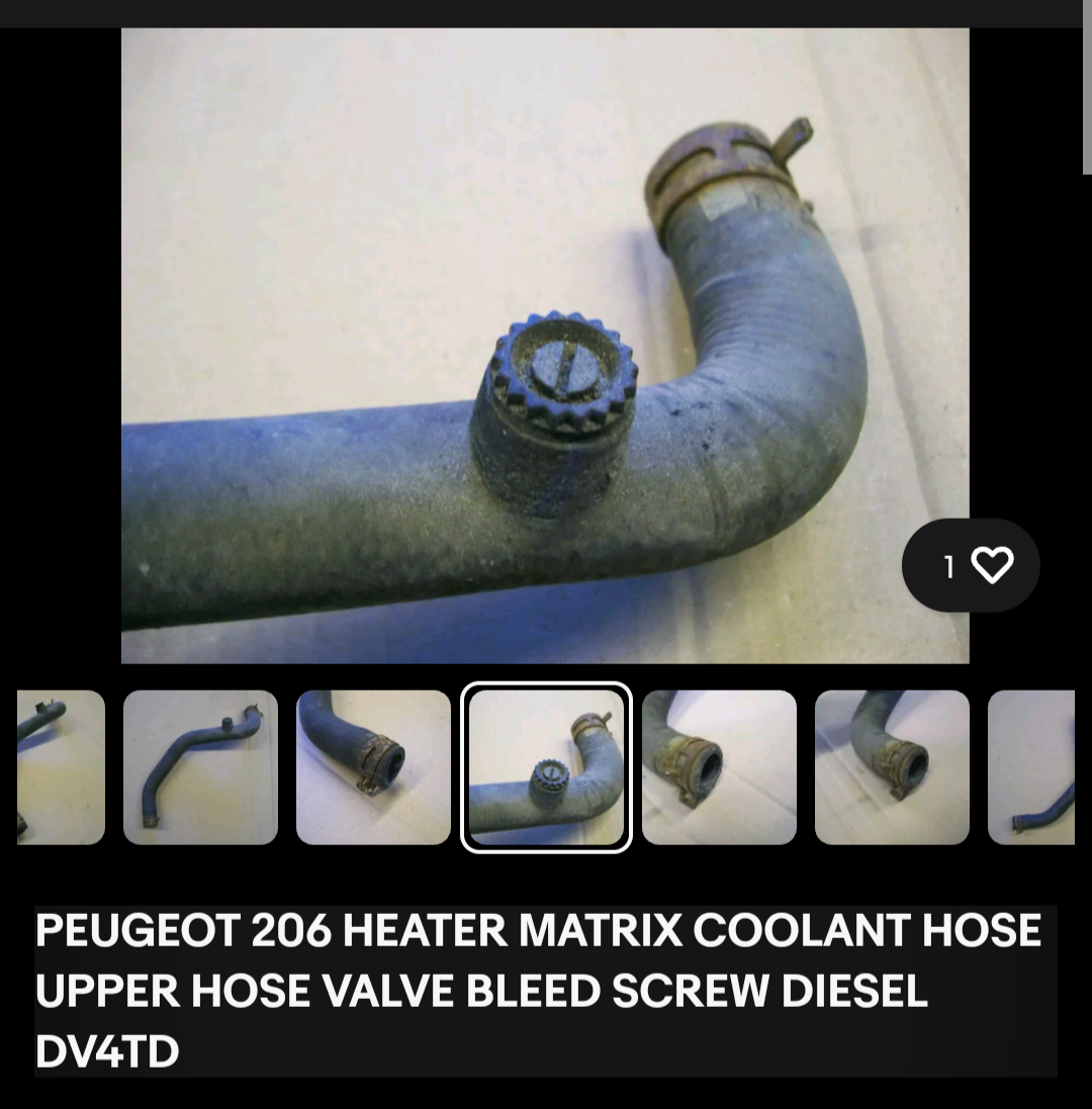

With regards to the lack of bleed points, I was going to suggest drilling and tapping your new thermostat outlet but realised it is both lower than the hose and radiator header tank and secondly wouldn't bleed much with a "shut" thermostat beneath it!
Could you create a flat and add a point here:
Appended image with crude arrow
The Peugeot/ Citroen bleed screws would be a simple addition if there's room
M6 bleed screw
M6 bleed screw

The usual bleed location is the heater inlet. You basically just let air and water dribble out there until you haven't got any air coming out. I think that works far better though when the whole circuit works and you have actual flow through the heater. It's the only area that's substantially higher than the rest of the system as well. Rest of it in theory should be simple enough that it will just burp itself pretty quickly.

Interesting, given you've the heater to tackle at some point, assuming the heater hoses are a similar size, perhaps this type would be worth grafting in somewhere on that route:
Just an example, from eBay, 206 heater hose with bleed connection.
(Not a great example, thirty quid for that fairly tired looking hose!)

MattBLancs wrote: Yesterday, 20:59 Interesting, given you've the heater to tackle at some point, assuming the heater hoses are a similar size, perhaps this type would be worth grafting in somewhere on that route:
https://ebay.us/m/78zIDq
Not a bad idea that. Though I'd not be looking at an old one of that type, I had one of those snap off on a 306 many a year ago...though I imagine there are plenty of other options of the same sort of style.
