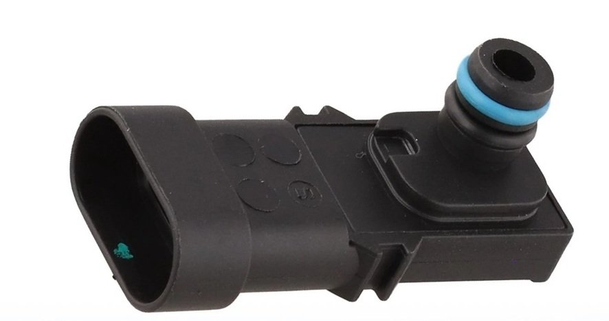

This is it, not that expensive and maybe on the "try this" list.
It has a MAP sensor which sits on the top of the plastic Inlet Manifold and pokes into its appropriate hole. Not convinced it is securely mounted by design for such an important sensor. Indeed I even had a bit of masking tape clagging it down.bobins wrote: 05 Mar 2026, 20:36 Have you had a look at the MAF (MAP?) sensor, Neil, as that could cause those symptoms ? Does it need a good clean with an appropriate cleaner, or just a replacement ?
