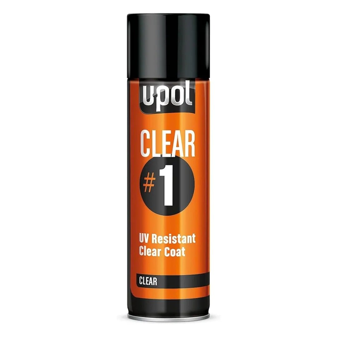

"Mostly" it is the "protective coating/clear coat" that is applied to the light cover/lens that has reached its life-end. This needs to be polished off then another clear coating of a suitable UV resistance applied.
IF this UV resistant top coat is not reapplied then the pressure formed plastic lens will start to micro-crack as the material will start to fail (polymer cross linking starts to fracture under UV attack)
https://morelli.co.uk/products/clear-1- ... clear-coat
- Posts: 9048
- x 1883
Re: DIY Car Maintenance with function over finesse!!
Flip, they're not shy with the price, are they?
