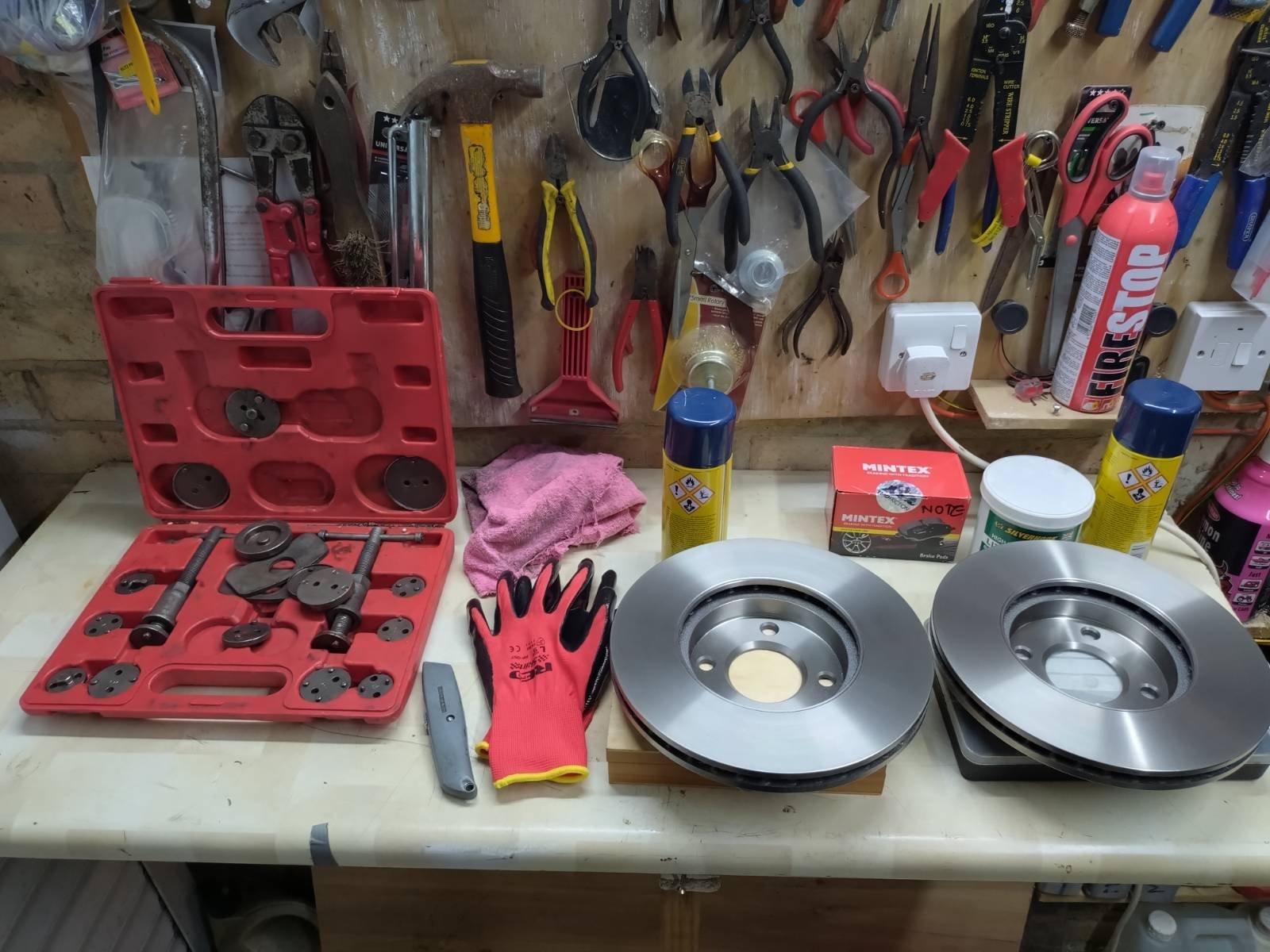

Today's job is on the maintenance fleet, front discs and pads on a Nissan Note. My friend is late so I decided to lay out and prep the parts and tools to save time once I get started. Probably not bother with further pics as everyone knows what will be involved!!

I forgot to report job done on the Note as expected, the old discs were well and truly seized on the hubs but it is amazing how effective a high speed vibrator can be! In my case I simply put a bent drill bit in the drill, set it at high speed and lent the top of the shaft on the rim of the disc, 15-20 secs later a tap with the mallet and off they came! The rest of the job was exactly as you'd expect with no caliper pin issues or pad spring corrosion!!
