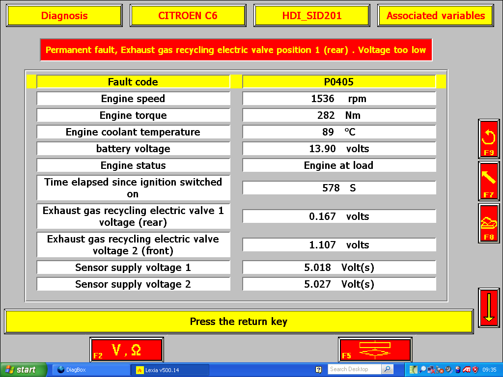

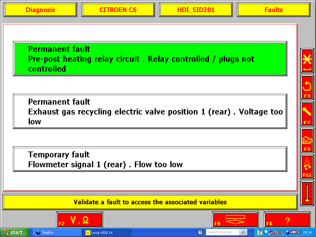

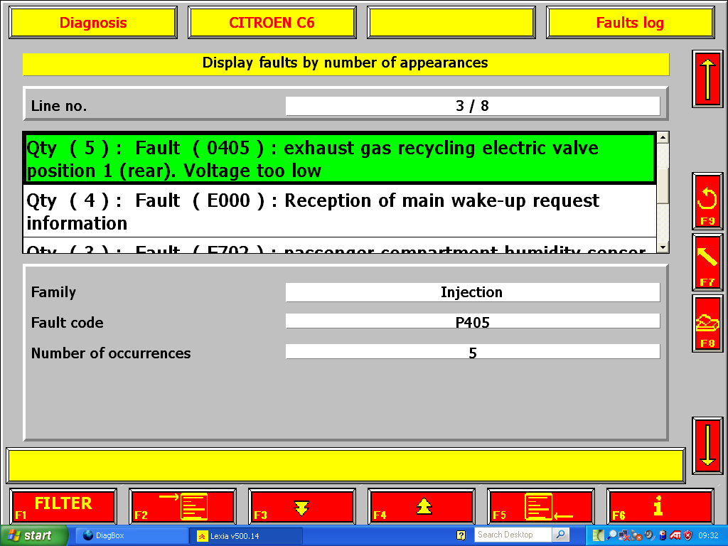

Managed to get the lexia on the car yesterday and took some screen shots.
So, it looks like the EGR is faulty, Getting the auto electrician to double to check it on friday and then go from there. The stupid thing is that the car is running like a dream, but the engine management light is on.

I've got he same trouble with my doblo 1.9jtd Steve with the Egr stuck shut and the EML on , it runs fantastic .

Well, confirmed as the rear EGR valve by the auto electrician, he's also indicated a rattling from the swirl valves.
Given that the price of the EGR valve is £221.92 + VAT
it's looking more and more like the blanking plugs are going to get done.
I just need to find out what's involved with the swirl valves before it get's done.
