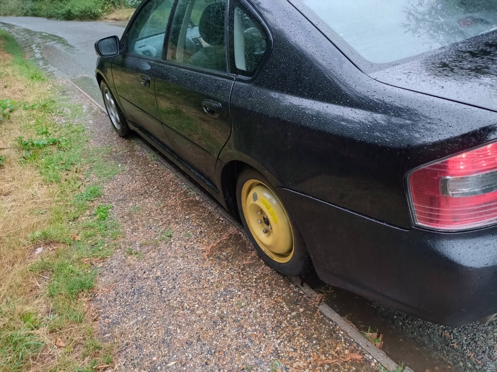

Well today's post was supposed to be a follow up on the MX3 temperature sensor but when I got up this morning it was pouring so I don't like taking the cover off when it's wet and hence decided to head to Radlett for breakfast. I parallel parked outside the cafe,nudging the kerb as I did so, and enjoyed a great brekkie. Left the cafe and couldn't believe it when just 150m down the road I felt the same wobble I had felt on the North Circular on Wednesday. I was driving up a narrow road with lines of cars both sides so I had to keep going 30m to find an entrance to a gated apartment complex which I happily parked across out of the line of trafic allowing normal use for all bar those residents. The 10 minutes I had taken on Wednesday was cut down to 7 minutes, spurred on by the rain, and then I dropped my friend off and headed back to my tyre man arriving like this:
Peter examined the tyre, which I thought I may have popped off when I caught the kerb, but no, for the second time in 4 days I had a conventional puncture with a large flint through the centre of the tread!! Peter immediately replaced the tyre and rebalanced the wheel for no charge, I gave him a tenner

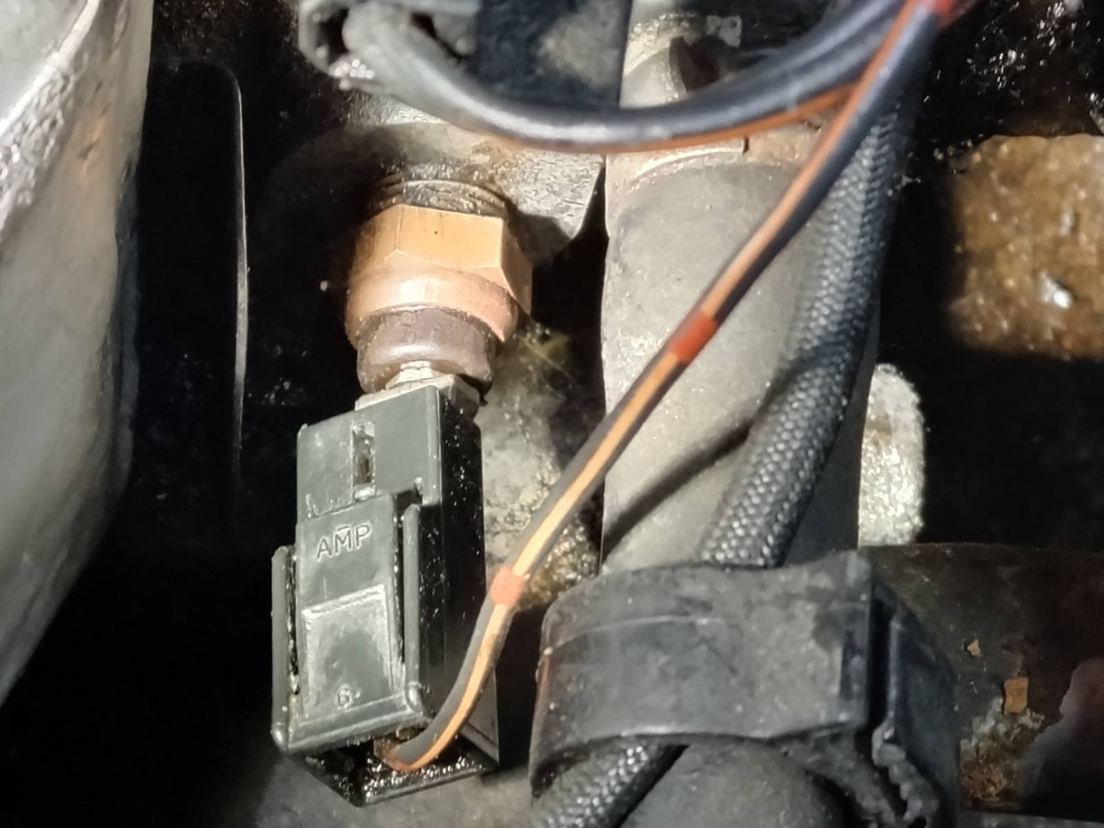

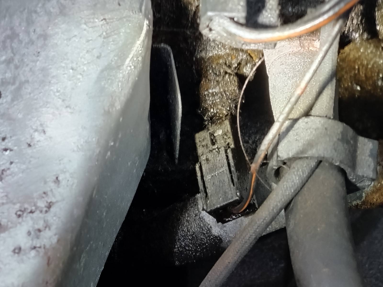

This morning in the break in the rain I decided to check out that theory. I put the car in the garage in case and opened the bonnet to examine the temperature sensor plug:mickthemaverick wrote: 19 Jul 2025, 12:44
So now back at home waiting to test my overnight theory that the temp guage issue in the MX3 is down to a build up of grime on the surface of the sensor which is the single wire type. Hence accumulated muck spanning the gap from block to spade terminal may be causing a partial shunt of the thermister. We'll see when it stops raining, but I've ordered a new sensor anyway!!![]()

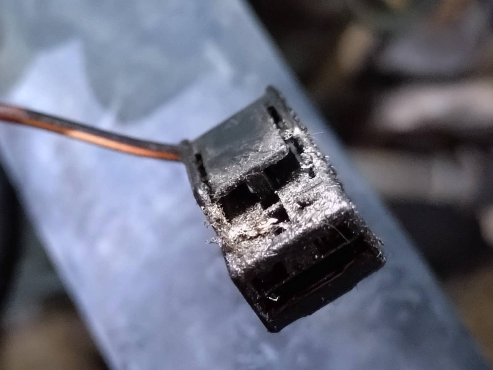

I then pulled the connector off and examined it:

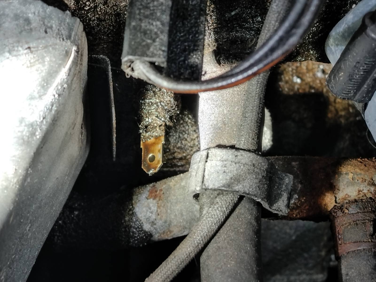

I looked at the sensor still in the block:
So I cleaned it all and reconnected it:
Having refitted the sensor I started the engine and let it run until the fan came on. I took the temperature readings as before and all was good! I got in the car and looked at the guage and it was just below red, theory destroyed!!
So the new sensor should be here in the next couple of days so for the next installment of this exciting story watch this space!!

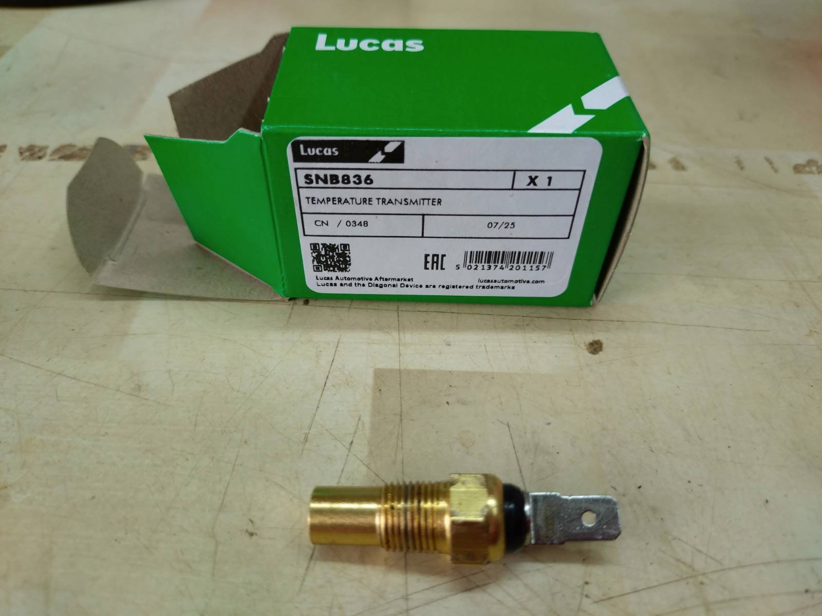

Well the new sensor arrived this morning:
so it was an opportune time to do the testing. The new sensor ranged from 760 ohms when cold to 120 ohms in a boiling pan. I swapped them over and tested the old sensor 1Kohm when cold down to 110 ohms in the pan. Hmmm!!
So I ran the engine up to 'fan on' temperature and watched the guage with the new sensor fitted, damn it!!! The needle stayed around normal but then began to intermittantly shoot off the scale and drop back to normal Grrrr! I double checked the wiring loom to be sure there was no intermittant earth and then connected the meter across the live sensor and sure enough it was giving intermittant full short circuit pulses Grrrrrrr!! I refitted the old sensor after a further clean and topped up and bled the system with my funnel method and it settled down to run for 45 minutes with the fan switching on and off and the guage representing that by climbing from the horizontal about 4 mins on a clock face to fan on and then dropping back to normal as the fan took effect. So maybe the problem was more ingrained muck in the sensor than I cleaned the first time but at the moment it all looks good!!

You fell victim to Joe Lucas the Prince of Darkness there Mick
Good that the problem now appears resolved with the old sensor. I guess you'll be wanting to exchange the iffy new one for a replacement that works properly, if only to hold as a spare...
