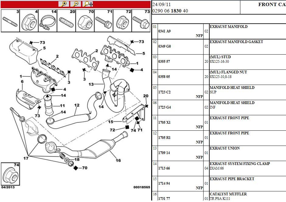

You are correct, the pipe is NFP from Citroen

Which of those pipes is the one with the hole?

12
I would take it to an exhaust specialists and get a section let into it or replaced with SS
Looks like its taken a battering

100 Euros for a new one
It does look a bit battered.

The front pipe is double-skinned at the point where it's looking crusty. They can respond well to a small weld repair...

Did not know it was doubled skinned, something new every day :), now I see in the drawing. Why would that be ?

Stickyfinger wrote:Did not know it was doubled skinned, something new every day :), now I see in the drawing. Why would that be ?
No idea at all....
